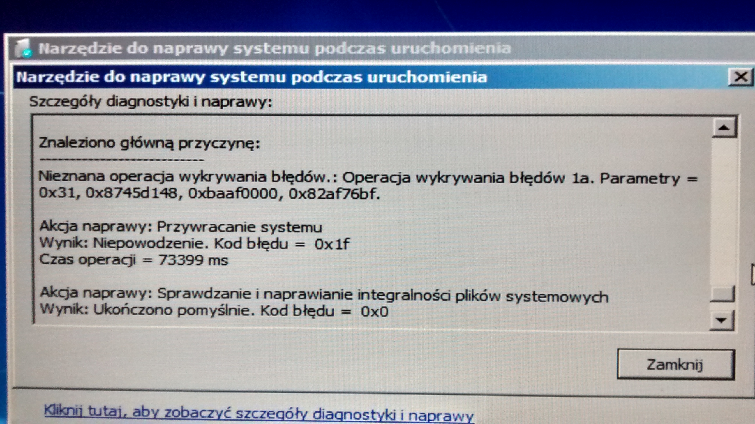

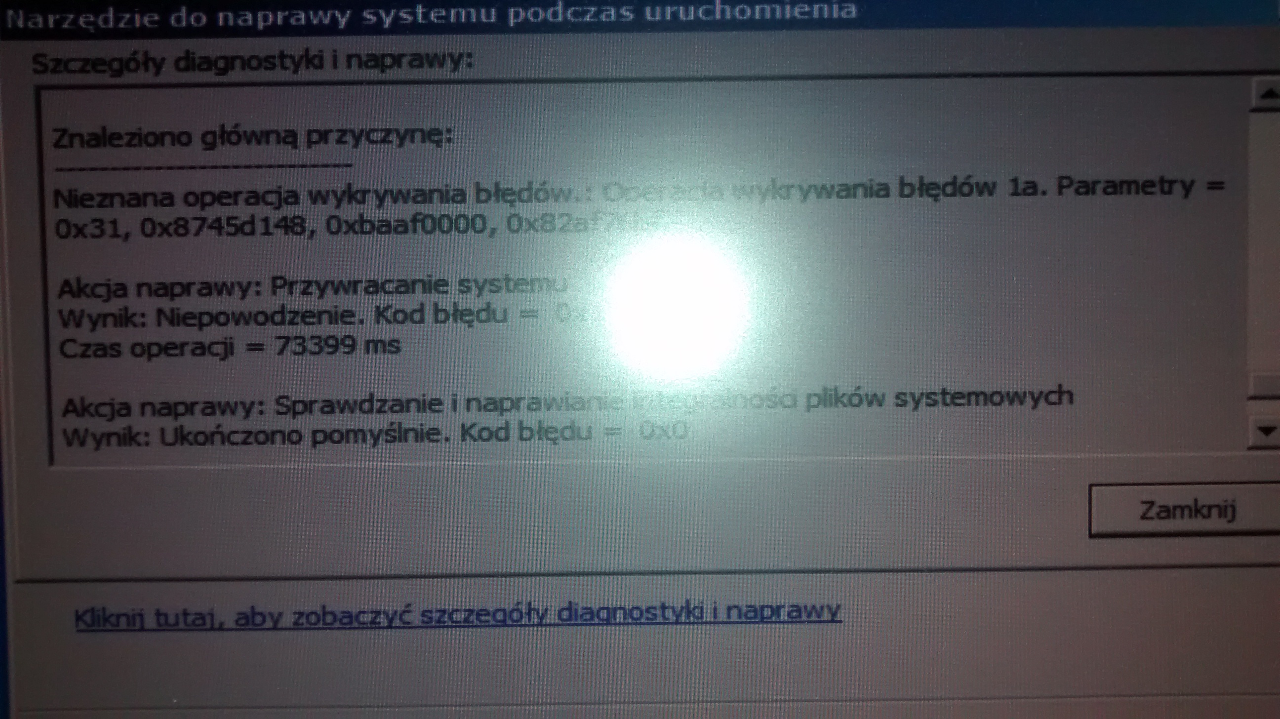

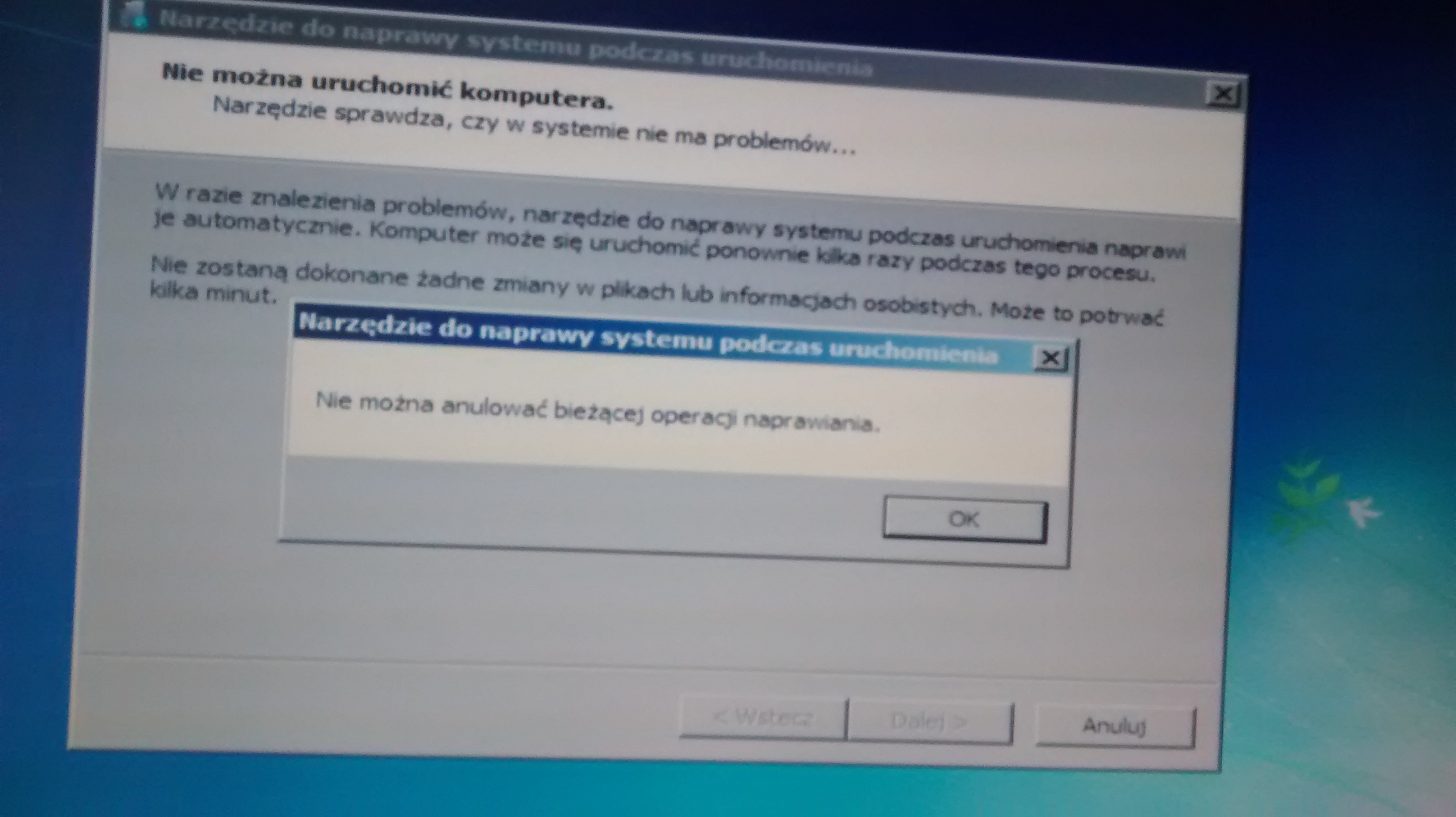

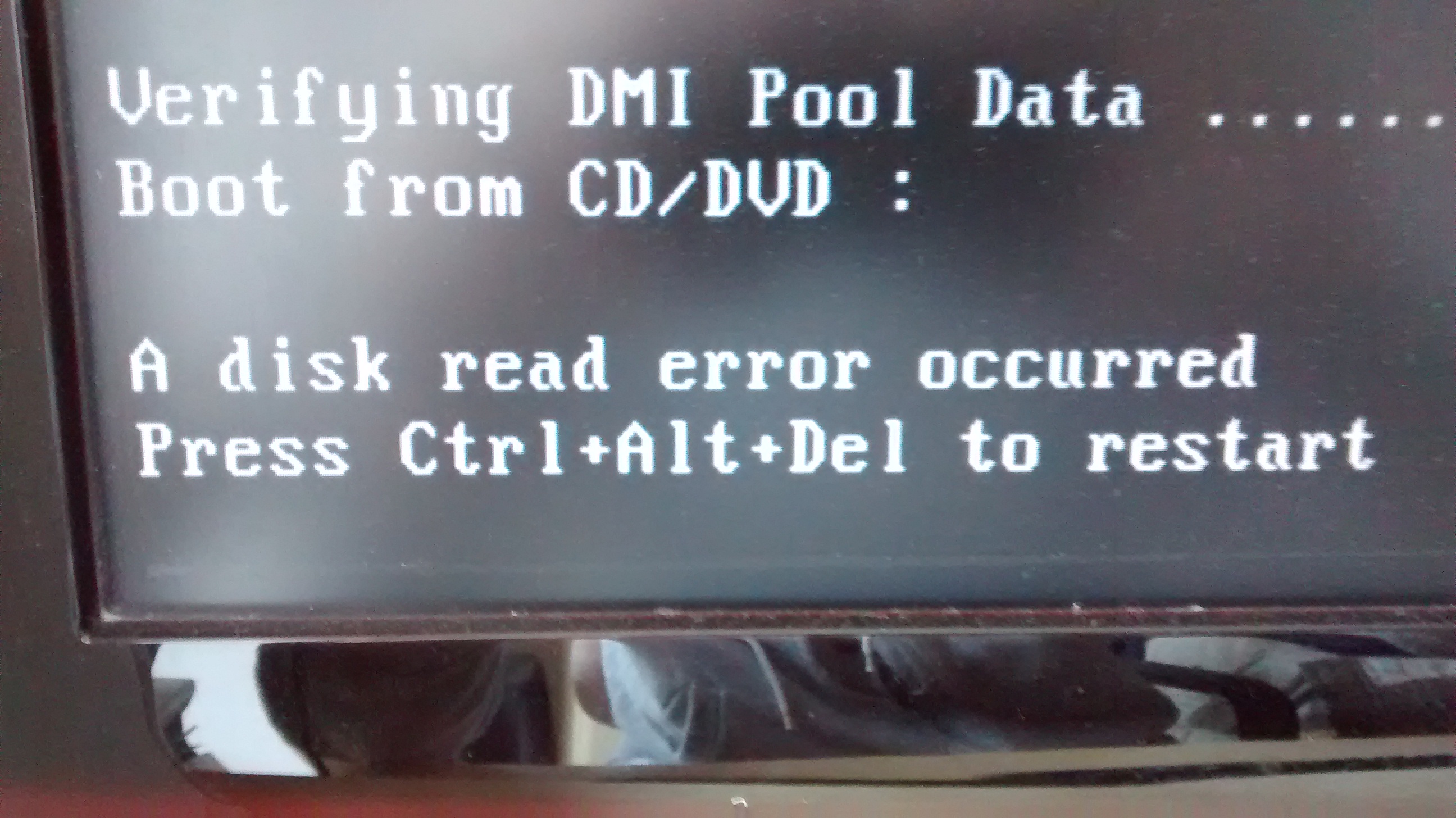

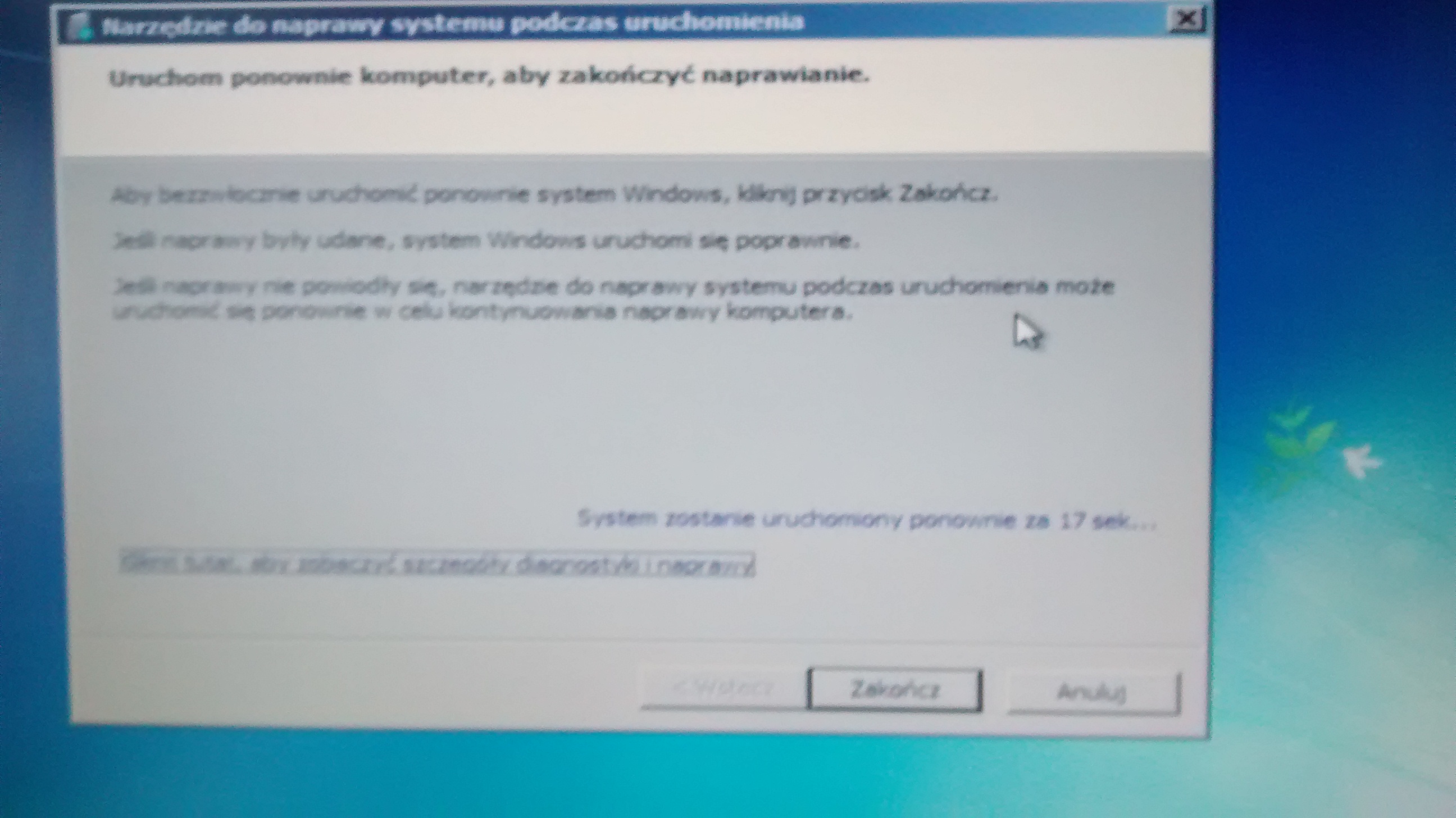

    Hello !
    I don't have this program, I just need to install it.
    But there is something else. There was also a message popping up white letters on a black background to check the connection of the disk or dvd or removable media. I do not have a picture of this message, but I have another where is system diagnostics. I didn't think it was but maybe I made a mistake. This however gets to be a problem on another thread.
    Photos in the attachment are not all clear, unfortunately.

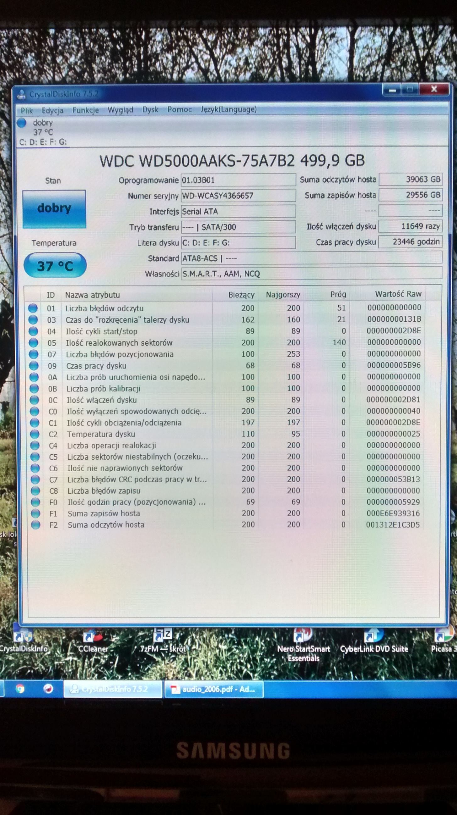

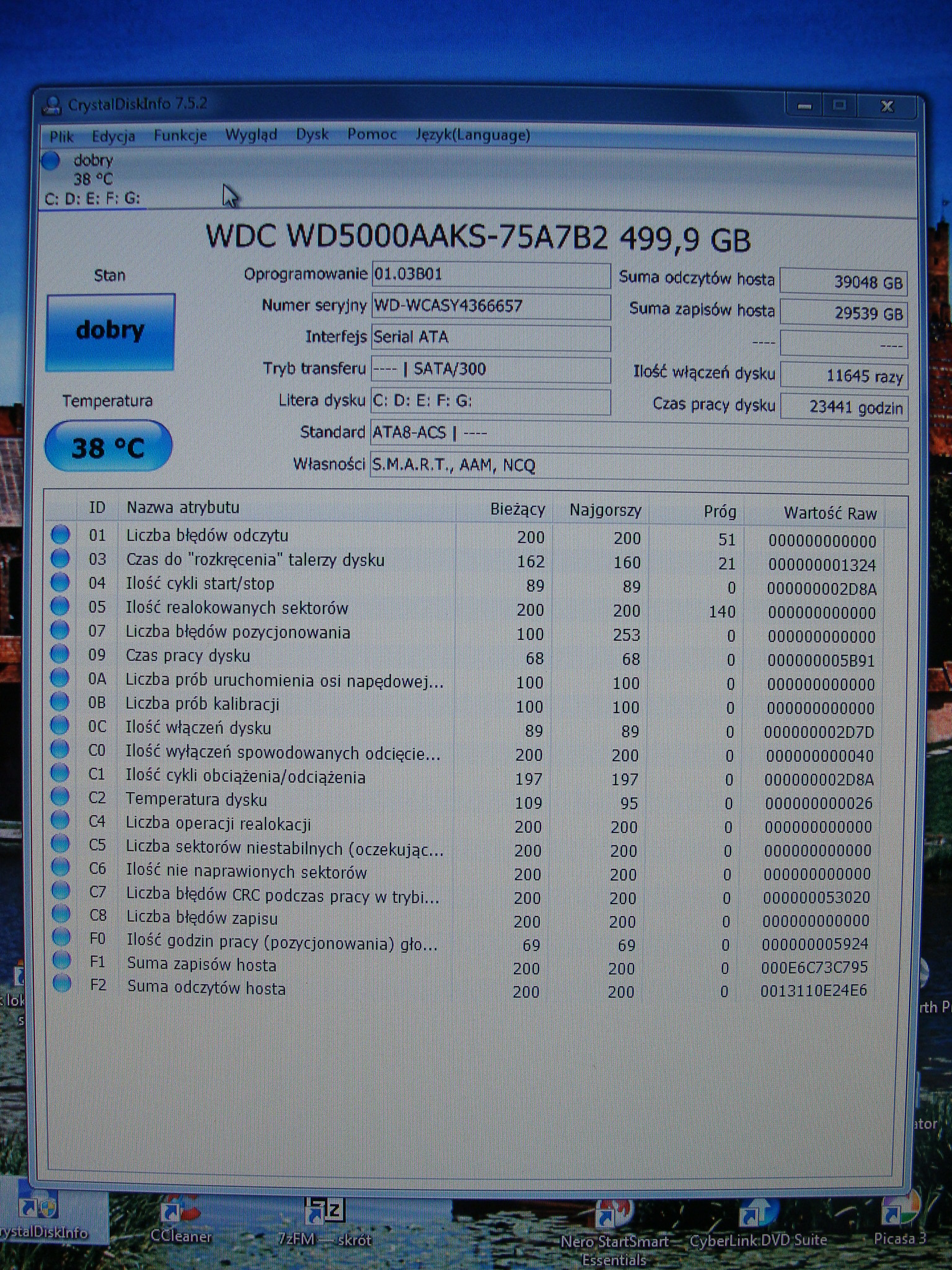

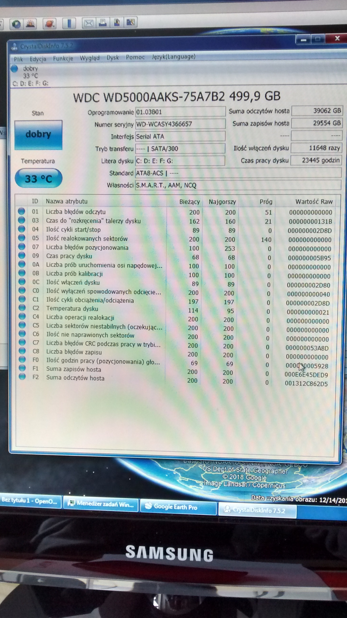

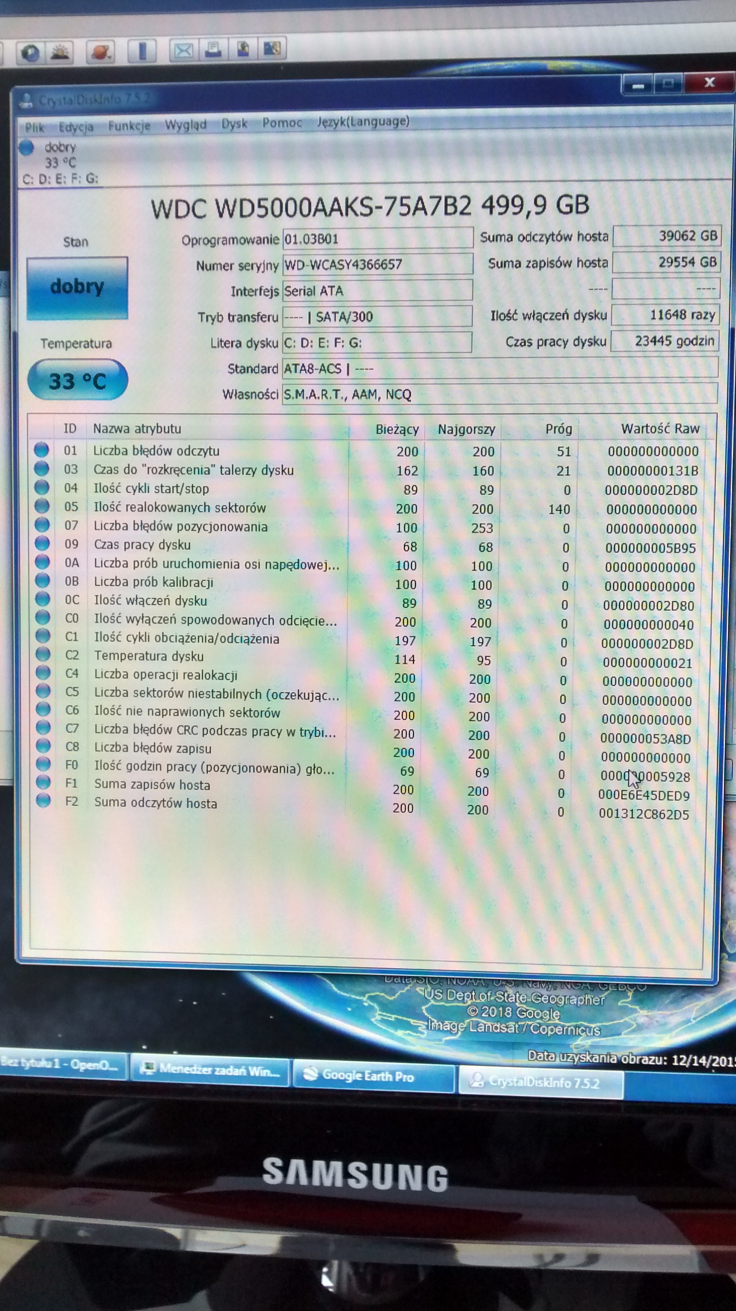

    One more thing - can this program be portable or better in the normal version?
    Added after 37 [minutes]:
    Image from CrystalDiskInfo.

  • #10 17051960
    dt1
    Admin of Computers group
    Posts: 48173
    Help: 7301
    Rate: 8261
    Disk status OK, but it's worth a look in a moment if the RAW value (last column) of the C7 parameter is not increasing. If it rises, check the cable connecting the drive and the motherboard, or replace it with another one. This parameter usually does not indicate any failure, but most often it is the incorrect connection between the disk and the board.

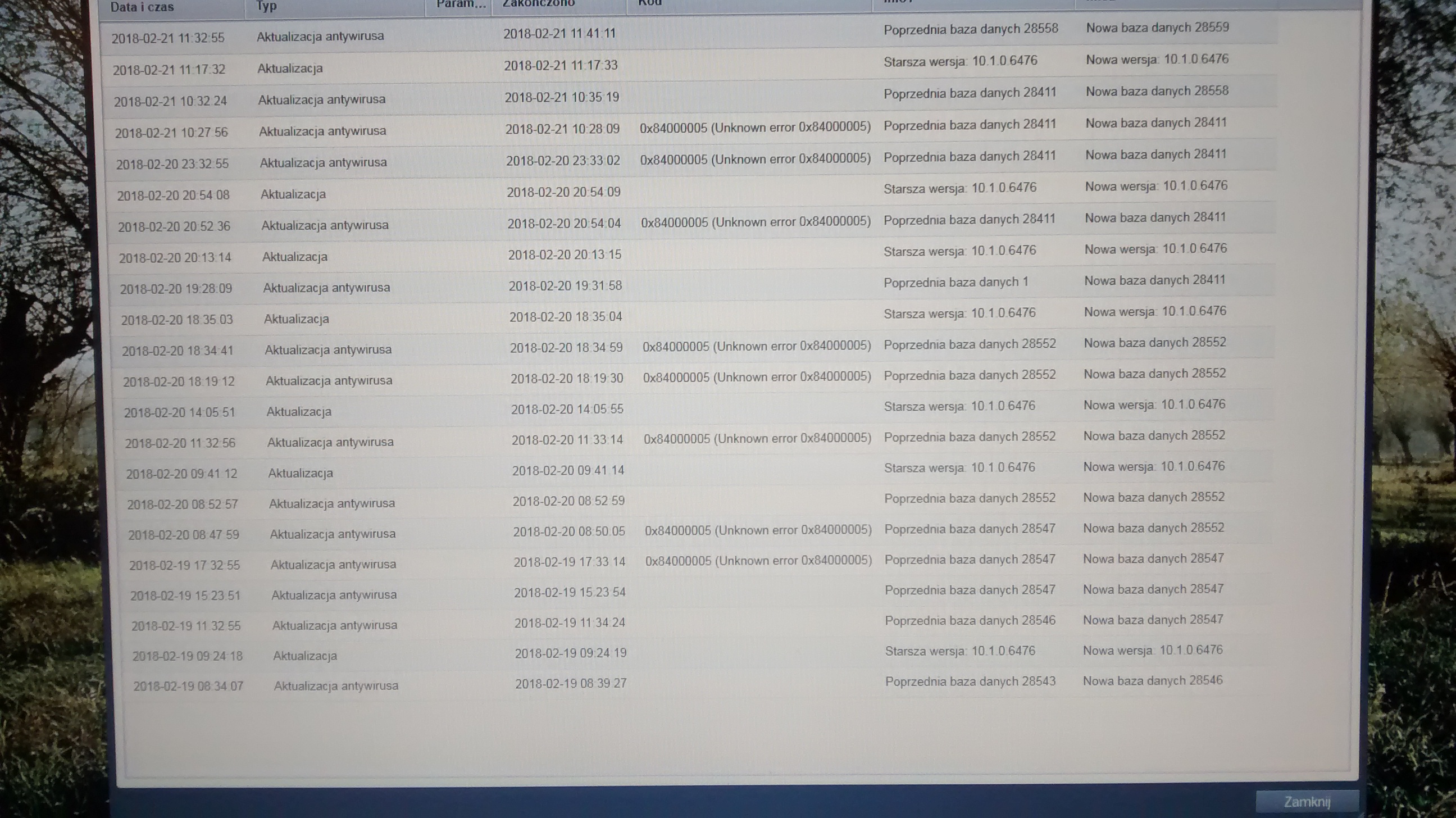

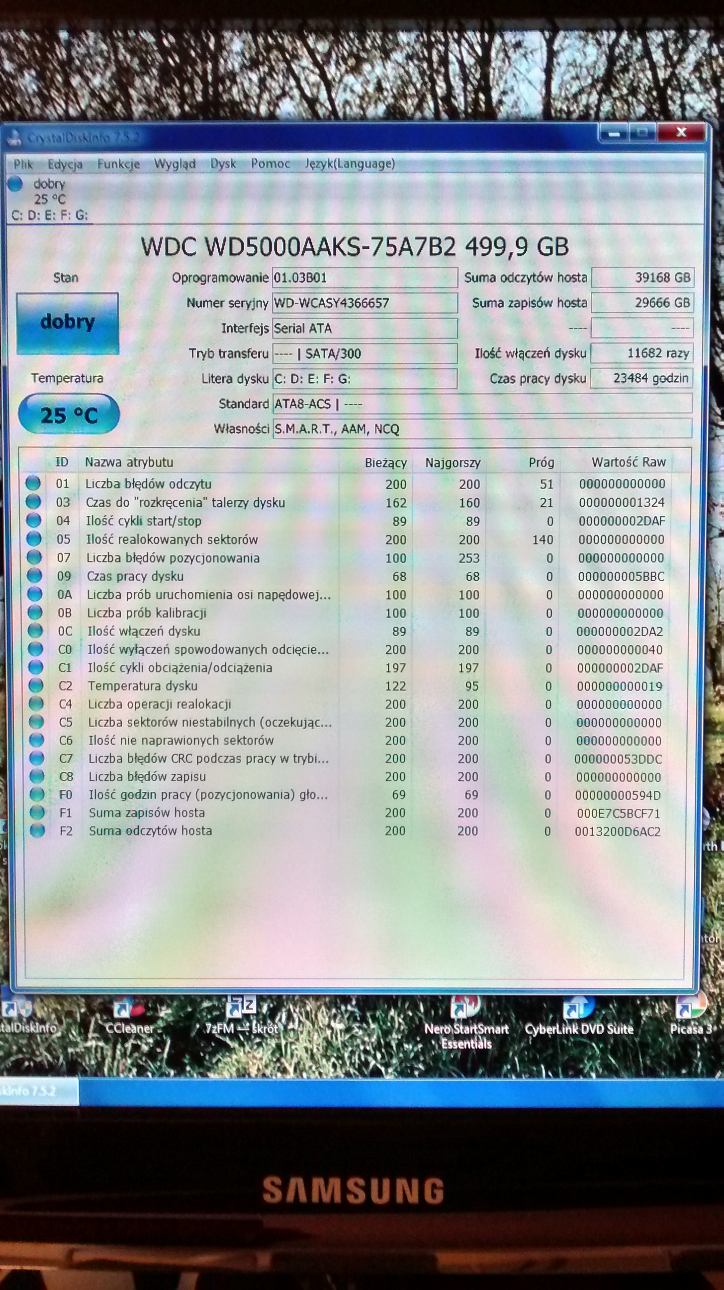

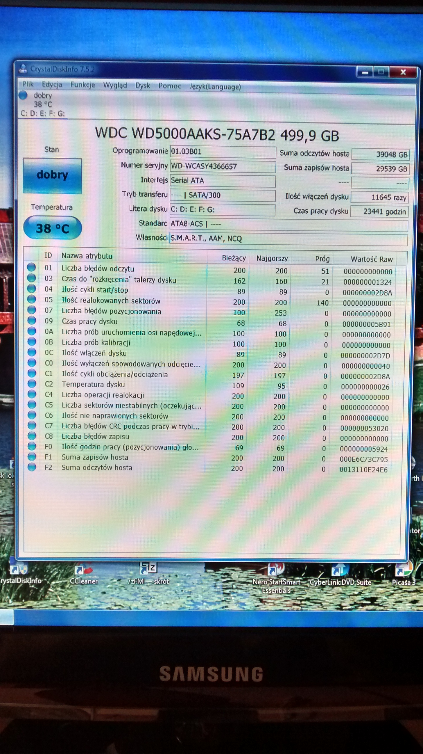

  • #11 17053485
    Morann
    Posts: 42
    Yesterday it did not increase and today it is different, as shown in the pictures.
    Comodo itself catches some errors, but it updates in total, yesterday, however, it behaved strange because it updated from database 1 to 28411 and previously had 28552 :?:
    I'm starting to be afraid of this program. What do you think about it?

  • #12 17054395
    dt1
    Posts: 48173
    Help: 7301
    Rate: 8261
    Comodo is probably not the problem, it is just feeling the effects of the actual problem. As I mentioned - if the parameter increases (and increases), dismantle and mount the tape connecting the disk and the board, and if that does not help, replace it and keep checking. The RAW value of C7 should not increase while the disk is running. Of course, the value stamped on the counter will not decrease either. If everything is correct, the RAW value will remain unchanged after some time.

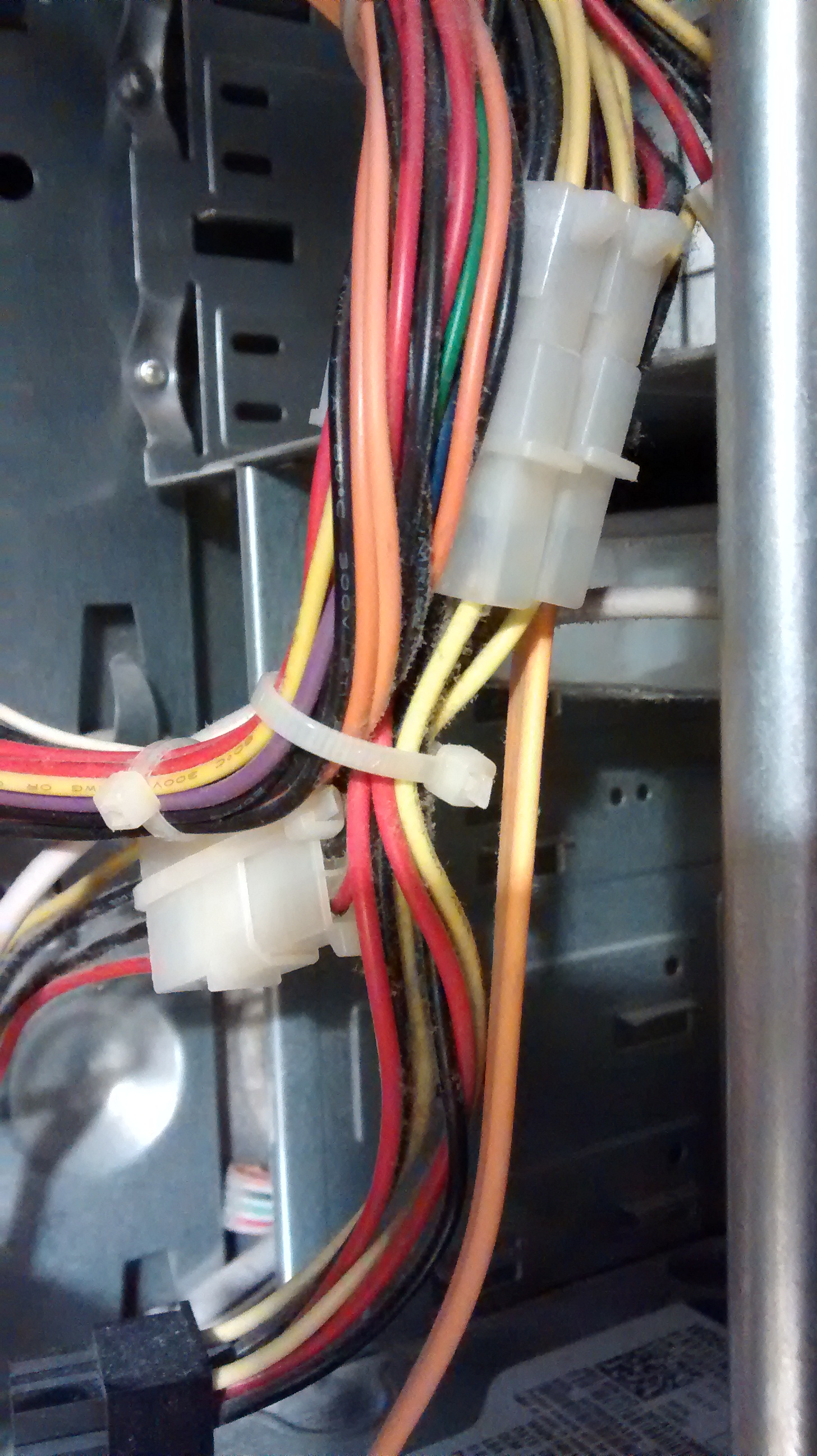

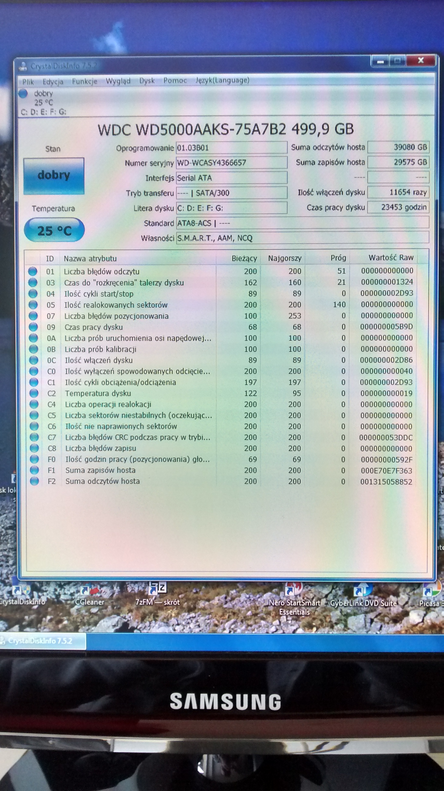

  • #13 17066659
    Morann
    Posts: 42
    I did as you advised. I checked the connections and it turned out that the plugs in one of the bundles, visible in the photo, seem to be the top one. They go to the DVD and to the disc. Since then, the RAW value of the C7 parameter has been constant - Fig. on 2/22 and 2/26 - and comodo updates without a problem and seems to be working normally :) Can the problem be considered solved then?
    It is true that the program tries to update itself every day, although it is set every 7 days (maybe it is about the act in critical situations?) And the database sometimes tries to update twice in a row, i.e. after the update, it checks the access again. base but I don't know if it's a problem? Is it possible that comodo or other programs did not install correctly as I installed them before fixing the problem?
    • Comodo Internet Security Premium 10.1.0.6476: Issues with Updating Virus Database & Uninstalling IMG_20180226_222450941_HDR.jpg (1.49 MB) You must be logged in to download this attachment.
    • Comodo Internet Security Premium 10.1.0.6476: Issues with Updating Virus Database & Uninstalling IMG_20180222_130436564_HDR.jpg (1.4 MB) You must be logged in to download this attachment.
    • Comodo Internet Security Premium 10.1.0.6476: Issues with Updating Virus Database & Uninstalling IMG_20180226_182311557.jpg (1.16 MB) You must be logged in to download this attachment.
  • #14 17066666
    dt1
    Posts: 48173
    Help: 7301
    Rate: 8261
    Incorrect connection could cause these problems, since they disappeared after correcting it probably could be the main reason.
    Unfortunately, I don't know Comodo's update mechanisms, but any sane antivirus program should check for updates to at least the virus database itself quite often. If he does, I probably wouldn't be worried.
