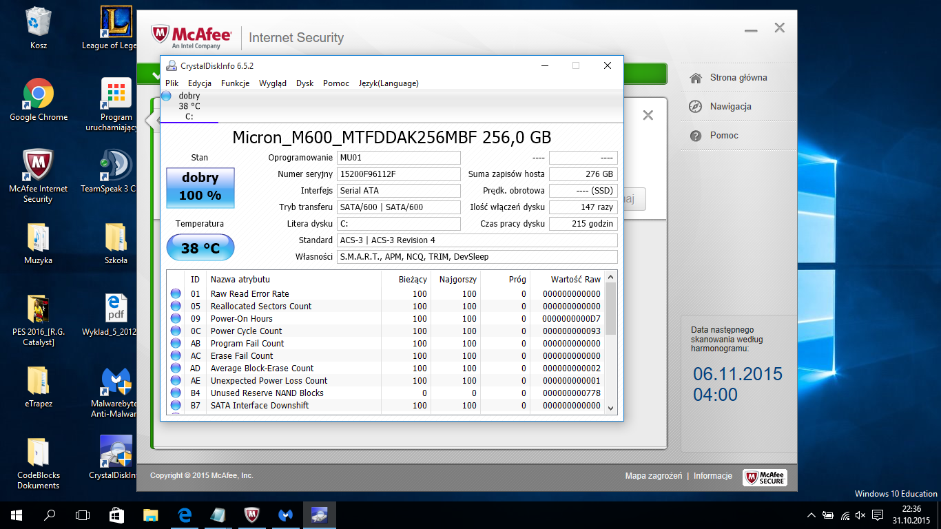

    Upload a screenshot from Crystal Disc Info. You need to make sure that the hard disk is not damaged.

    • Several Hour Reboot After McAfee Internet Security Installation - Safe to Interrupt? Bez__tytu__u.png (426.44 KB) You must be logged in to download this attachment.
  • #13 15116195
    kasiunia7777
    Posts: 4668
    Help: 420
    Rate: 244

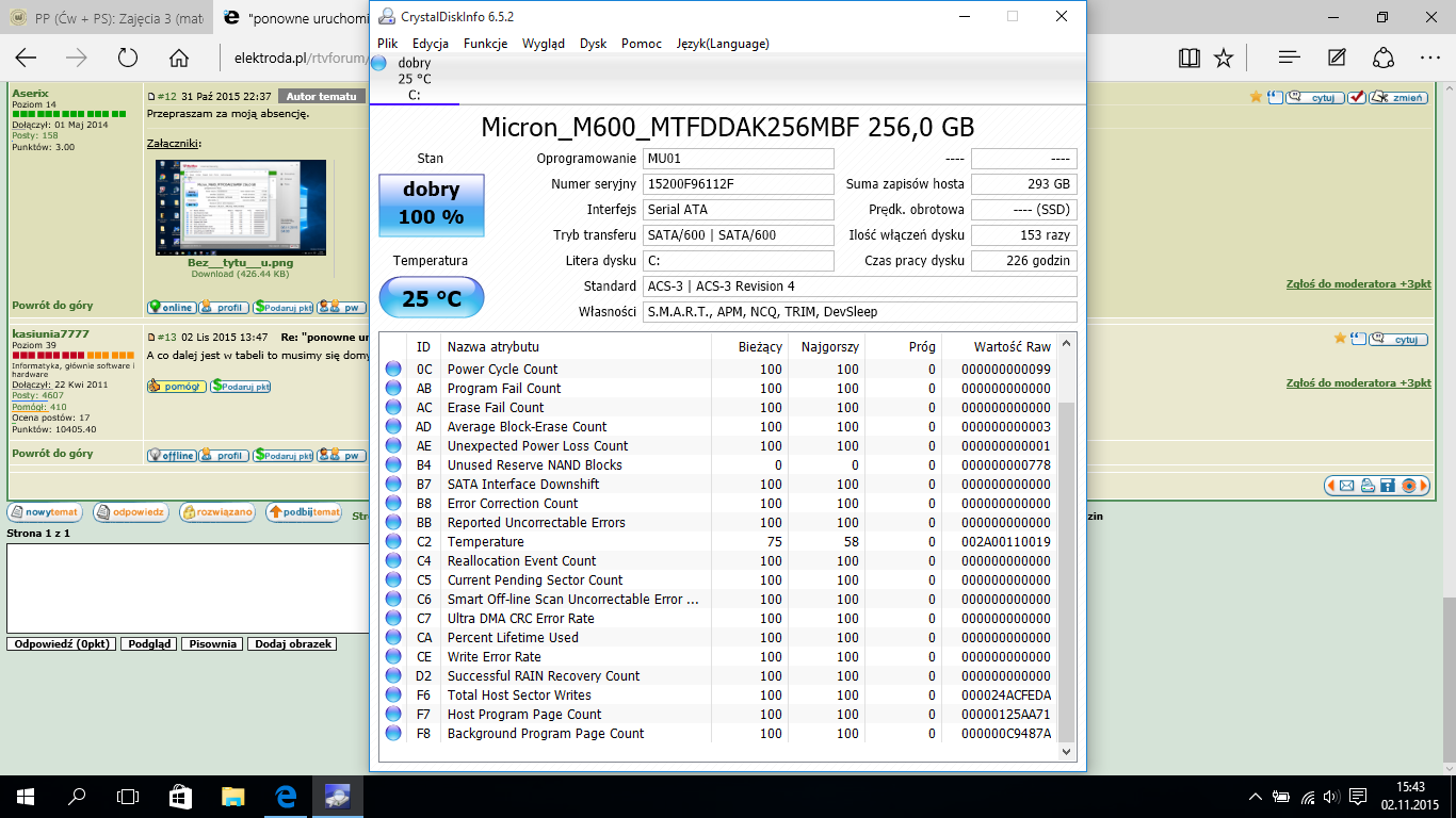

    And what's next in the table, we have to guess? since it is impossible to take 1 screenshot, then you have to do 2. 99% is all right, but just in case add the rest of the table.

    here is the rest
    • Several Hour Reboot After McAfee Internet Security Installation - Safe to Interrupt? Bez__tytu__u.png (179.65 KB) You must be logged in to download this attachment.
    #15 15118606
    kasiunia7777
    Posts: 4668
    Help: 420
    Rate: 244
    Everything's all right :)
