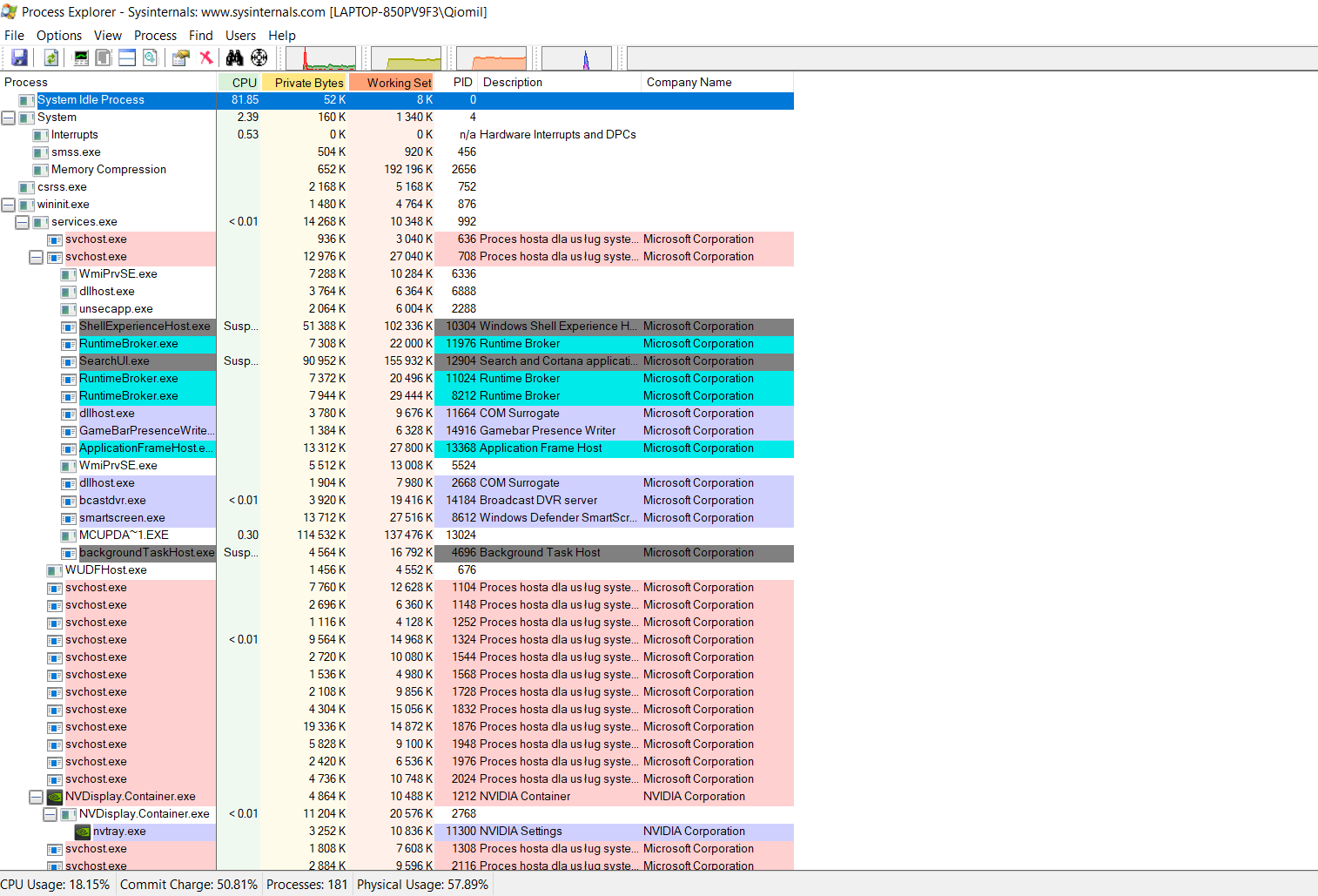

    Hello, I have a problem, for some time my laptop in Lenovo Legion Y520 laptop has 100% disk usage all the time. I even returned to the startup parameters, i.e. reinstall was, despite this, nothing helped and is it a damaged disk?
    1TB hdd disk

    Use Process Explorer from MS, enable showing column for writing to disk and place screen of the whole window from the program.

    Lenovo Legion Y520 100% Disk Usage Issue: 1TB HDD, Startup Parameters & Potential Damage
    Please.

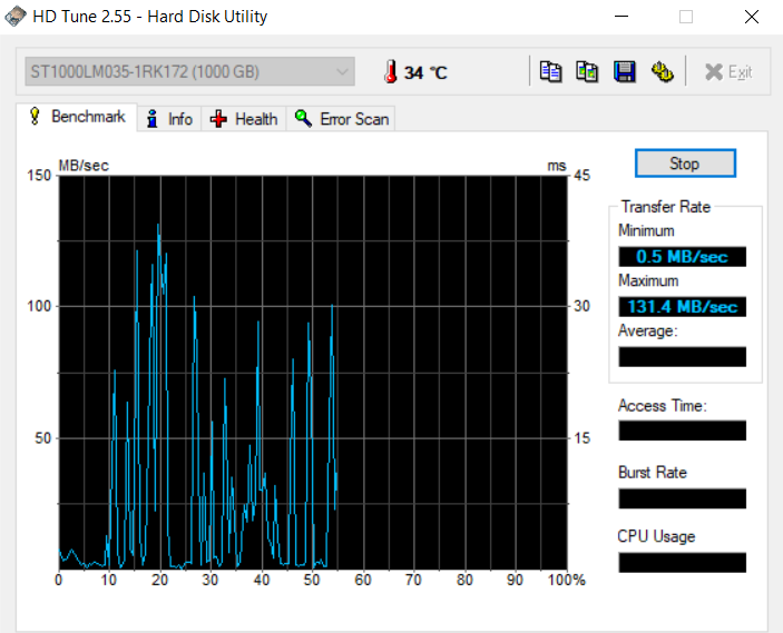

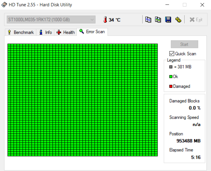

    And smart here! Lenovo Legion Y520 100% Disk Usage Issue: 1TB HDD, Startup Parameters & Potential Damage Lenovo Legion Y520 100% Disk Usage Issue: 1TB HDD, Startup Parameters & Potential Damage

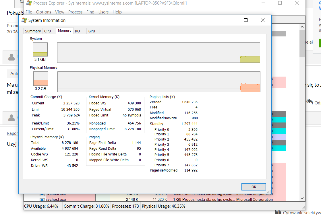

    Why did you open this window in the EP? You were supposed to put the ENTIRE main window screen.
    Screenshots from HdTune that you posted are not smart ...
    Sorry informatics etc is my worse side. I am completely green in it so sorry in advance.

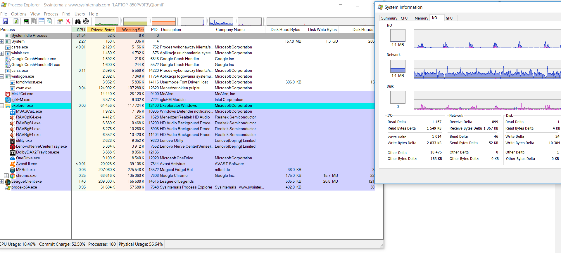

    This is still NOT the ENTIRE window, not to mention the lack of a column responsible for writing to disk.
    I still don't necessarily know what the whole window is about, after all, the main page of this program is all; d
    PS. Strange thing because now I have 9% disk usage and before 5min it was 100%

    Maybe some updates were installed?

    @Kolobos I left all updates overnight when I restored the system to its original state so they should not but we will see let me know tomorrow or on Saturday whether the problem disappeared and whether it was a regular update about which windows did not inform me

    So far, it's good, but it was probably an update (but strange because I didn't get a notification or anything.)
