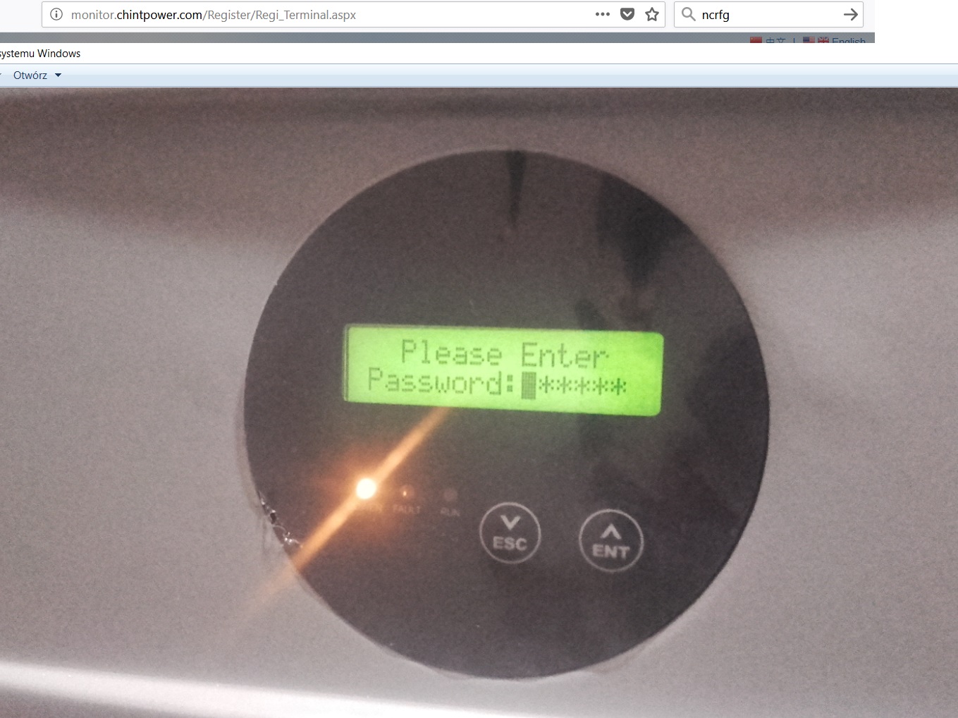

    Jur-ex wrote:
    This can be changed, but it asks for a service password (I did not enter any password). I asked the seller for a password, but I don't think he can get it either.
    Wlodek22 wrote:
    ask on FB in the photovoltaic department, I got the password for zever there.

    Do you have such a window to enter your password?
    and the inverter number starts with MV: 101243 ............... and at the end with D

    what window do you have to enter the password?
    The number is 10124114 ......... D, exactly the same window.

    I have sent the password to PW
    Have you started remote preview?

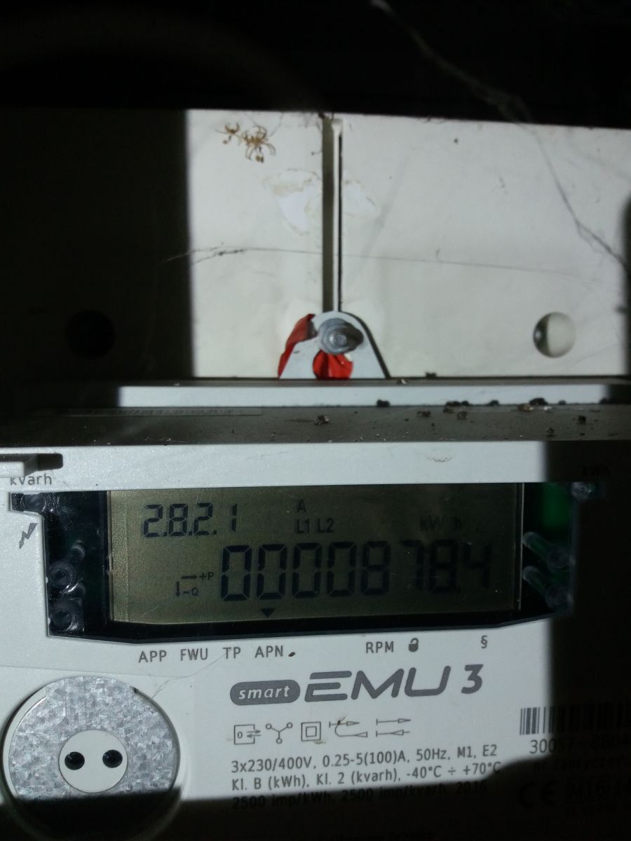

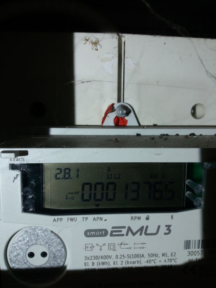

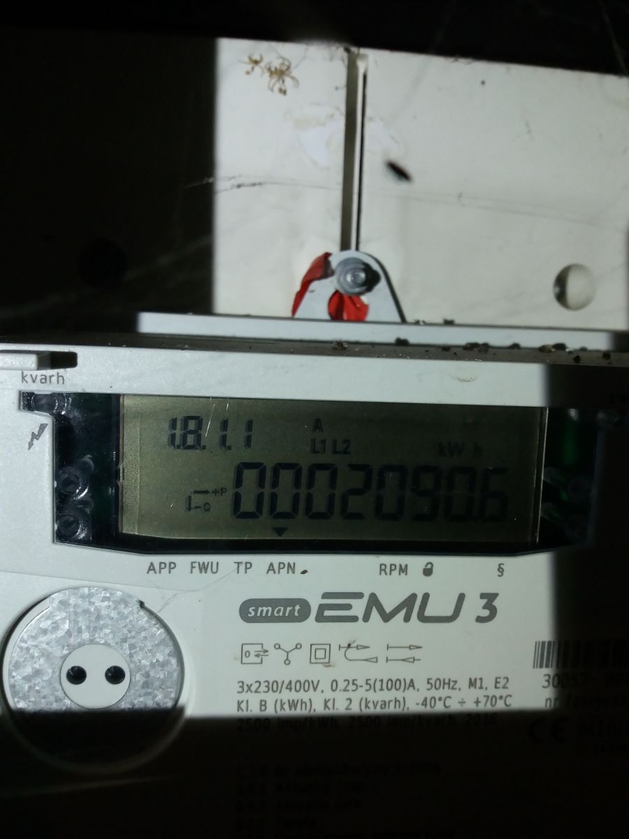

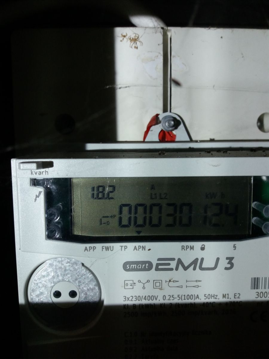

    I have a strange problem with the meter or photo installation. Namely, I received a bill yesterday from PGE and, to my surprise, the values of energy put into the grid were zero! After talking to the hotline, you said that if this is the case, it means that I used everything on an ongoing basis - because if I use more or the same amount at any time of the year than I produce, the indications are zero. Okay, but when I went on vacation - consumption was minimal, and the production of bulls (up to 2700wh), so for sure at some point it would count more than 0. Have you had such a case? Do you order a meter expertise for PLN 120? (at the same time they show how the meter turns out to be faulty), or look for a problem in the inverter? He also advised me to turn off everything in the house (can I use a plane switch?) And check whether the energy from the panels is generated by the meter. But in these weather conditions it is rather difficult. What do you advise? Have you had or heard of such a case? I will be grateful for the info. Best regards.

    You have a meter, compare what is on the invoice and what the indications say 1.8.0 and 2.8.0
    And as for switching off, it is not a planer because the inverter must be live, but rather turn off the loads

    Apparently, you used up exactly as much as you produced and put it behind the meter, so after returning from vacation you ate more than you produced ...
    My annual production is 5600kWh, consumption from behind the meter somehow 3800. I got fv for 147 PLN for 13 months and in the warehouse less than 40 kWh. This is called a well-rounded installation.
    If you want to check something, turn off home furniture, not the pre-meter one

    Thanks for the answer. The indications are right. I'm worried about the reason. I hope that it will be a counter - because then it will be possible to recover money, and in the case of the investor (although under warranty) or cable, etc., I will not get back this difference.
    But if I ate more after the holiday than I produced, the commandments to give up energy would remain (it probably does not go backwards). In previous billing periods, I had such situations that I downloaded more than I used, but the indications were large (non-zero).

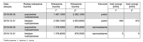

    Upload fv photos without personal data and the aforementioned meter readings.

    Billing every 6 months? Half and the beginning of the year?
  • #54 18408736
    dario1965
    Posts: 34
    Board Language: polish
    Yes. Settlement is every six months, but when I have a seaside, it goes to the second half of the year.

    Yes it does, but looking at the meter reading you use a lot more than you produce.

    Power 3KW. FOR nearly 2.5 YEARS. On the meter 6.4 KWH. For now, it was almost 0.
    Below, a similar invoice from 1.5 years ago
    Date Type of reading counter indication Counter indication Direction Amount of energy [kWh]
    1 * 2 * 1 * 2 *
    2017-12-31 previous settlements 391.1000 533.4000 consumption
    2018-06-30 current settlements 810.9000 1 267.5000 consumption 420 734
    2017-12-31 previous settlements 116.1000 71.4000 entering
    2018-06-30 current settlements 795.9000 526.9000 entering 680 456

    It looks as if the meter would freeze six months ago and do not charge you anything for the electricity supplied to the network.

    It looks like in the last six months you sent 0.1kWh in tariff 1 and the same in tariff 2 and you did not enter how much you produced
    earlier you wrote about the holiday and that the production of the bull (up to 2700Wh) if you gave it right and for what period because it is 2.7kWh and with 3kW installed, it would turn out that the installation worked only 1 hour.
    You also write: "Power 3KW. FROM nearly 2.5 YEARS. On the meter 6.4 KWH" then check it again and what meter is mentioned here, what inverter it is and whether you have a remote view of production
