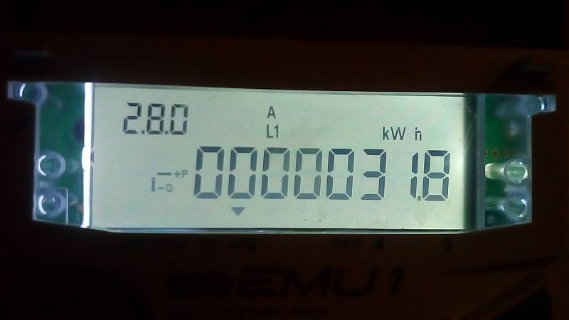

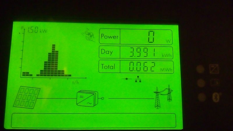

    On February 1, I launched the PV installations. I noticed that the data from the inverter differs from the data from the bidirectional meter. Should it be so or is something wrong?
    I have not yet received a fv from PGE (only in 6 months), so I do not know if such indications are ok. If there are any irregularities, I would rather catch them at this stage.
    Data:
    inverter: 62 kWh produced
    2.8.0 meter: 31.8 kWh exported
    1.8.0 meter: 196.3 kWh

    You must remember that what the house will use will not be on the 2.8.0 meter.

    The counter is bidirectional. Household consumption shows 1.8.0
    However, I am concerned about the difference between the indication of the inverter and the meter in terms of kWh production. Are these indications okay or is something wrong?

    After all, what the inverter produces, you also download on the fly without being connected to the network.
    that is, your consumption is
    196 from the meter + (62 - 31) = 196 + 31 = 227kWh
    Everything is correct for me.

    It is very good, you have your own consumption at 50%, and the higher the better.
    If you disconnected all receivers, the inverter display = 1.8.0 display.
    You also have an arrow P and at the moment "+" indicates that the production is less than consumption and you additionally download from the network, as it will be "-" then it is sending.

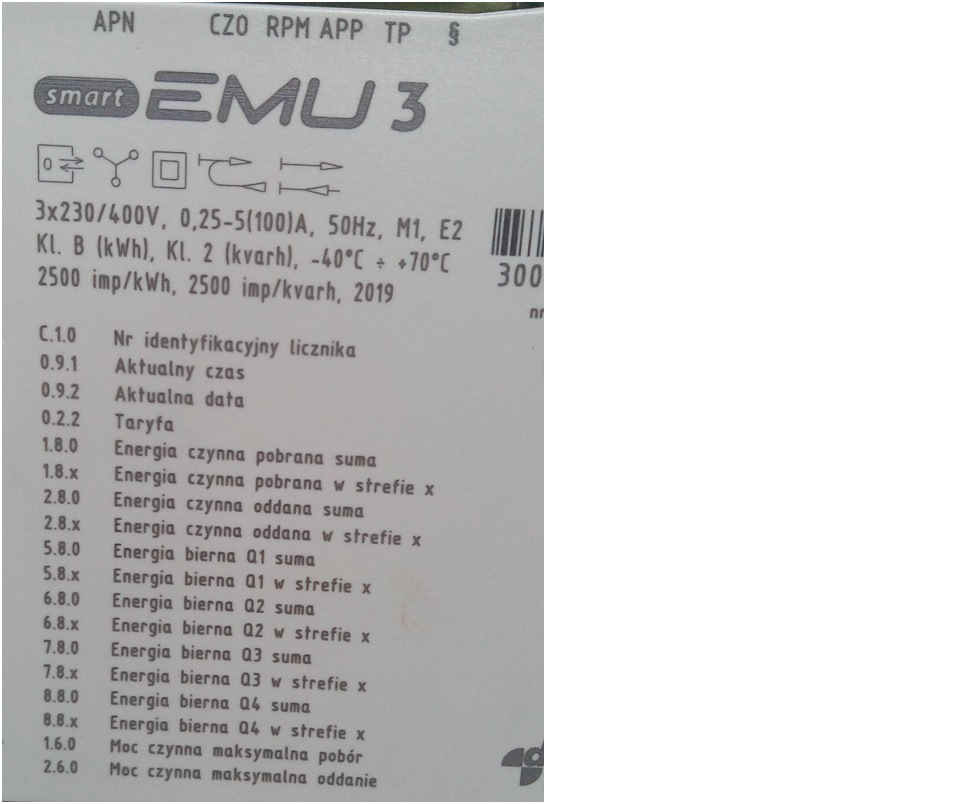

    Gentlemen, please help me decode the Smart EMU3 meter readings.
    The point is, it doesn't say 1.8.0 and 2.8.0. PV installation commissioned and the meter set up by PGE at the end of August.
    Photo of my meter.
    PV installation - data from the inverter vs data from the meter
    My indications are slightly different.
    (After 0.2.2 Tariff, there are such):
    1.8.1 ------------- 0000052.2
    1.8.1.1 ---------- 0000022.7
    1.8.2 ------------- 0000081.5
    1.8.2.1 ----------- 0000023.0
    2.8.1 ------------- 0000135.2
    2.8.1.1 ----------- 0000057.7
    2.8.2 ------------- 0000085.3
    2.8.2.1 ----------- 0000044.4
    5.8.1 ------------- 0000000.8
    5.8.1.1 ----------- 0000000.7
    5.8.2 ------------- 0000000.5
    5.8.2.1 ----------- 0000000.0
    6.8.1 ------------- 0000000.4
    6.8.1.1 ----------- 0000000.3
    6.8.2.1 ----------- 0000000.1
    7.8.1 ------------- 0000051.9
    7.8.1.1 ----------- 00000.18.2
    7.8.2 ------------- 00000.33.6
    7.8.2.1 ----------- 0000015.1
    8.8.1 ------------- 0000026.7
    8.8.1.1 ----------- 0000008.8
    8.8.2 ------------- 0000059.1
    8.8.2.1 ----------- 0000019.7
    C.12.5 -------------------- -91
    1.6.0 ------------------ 003.40
    2.6.0 ------------------ 002.36
    The inverter produced 330 kWh at that time.
    from what I can see you have two tariffs.
    downloaded
    1.8.1 is the current month in zone one, 1.8.1.1 the previous month (August)
    1.8.2 is the current month in the second zone, 1.8.2.1 the previous month (probably show up to 6 months back, the last one is deleted)
    production
    2.8.1 the current month in the first zone, 2.8.1.1 the previous month
    2.8.2 the current month in the second zone, 2.8.2.1 the previous month
    production data 2.8xxx shows that you sent 322.6 kWh for the meter, a poor, even zero self-consumption.

    Wlodek22 wrote:
    I, on the other hand, drew attention to the reactive capacitive, 114kVarh in total, i.e. about 5-6kVarh per day. Just like it was with me
    apparently the inverters send it when they are not working and someone wrote somewhere that he made a driver for disconnecting the inverter from the network (simulating the loss of the network). Let's say at 5am the contactor was turned on and the inverter would normally pick up, after sunset / finished production the contactor off. I did the approaches at home and wrote down the kVarha in the evening, but in the morning I always forget to write down and compare again.
    You can read https://www.elektroda.pl/rtvforum/topic3241406-600.html

    Wlodek22 wrote:
    How many days after replacing the meter is this reading?
    Installation on August 24-15, 2019, i.e. 24 days.
    Thanks to you guys for these comments, it explained a lot to me about reading this meter. I don't know yet what about the reactive energy Q1, Q2, Q3, Q4.
    I am also puzzled by the almost zero direct consumption of production. Could the reason be wrong setting of the inverter. I did the installation myself, the new CPS ChintPower inverter, I made an error when starting it and I coded Australia as a country. This can be changed, but it asks for a service password (I did not enter any password). I asked the seller for a password, but I don't think he can get it either.
    Wlodek22 wrote:
    I meant the days of the exchange. Judging by the data, about 20 days. I, on the other hand, drew attention to the reactive capacitive, 114kVarh in total, i.e. about 5-6kVarh per day. Just like it was with me

    The setting of the inverter is unlikely to be the reason why you have this 1 or 3 phase inverter and what model
The discussion revolves around discrepancies between the energy production data from a photovoltaic (PV) inverter and the readings from a bidirectional meter. The original poster noted a significant difference in the energy produced (62 kWh) versus the energy exported (31.8 kWh) and total consumption (196.3 kWh). Participants clarified that the inverter's production includes energy consumed directly by the household, which is not reflected in the meter readings. They emphasized the importance of understanding how bidirectional meters work, particularly in relation to household consumption and energy export. Several users shared their experiences with similar issues, suggesting that differences in readings could stem from various factors, including meter calibration, inverter settings, and household energy consumption patterns. The conversation also touched on the need for accurate metering to assess energy efficiency and potential discrepancies in billing.
TL;DR: A 50 % self-consumption rate is “everything is correct” [Elektroda, 3301, post #17047684]; inverter totals usually read 1–5 % higher than revenue-grade meters [NREL, 2020]. Track 1.8.0 (imports) and 2.8.0 (exports) daily, subtract to catch errors.
Why it matters: Early comparison prevents six-month billing shocks and lost kilowatt-hours.
• Inverter-to-meter deviation: typical 1–5 % [NREL, 2020] • Self-consumption example in thread: 50 % [Elektroda, 3301, post #17047684] • Add-on three-phase Orno meter cost: PLN 170 new, PLN 100–110 used [Elektroda, Jan_Werbinski, post #17052436] • Reactive energy (Q1–Q4) not billed until approx. 2026 [Elektroda, cuuube, post #18171654] • Phase-balancing test: 0.5 h, >⅓ load on one phase, watch 1.8.0 [Elektroda, 3301, post #18043981]
Why does my inverter show more kWh than the bidirectional meter exports?
The inverter counts every watt it produces, but the meter logs only what flows through it. Energy used instantly by appliances never reaches the meter, so exported 2.8.0 is lower. A 31 kWh gap on 62 kWh production matched 196 kWh household use in the thread [Elektroda, marcinbbb, post #17047628]
How do I calculate real household consumption?
Use: Consumption = Inverter production + 1.8.0 (imports) – 2.8.0 (exports) [Elektroda, Jan_Werbinski, post #17051898] This sums what was generated, adds grid energy taken, and removes what you sold back.
Is 50 % self-consumption considered good?
Yes. Grid operators and installers target 30–50 % for homes without batteries. The original poster reached 50 %, which was called “very good” [Elektroda, 3301, post #17047684]
What do meter codes 1.8.0 and 2.8.0 mean?
1.8.0 = total active energy imported from the grid; 2.8.0 = total active energy exported. Apator Smart EMU manuals confirm these designations [Apator Manual].
Does phase balancing affect my credits?
If your utility enables inter-phase balancing (PGE does), total three-phase power is settled, not each phase [Elektroda, kosmos99, post #18322484] Without balancing, one heavily loaded phase can draw while others export, raising 1.8.0.
How can I test whether balancing is active?
  1. Choose a sunny hour when PV is producing. 2. Connect a load >⅓ inverter power to one phase for 30 minutes. 3. If 1.8.0 barely rises, balancing works; if it jumps, balancing is off [Elektroda, 3301, post #18043981]
How accurate are inverter energy counters?
Field tests show inverters read 1–3 % high compared with Class 1 meters [NREL, 2020]. Forum users noted 9 kWh gaps on 400 kWh production (≈2.3 %) [Elektroda, RomanCitro, post #17248867]
What are Q1–Q4 reactive energy values on Smart EMU meters?
They log capacitive/inductive reactive energy in four quadrants. Current Polish tariffs ignore these values for residential prosumers until at least 2026, so they do not affect bills yet [Elektroda, cuuube, post #18171654]
Could wiring losses explain large differences?
Yes, high cable resistance or loose connections between inverter and utility point can waste energy as heat. Losses above 2 % on short runs suggest a fault [IEC 60364]. A user fixed a mis-wired pole connection that caused abnormal meter gaps [Elektroda, RomanCitro, post #19681224]
Can wrong country settings in the inverter lower exports?
Changing grid profiles mainly adjusts voltage and frequency trip points; it does not affect self-consumption share [Elektroda, 3301, post #18171586] Leave settings that match local grid standards to avoid shutdowns.
Why does my apparent consumption rise after PV installation?
Two reasons: 1) You use more appliances during daylight, assuming “free” power—forum users admitted this behavior [Elektroda, rokbok, post #19680661] 2) The previous meter may have under-registered load; the new smart meter is more accurate, revealing real demand.
When should I request a utility meter inspection?
Request if daily exports drop to zero despite sunny production, or if inverter and 2.8.0 diverge by >10 % for a week. Document readings and photos; utilities charge for successful tests only when the meter is accurate [Elektroda, 3301, post #18408521]
Daily checklist: How do I verify readings?
  1. Note inverter kWh at sunset.
  2. Record 1.8.0 and 2.8.0 on the utility meter.
  3. Next morning, compute self-consumption with the formula in Question 2. Three numbers should reconcile within 3 %.
