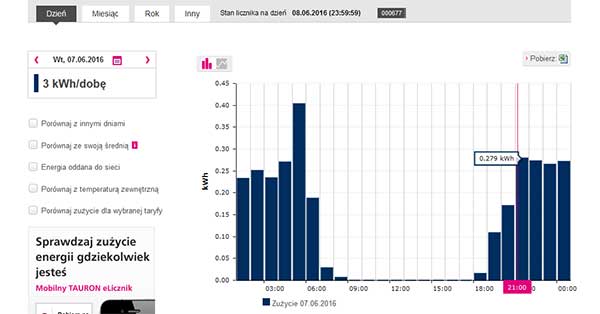

    When installing the Landis + Gyr E550 meter with a GSM module in February, the installer said that the meter does the balancing every 15 minutes. A letter has arrived today to send the Q1 report.
    Added after 59 [minutes]:
    Do you use eCounter in Tauron? I cannot create an account, he writes:
    "We are sorry, registration to the TAURON eLicznik system is not possible. There is no remote reading energy meter installed in your home, business (or garage). "
  • #17 15720111
    Krzy$
    Posts: 60
    Rate: 17
    eCounter after the exchange of messages, has been started, I have a preview via eCounter in Tauron.
    You can see how it balances how solar 0 consumption is, and how much is sent in overproduction.

    I have started the remote counter from the beginning of June (I have readings from the beginning of the installation of the counter). Each photovoltaic meter will work remotely. Therefore, they mount a GSM module to the meter. But we had to ask about this counter so that they could configure it.

    The guns in Tauron had no problem, it took a while to get connected. Verifying Overproduction Balance on Landis + Gyr E550 Meter with GSM Module
