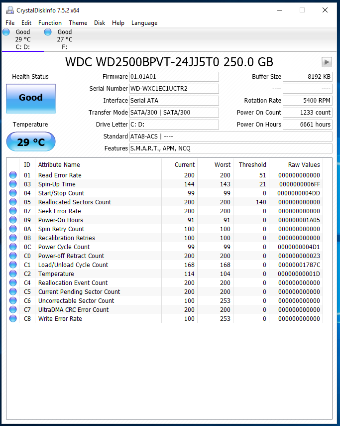

    Show SMART disk.

    In the printscreen attachment,
    I still have such a lead, as I activated the admin account, the name of this unwanted guest account, WDAGUtility Account appeared in CMD, and maybe following this lead, the problem is on the windows update side. However, this does not solve my problem, I would like to get rid of this account.
