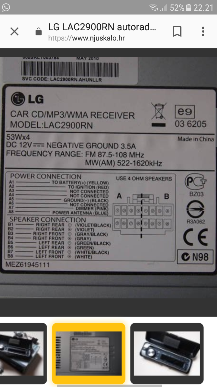

    Hello,i have problem with wiring nokia subwoofer.I found this scheme
    1 - + 12V constant
    2 and 3 left speaker output. And high tone
    4 - mass
    5 - on / off + 12V control
    6 - left channel input
    7 - right channel input
    8 - input mass
    9 and 10 output to right speaker Avg. And high tone
    How to wire output (6,7) from this radio LG LAC 2900 Audi a3 8l nokia amp wiring - Wiring subwoofer with lg lac 2900Screenshot...222120.png (555.99 kB)You must be logged in to download this attachment.
    And what wire to connect on input mass?
    I guess speaker output go to the front and rear speakers?
    This is picture of nokia wofer
    Audi a3 8l nokia amp wiring - Wiring subwoofer with lg lac 290020180222_2..703.jpg (4.91 MB)You must be logged in to download this attachment.
