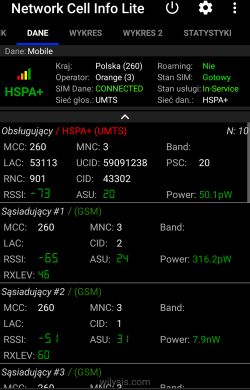

    I know that you have a lot of knowledge on this subject, and you know it better, in addition, you devote your time to help and I respect it very much! I am sorry that maybe I wrote so, it just irritates me all this. I need a router only for everyday use (and unfortunately for work) browsing, connection to the TV and this router what I have it meets my expectations just simply "loses" the Internet.
    I will do a call info test in the afternoon and send it as it went.
    Added after 7 [hours] 28 [minutes]:
    Call info details
    TP-Link MR6400 Router with LTE Modem: Internet Connectivity Drops After Certain Duration
    but if someone uses these signal amplifiers then I understand that unless someone turns it off the transmitter will not work ?? Even despite the fact that there is something working with the transmitters all the time, I can even see that when it is dark, with the headlamps it is on the air and doing something there

    Added after 1 [hours] 25 [minutes]:
    The router worked in a car I changed to 3G work and now it works fine. greetings
