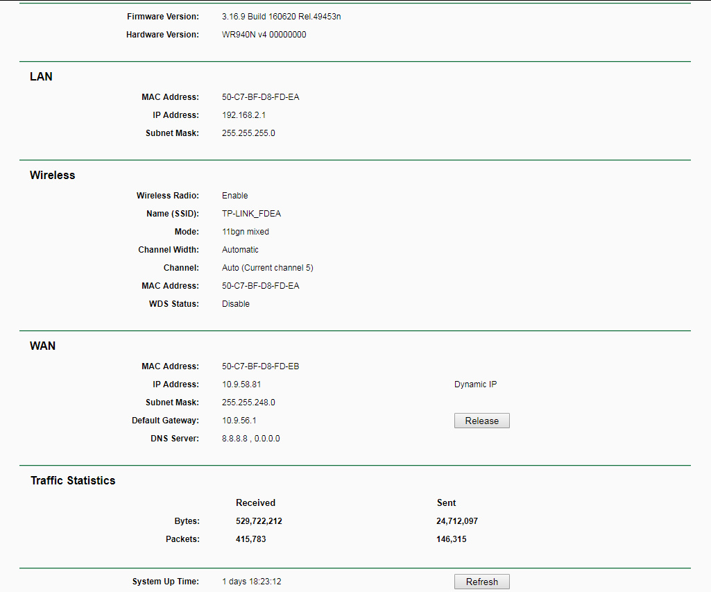

    I would like to ask for help regarding the cooperation of my CISCO EPC3208 modem with TP link WR340G and TP Link WR940N routers
    My home network looks like I have a CISCO modem (toya), a TP link router connected to it (by cable) AND also a cable connected PC.
    And for some time now, the Internet has been disconnected in this statement at completely random times. Modem works fine (I called Toyota several times and they saw no problems with the modem) - moreover, I connected the modem directly to the PC and it also worked fine (in the sense it did not disconnect from time to time).
    Natomaist, after establishing a connection with the Router, the disconnection takes place every few minutes / hours (the lamp on the router lights up, which indicates that there is no internet). Every time when in such a situation the CISCO modem is restarted -> the internet appears temporarily and then the fault returns.
    In the end, I bought a new TP link router, I thought that the old one was used up after a few years - but the fault has not disappeared.
    I rummaged through a dozen or even tens of forums to find a solution. Despite various treatments such as:
    1.I changed the cable connecting the PC with the router
    2. I changed my DNS setting to 8.8.8.8
    3. I turned off DHCP temporarily
    4. I colonized MAC
    5.Changed my lan IP from 192.168.0.1 to 192.168.2.1
    6. I have updated the firmware to the newest one dedicated to my new router
    7. I restarted the whole set several times in the order Modem-> router> PC (with full shutdown and turning on in this order)
    8. I uninstalled antiviruses and firewalls (it detected several worms)
    9. I scanned for viruses before uninstalling
    10.after uninstalling, I reinstalled the antivir and firewall and scanned again qksee virus detected -> removed
    None of the above steps solved the problem.
    I will be grateful for any suggestions - while writing this post, the internet broke down on me 3 times :) I'm really fed up.
    The network card in the PC is: Realtek PCIe GBE Family Controller
    The attachment also adds the status from the router and ipconfig

    The second counter from the right -> if it is blue - the internet is there. When the internet fades it turns orange.

    After a few hours of internet load, I confirm that the problem was most likely a faulty modem power supply.
    The topic from my side to be closed.
    Thanks a lot everyone for the advice!
