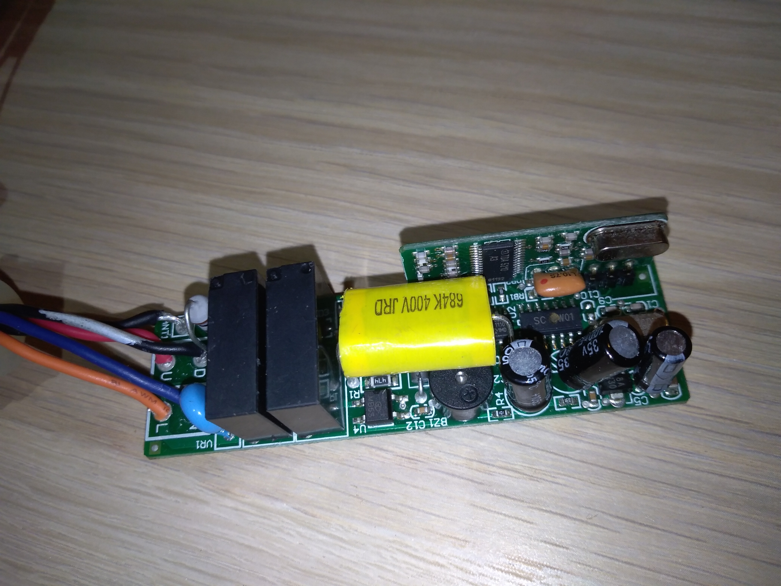

    Hello, the situation is as follows. Two of the 15 shutters have stopped working, there is no reaction to the remote control signals. After a momentary power cut (foot down, foot up), the unfortunate blinds start to work but responds only to one command. For example, it can be commanded to raise the roller shutter and the end. Completely unresponsive to the next power cut. I read about the same problem so much with motors and drives from other companies and it turned out and after soldering the capacitors the problem resolved. The question is whether anyone knows whether yooda will be similar.
    Greetings.

    The motors have a built-in radio. They are on the remote control. They are not in service mode. I reprogrammed it didn't help. I disassembled one of them. I undressed and it looks like when it heats the dryer control system, everything works properly. Until it cools down. I sold all February from the bottom. Did not help. I replaced the capacitors, it did not help.

    I replaced the yellow capacitor and it started working.
    Added after 49 [seconds]:
    Capacitor replacement.
