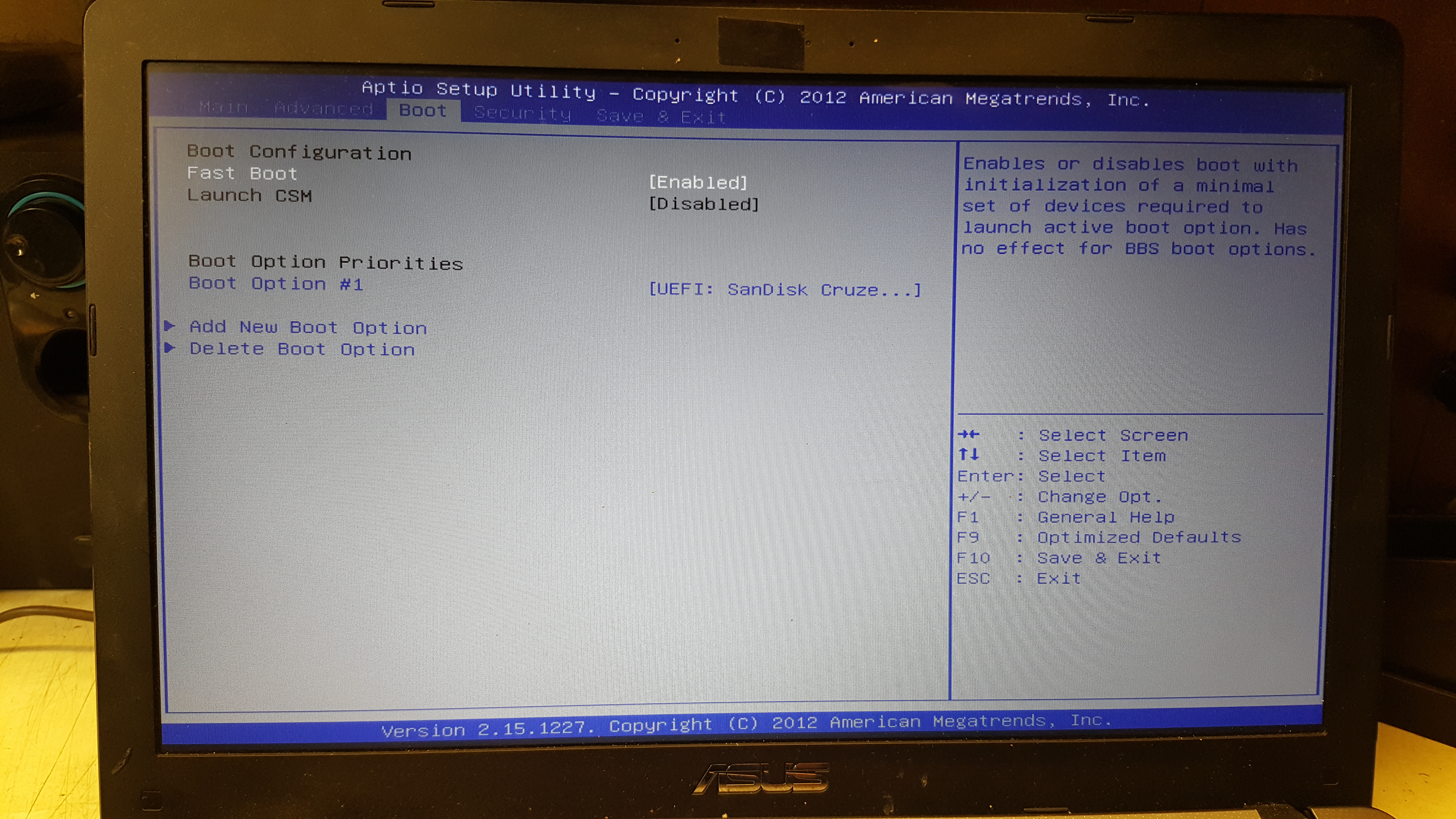

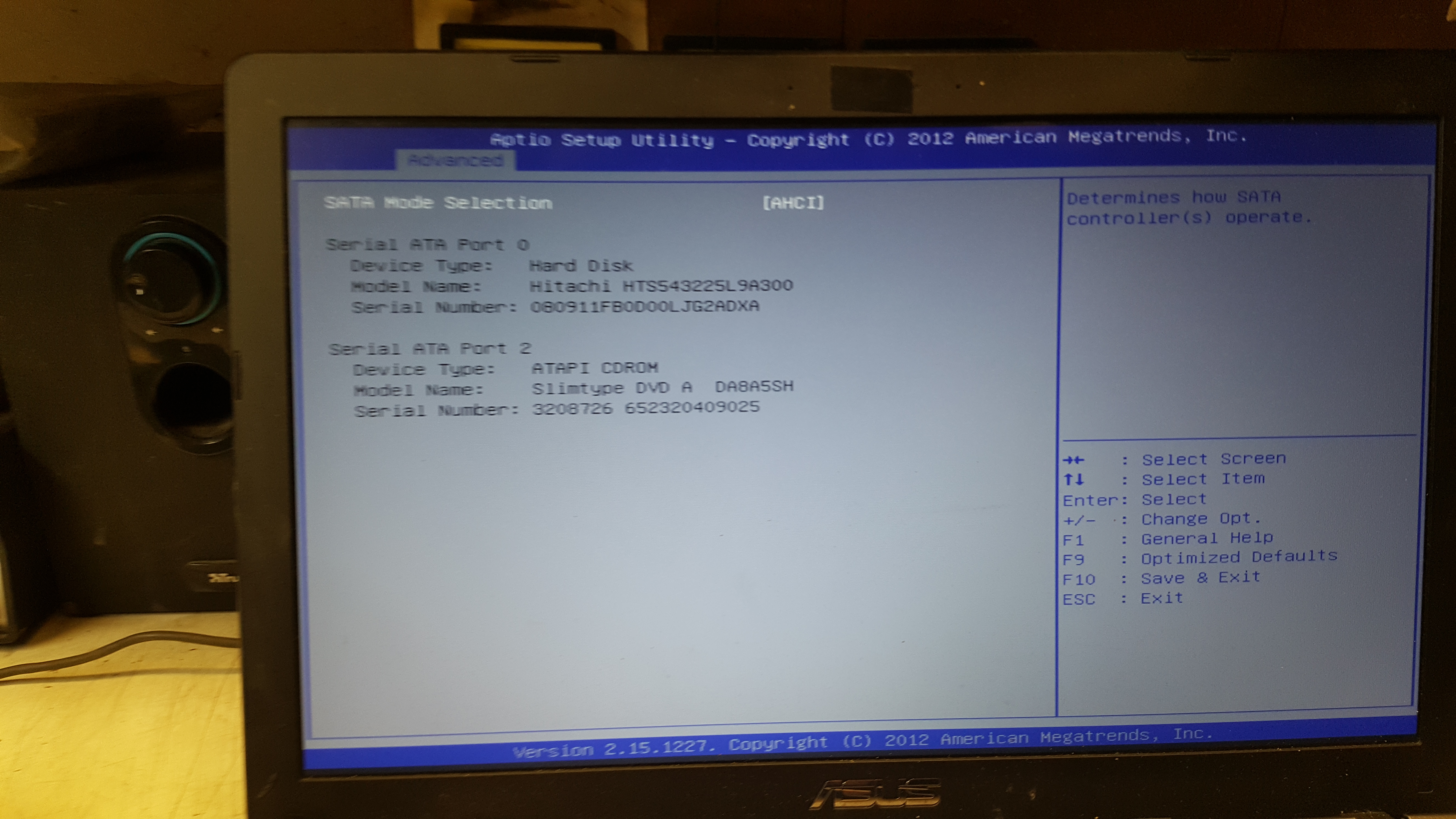

    Hello. The laptop itself goes to the bios after turning on, I have restored the factory settings and nothing, I took out the battery and nothing .. in the advanced -> SATA CONFIGURATION tab the disk is loaded but in the boot tab it is no longer there. I will add photos of my bios settings

    It enters the bios because there is no bootable device or an active boot partition, to make sure you first put some live linux CD, make sure the bios is set to search the system from this media and see what happens. And set Lunch CSM to ENABLED

    I had the same symptom. The hard drive was damaged. System replacement and installation helped

    Hello. Problem solved, it turned out that the bios was incorrectly set up and as a colleague wrote "cyberdelia" (the bios is set to search the system from this medium and see what happens. And set CSM Lunch to ENABLED) additionally security blocked me. Everything is already flashing beautifully :) Thank you very much for your help.
