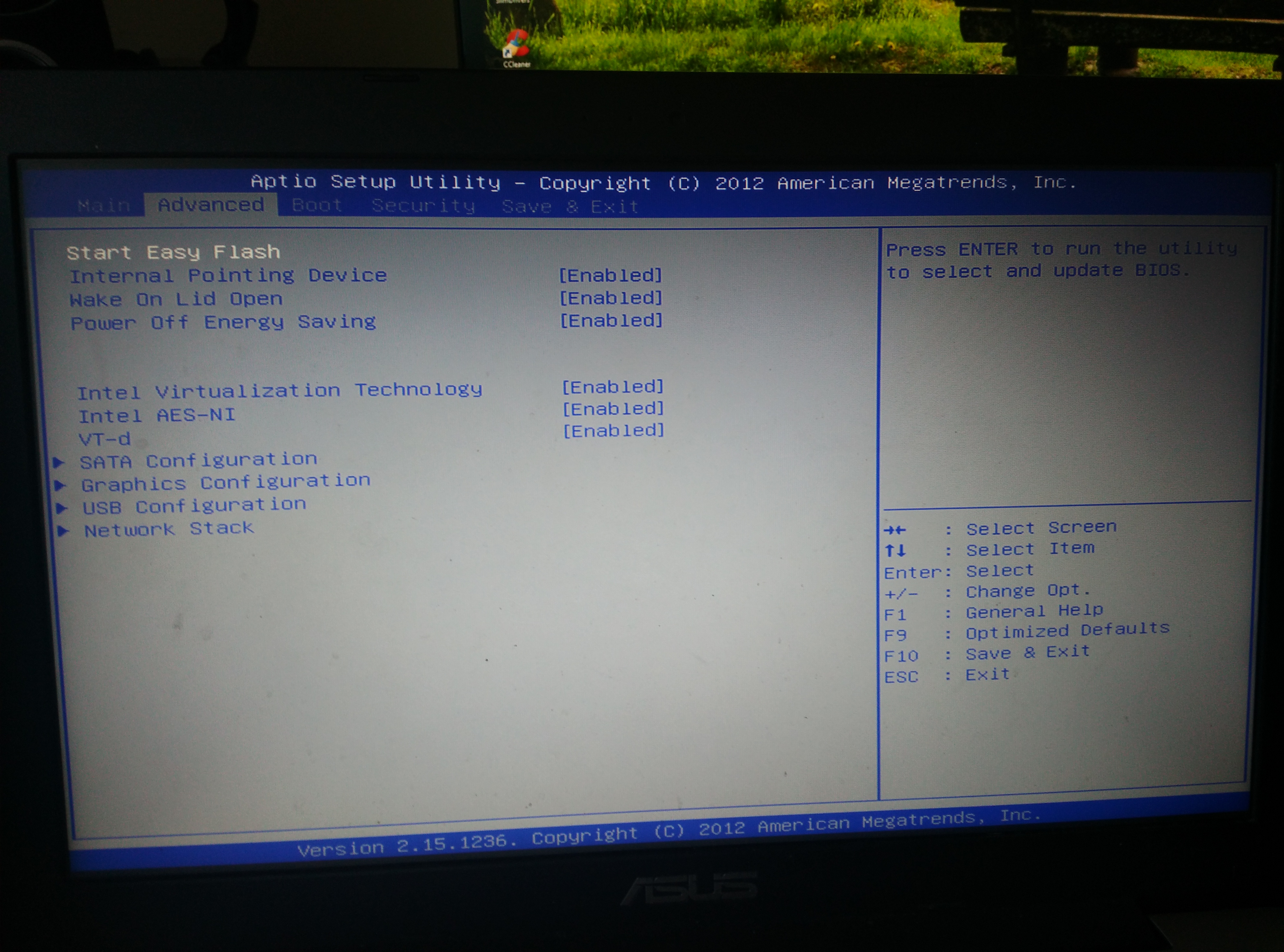

    ASUS R556L enters the BIOS itself - ASUS does not boot Win 8.1 I installed the new Windows 8.1 on the ASUS R556L laptop with a pen drive. The installation was successful, but after restarting, the mouse automatically enters the BIOS instead of Windows.
    BIOS X555LD.310
    In the BOOT tab, I have only such positions:
    Boot Configuration
    Fast Boot [Enabled]
    Launch CSM [Disabled]
    Boot Option Priorities
    Delete Boot Option
    Is it possible to set up booting from disk here or in another BIOS tab?

    Boot set on EFI or LEGACY?

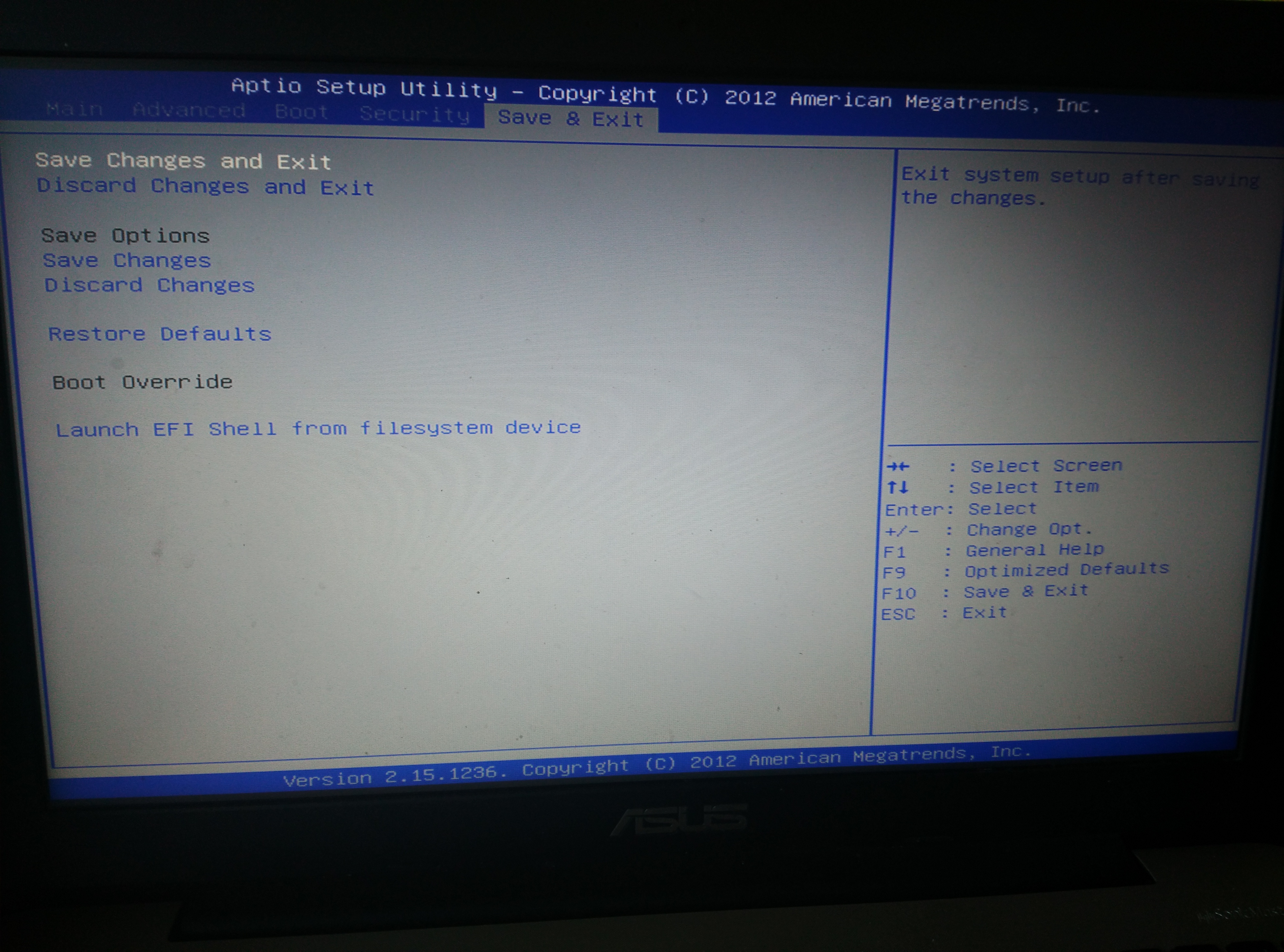

    There is something like this in the Save & Exit tab:
    Launch EFI Shell from filesystem device

    I did not ask about it. What you have given is something completely different.
    If you do not know what I'm asking, make photos from each tab.

    SATA CONFIGURATION - how did you set it?
    What's happening at SECURE BOOT?
