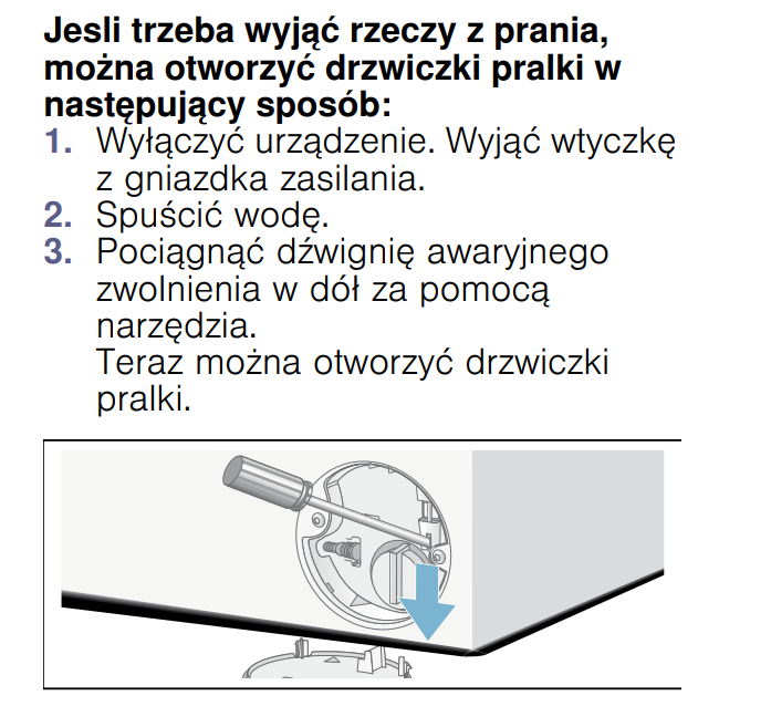

    Hey, I have a problem with parental lock I think. I cannot open the door, the key is displayed. I tried the method with holding it for a few dozen seconds and it does not help ...

    Please try to open it like this.

    "Child protection. (...)
    To switch on / off, press and hold the Spin and Ready in buttons simultaneously for approx. Three seconds. "

    Thanks for the hint. Ready in 3 seconds and start at the same time helped. Thank you
