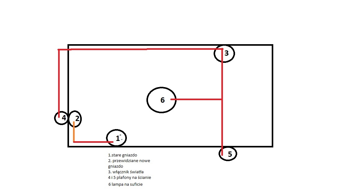

    Can you tell me how to lay a cable in a built-up plasterboard wall? If I cut a groove in the slab, will I seal it somehow? Another problem is the corner through which the cable will pass. The wall cannot be destroyed, it will only be painted and the troughs are out of the question.
    Can you suggest something?

    Take a picture of this wall, draw a freehand diagram of the wall and the location of the current nest and the one to be added, dimension it all.
    Put it in the topic, then we will be able to advise something :)

    Is the ceiling suspended? Is the plaster?
    If suspended, you could run the wires through the ceiling, go down to the lamp / switch, thanks to which the vertical profiles in the wall structure will be avoided.
    Squeezing the wire in the wall vertically is not that difficult.
    This is about lighting.
    A new nest would be the fastest to put in the wall.
    What are the approximate distances from the corner to the old and new nest?

    Thanks gentlemen for your interest. I will try these holes and the steel pilot. I think the detector detects it. The mirror or camera method is out of the question, unless I pull out cotton wool. Unfortunately, there are no skirting boards. The walls are made of one layer of boards.
    Everything is made of tiles, including the ceiling. The building is held only by pillars.
    How to cover such holes? Unfortunately, I have no idea about the builder.

    If you want to make a lamp on the ceiling, you take into account that there will be a groove for filling, or holes if the ceiling is suspended.
    This takes care of the lighting, this or that, run the wires to the switch and plafonds from the ceiling, the lamp stays on the ceiling, the plafonds and the switch go down the wall from the ceiling.
    One hole in the corner between the ceiling and the wall, and the other in the place where the plafond and the switch are mounted.
    The socket should be able to make extra money with one additional hole in the corner of the walls, at the height of the socket assembly.
    Old junction box No. 1, disassemble completely, make a ready hole for the new junction box No. 2, in the very corner, between the sockets, at the same height, cut a groove in the plasterboard, depending on the number of layers of plasterboard (one or two layers), it may be necessary to cut the profiles as well, so that the depth of the furrow is about two centimeters.
    Push the wire from box 1 to the corner, make it neat in the corner and push it from the corner to box 2.
    In the corner, in the place of the cut profile, it would be worth protecting the cable against possible abrasion.
    It is understood that the circuits of lighting and sockets are different from each other?
    Switch No. 3 exists :)

    I did not write about lighting because I would use the way from the socket.
    There will be one nest, and behind the wall where the nest is to be, there is a renovated room.

    The ceiling lamp is already powered from this switch.
    The most important thing is that there are some concepts so tomorrow on site some method will definitely work. Even if you wrote whether gypsum putty is suitable for gluing such holes, I would be grateful :) .

    In the first post, no, but the lighting points are marked in the picture, I don't think they are there, for better insight into the situation of making a socket.
    99% of the walls have some kind of insulation, it is not easy to break through it, you need to make holes for wires in the vertical profiles, you need a large hole in the plasterboard for this.
    There is a suspended ceiling in which 99% there is no insulation, passing the cable through the ceiling is almost trivial.
    You do as you think :)
