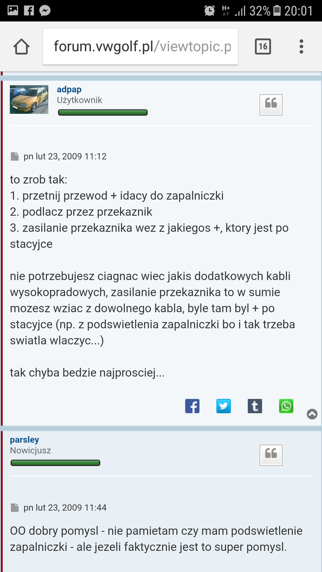

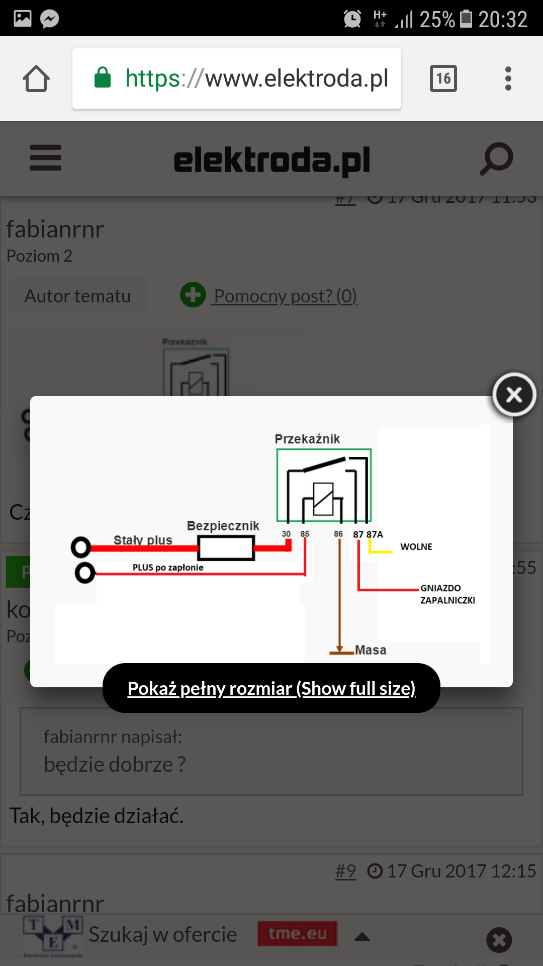

    Good day. In connection with the purchase of a video recorder, I decided to change the constant current in the lighter to one that will appear only after turning the key to avoid the battery discharge situation. After studying a few forum entries, I came to the conclusion that the easiest way would be to connect the relay to the cigarette lighter. The most suitable cable is the cigarette lighter backlight cable and I decided to use it. It should work on the principle that when the lights are turned on, electricity will appear in the lighter, causing the video recorder to start. Initially, I connected it as in the attached diagram, but replaced the 86 contact with the backlight cable instead of the ground. The solution works, unfortunately, when I turn on the lights, there is a hum in the relay. After starting the engine, the hum intensifies even more, it makes loud noises. I thought it was the fault of the 86 contact, so I connected ground directly to it. The effect is the same. A loud hum.
    Relay is 12v dc A.
    Overall a very good idea, but I don't know how I can remove this relay hum and what causes it. Can anyone help me?

    You have a good scheme and idea. And you have the option of replacing the relay because it is possible that it is faulty

    Fly with the cable from the radio. There may be pulses in the backlight and so on. Alternatively, if you have to combine too far from the radio with an optocoupler or stabilization of this voltage.

    Check if the backlight is turned up to max with the potentiometer. But still the voltage after the "dimmer" is not suitable for a relay without stabilization / filtering.

    Test the relay coil under the battery and see if it buzzes. He should not. This way you will rule out a defect in the relay.
