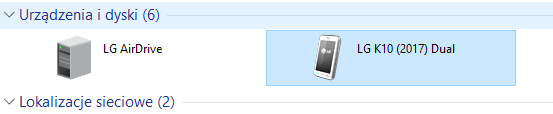

    Hey, lately I often connected my phone to my computer. One time I chose the option just loading and do not ask again. Now, after connecting the computer, the phone is only charging, nowhere on the PC is not visible and the query after connecting the USB cable is not there. I have looked through the menu and I can not find change options anywhere. The phone is LG k10 2017 (Android 7.0). There is practically nothing in the service menu. All that remains is a hard reset? I hope not 8-O

    Go to Developer Options and then choose USB configuration and change there to transfer files.

    Ok, thanks to help. All you have to do is enter the settings for programmers - select the USB configuration - and select MTP (Media Transfer Protocol) and most importantly reset the phone. The change in the programming options did not help without restarting the phone. Thank you again for your help :D
