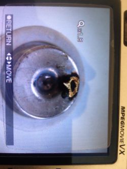

    Does this look like a blown fuse? Identifying a Blown Fuse: Does This Image Show a Damaged Fuse?
    Thank you in advance and best regards.

    It looks like that

    Still such a question, could such a fuse blow a short circuit that caused a fire?

    After this there is a fuse that nothing will come on.
    Such is his role.
    Of course, assuming that the installation is made in accordance with the standards in force on the day of its execution and at all times it responds at least to these or today's standards.

    I bet that it was not an "original" fuse element, just a blown insert from which someone poured sand, mended with a wire, and additionally weakened the head. If that was the case, something could have caught fire.

    Such a burned out hole may be the result of poor tightening of the head. She was in a job with us recently. In the switch cabinet, the electrician faintly tightened the fuse head. The effect was the voltage disappearing from time to time in several sockets until the insert was completely burned. When checking the fuses, I found the same insert with the burner hole.
    When the fuse insert operates normally, the response indicator (sweep) that falls between the head and the viewfinder window drops off.
    The firing of the insert's insole, as seen in the photo, shows that the insert is too weak or the contacts are corroded and / or the lack of a clean calibration insert.

    Or about doing a counter bypass.
    If it was a pre-meter fuse.
