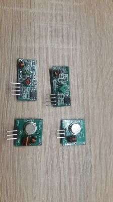

    By the way, I also wanted to ask because it has a couple of these modules.
    Arduino 433MHz RF Receiver & Transmitter Tutorial: Decoding Pilot Codes & Setup Guide Arduino 433MHz RF Receiver & Transmitter Tutorial: Decoding Pilot Codes & Setup Guide
    I noticed that they differ from each other, I wrote to the seller asking why and he replied that this is the next version, but why does this one not read the remote? Someone encountered different versions of this module? Is this a customer divestment?
    The photo at the auction was like this:
    And I got this:

    The problem may be a mod (the remote has a different channel, a different module) or a bad library / remote (different transmission standards). Show what you have at the output of the module when the remote control transmits.

    I also have versions without drawn elements and I have a problem with running the modules, are they working properly for you? Do they work different from the previous version?
