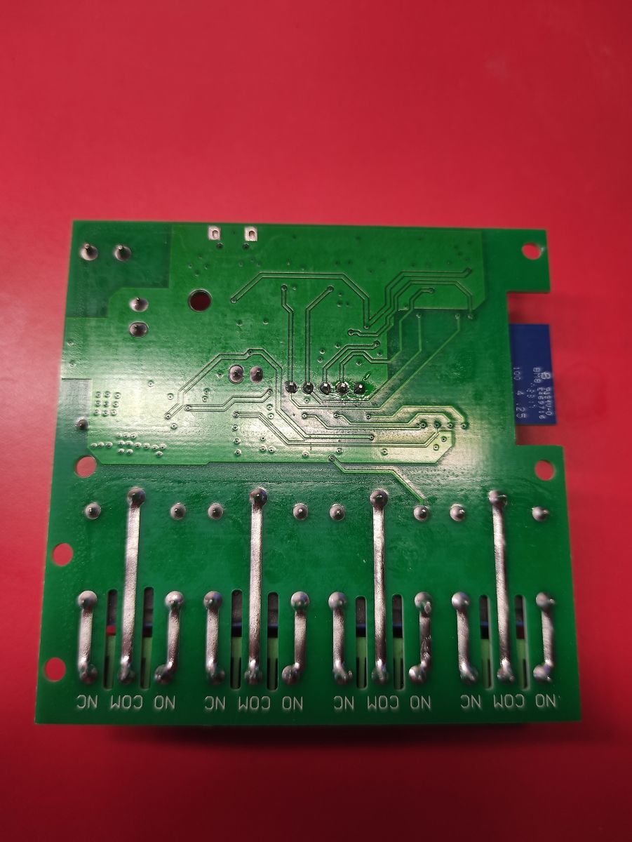

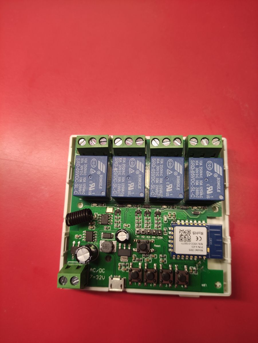

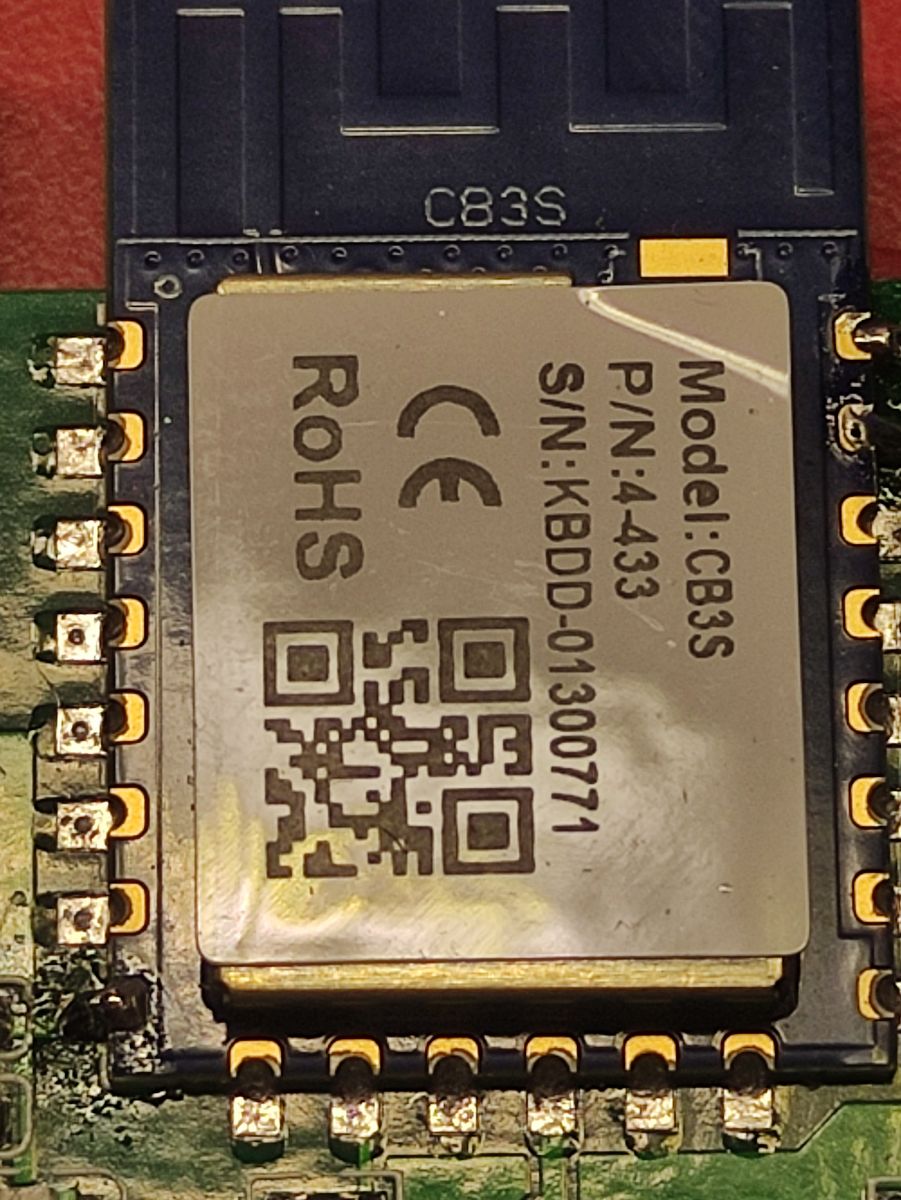

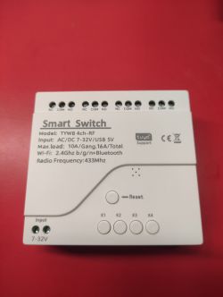

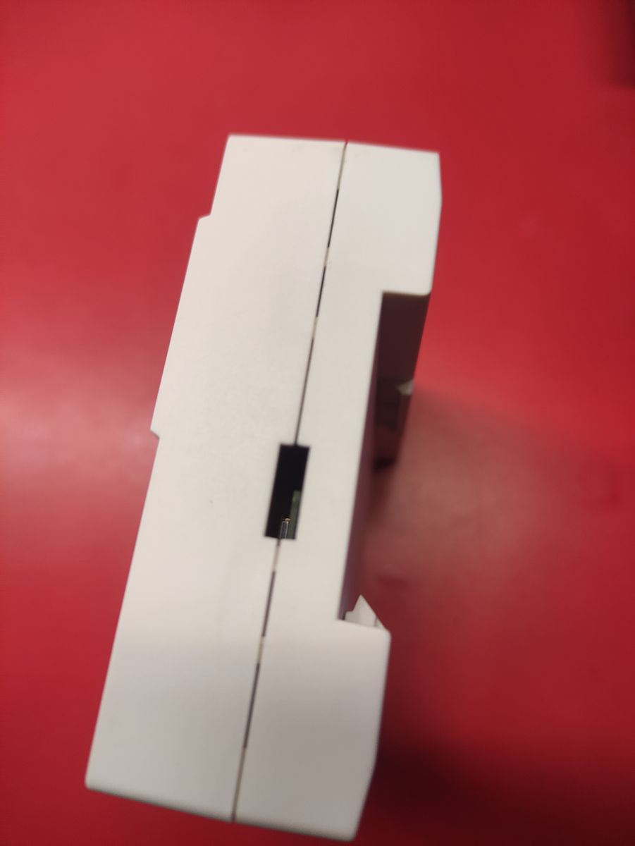

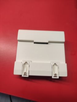

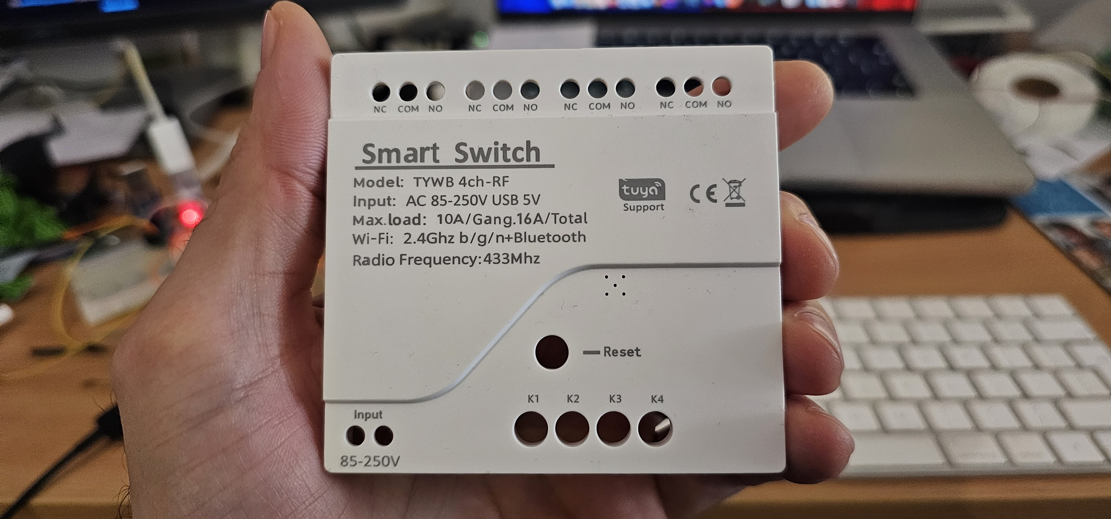

    Hello, I show you the device that I acquired and to which I installed openBK.
    This device comes with 433MHz RF receiver, but I was not able to get it to work with openBK.
    Using 433MHz RF Receiver with OpenBK on Smart Switch 4ch TYWB 4ch-RF Device Using 433MHz RF Receiver with OpenBK on Smart Switch 4ch TYWB 4ch-RF Device Using 433MHz RF Receiver with OpenBK on Smart Switch 4ch TYWB 4ch-RF Device Using 433MHz RF Receiver with OpenBK on Smart Switch 4ch TYWB 4ch-RF Device Using 433MHz RF Receiver with OpenBK on Smart Switch 4ch TYWB 4ch-RF Device Using 433MHz RF Receiver with OpenBK on Smart Switch 4ch TYWB 4ch-RF Device Using 433MHz RF Receiver with OpenBK on Smart Switch 4ch TYWB 4ch-RF Device Using 433MHz RF Receiver with OpenBK on Smart Switch 4ch TYWB 4ch-RF Device Using 433MHz RF Receiver with OpenBK on Smart Switch 4ch TYWB 4ch-RF Device

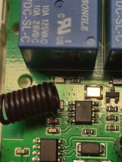

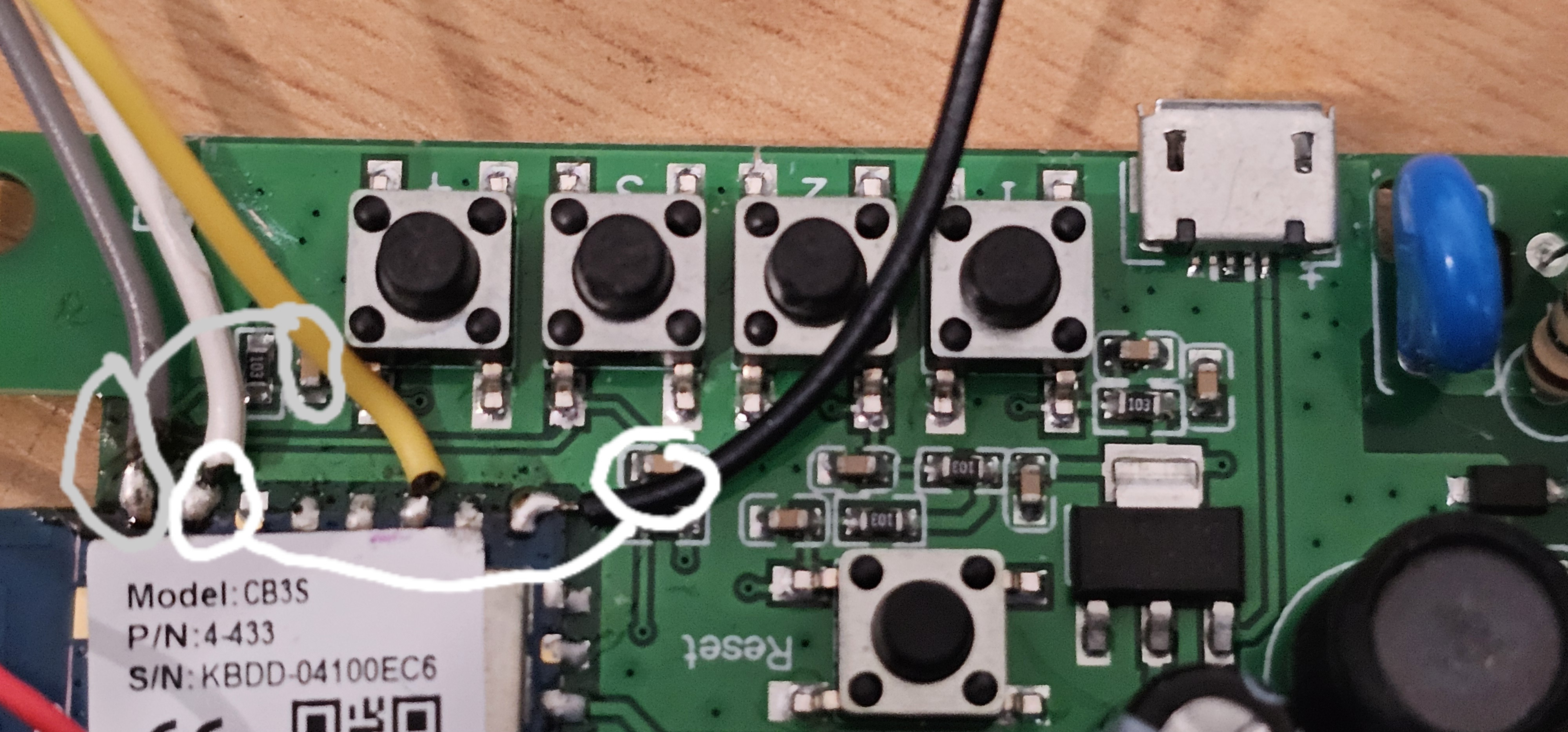

    In this image you can see the 433MHz RF chip.

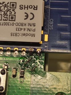

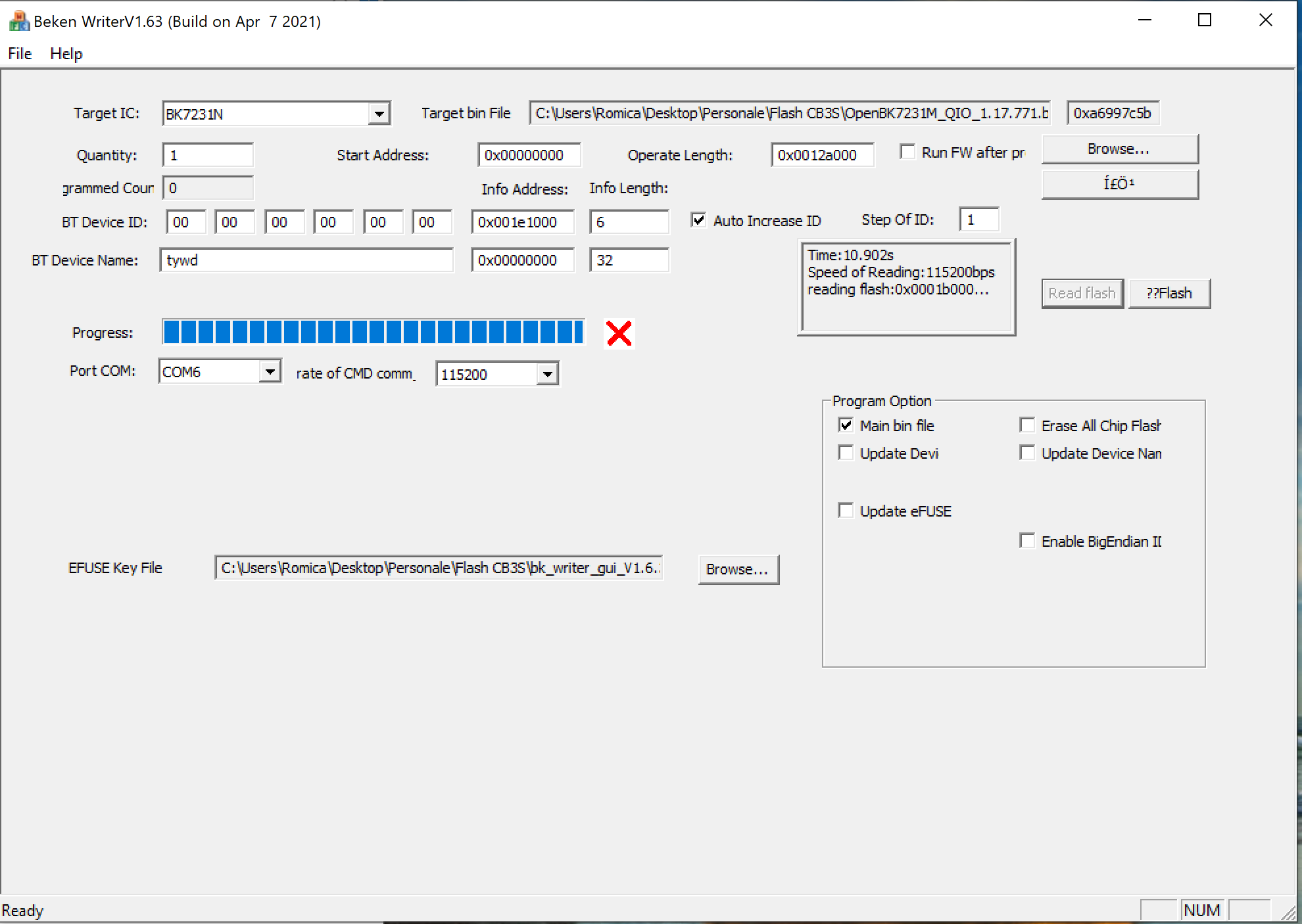

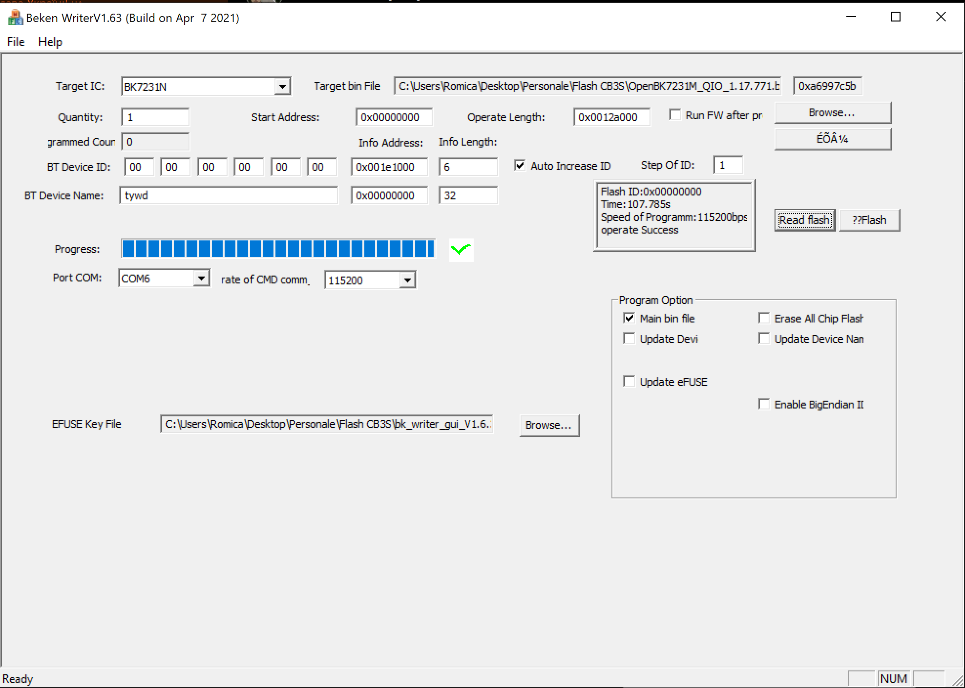

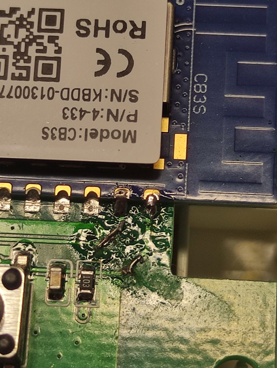

    Here you can see where I made the cut to be able to load the new firmware and then I had to repair it.

    Hello, where is the RF receiver connected? Does it connect to the GPIO of CB3S?
  • #3 20660239
    mbolty
    Posts: 6
    Yes, it is connected to P20. I configured it as a relay to see if when it was put in a high state it entered programming mode. But this didn't work.

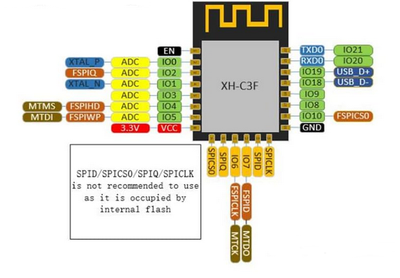

  • ESP12F module swap as workaround
    #5 20990053
    Posts: 14754
    Rate: 12875

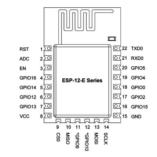

    I don't have this chip right now, but you can easily do swap to ESP12F module:
    Pin diagram of ESP-12-E module
    Here is sample "brain transplant" topic: Replacing the WiFi module with ESP12F (ESP8266) in a smart / tuya device
    Here is a guide for desoldering module with low quality, low power hot air station:
    If your module has two rows of pins soldered, then you can also use soldering iron trick:
    Alternatively you can wait for it to get supported, I'll ping this thread once we support that.

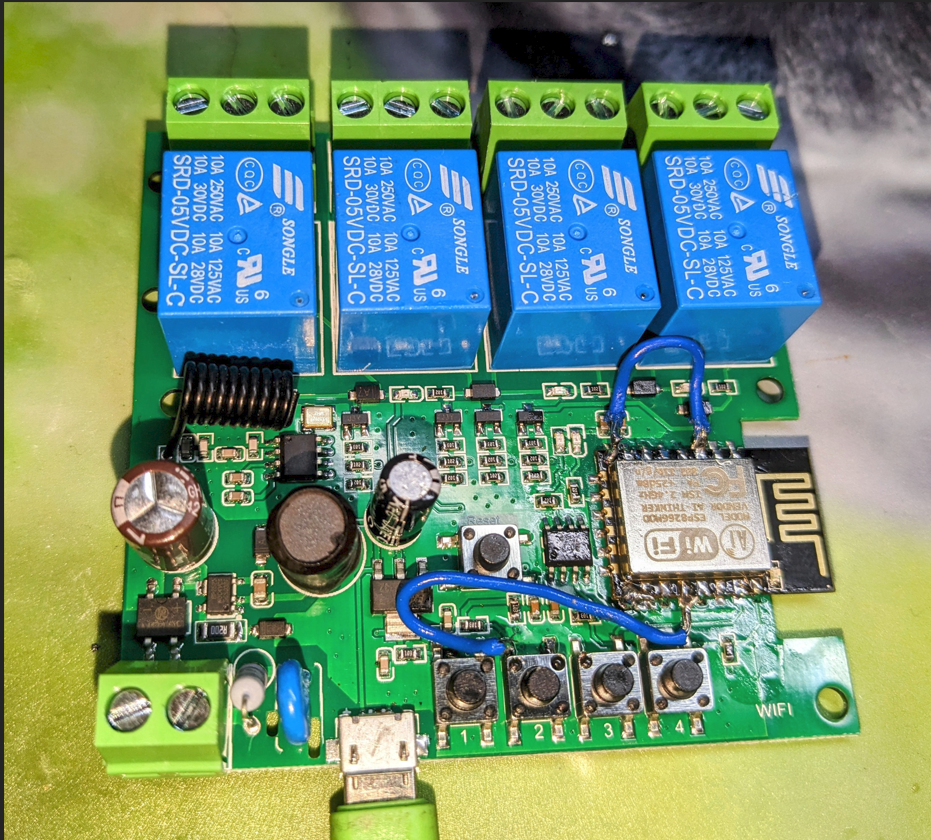

    #6 21011142
    Pete0815
    Posts: 34

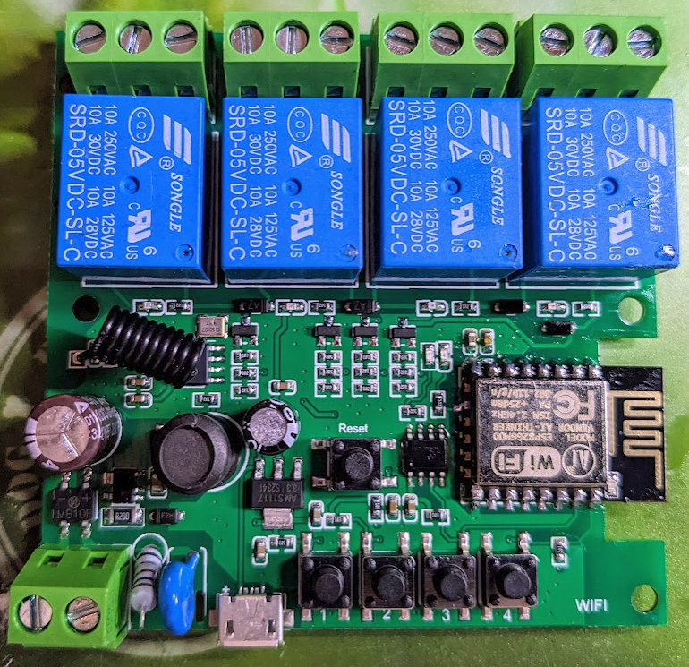

    Thank you very much and tried to replace by ESP8266 12F and like to share my experience.
    Circuit board with ESP8266 module, four blue relays, and other electronic components.
    3 issues by doing a simple 1:1 replacement.
    1) On the board the Pin #3 means Enable (EN) is not pulled to continuous HIGH level (3,3V) which is essential for ESP8266 12F to work. Simple solution put a bridge from 3,3V to this PIN
    2) GPIO15 from ESP8266 12F is not pulled LOW (GND) on this board so the ESP-chip does not boot from Flash. Simple solution bridge GPIO15 to GND
    3) Problem because of GPIO15 is used for Button 4 you have to isolate the soldering pad from the board and GPIO 15 (e.g. put a piece of plastic in between). To make button 4 work again you can bring in a bridge from Button 4 to GPIO 0. This works and in addition you have an option to pull GPIO 0 to LOW (GND) in case you want to flash the chip again (OTA is of course is my preferred solution so don´t need this one).
    bridging Button 4 to GPIO 02 will not work for me because in many cases it´s used for a wifi LED and so there is disturbance.
    Using this confguration, be careful what to use relay 4 for, because GPIO 16 is pulled High during boot and this will shortly switch on/off relay 4 during boot.
    Close-up of a circuit board with an ESP8266 module and four blue relays.
    In addition I tried to make RF function work at GPIO 10 by using Tasmota RF Transceiver Options but no RF signals can be seen in the console. Because of unprinted SOT8 RF chip on my board I´m interested in your experience about this chip and maybe we can find out what it is?
    Thanks in advance
    As example I also found this printed chip but no idea what it is:
    Close-up of an integrated circuit and surrounding components on a green printed circuit board.

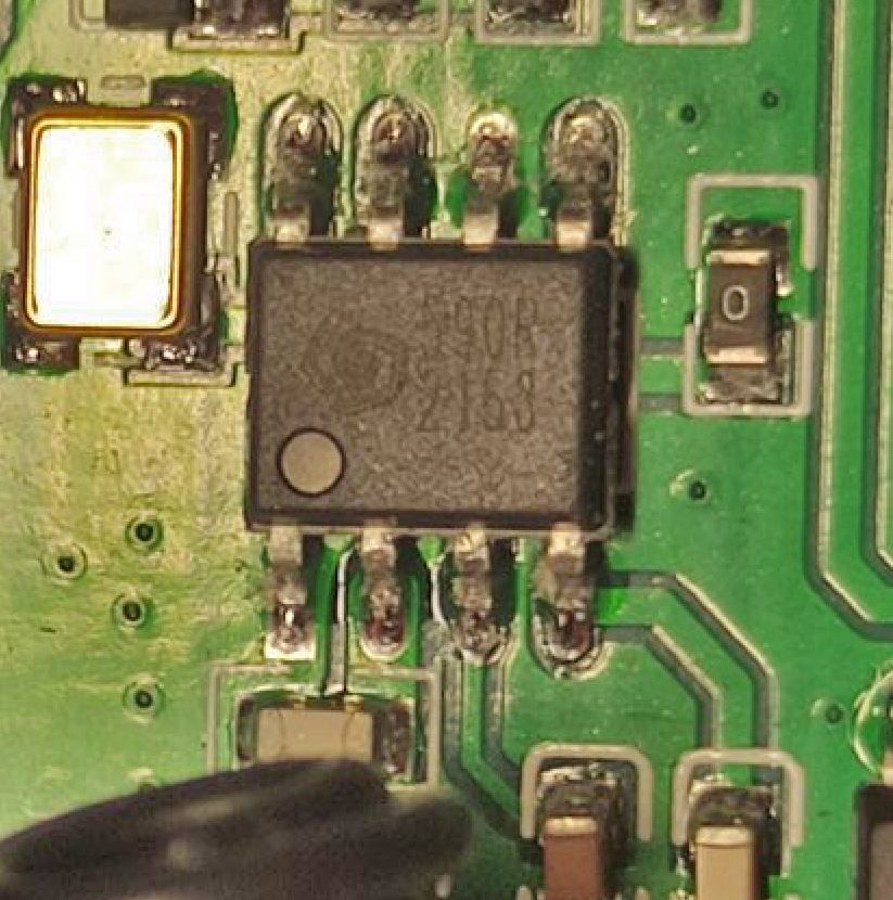

  • Identifying the SYN590R 433 MHz receiver chip
    #7 21011181
    Posts: 5208
    Help: 446
    Rate: 914
    looks like a Synoxo SYN590R RF thingy
    Key Specifications/ Special Features:
    SYN590RD SYN590RL SYN590R
    SYNOXO RF IC electronic component
    SYN590R Features
    ----Frequency range: 300MHz ~ 450MHz
    ----Receive sensitivity: -110dBm (Typical)
    ---- Image Reject Mixer: 20dB (Typical)
    ----Receive bandwidth: 400KHz ~ 600KHz
    ---- Voltage range: 2.6V ~ 5.5V
    ---- Low power consumption: under 5V application
    --Typical 3.5mA (315MHz)
    --Typical 4.6mA (433.92MHz)
    --Typical 0.8uA (Shut Down)
    ---- No AGC capacitor required
    ---- Maximum data rate 5kbps
    ---- RoHS Compliant
    ---- SOP-8 package

    Loose GPIO10 contact fixed RF receiver issue
    #9 21011439
    Pete0815
    Posts: 34
    Thanks for your feedback. Maybe I'm struggling because of GPIO 10 which is connected to Flash on ESP8266.
    Will test with other GPIO and maybe we'll see if RF communication of Tasmota works with this SYNOXO RF chip.
    all tests so far have been done with RfProtocol enabled for Tasmota RF Receiver configuration.
    Will let you know about the outcome of my simple testing.
    Added after 2 [hours] 18 [minutes]:
    Edit:
    ok, done and it works. Testing with GPIO05 instead of GPIO10 leads me to identification of a loose contact at GPIO10.
    So resoldered and GPIO 10 is also fine for RF communication with Tasmota.
    09:30:46.653 RSL: RESULT = {"Time":"2024-03-20T09:30:46","RfReceived":{"Data":"0x5B9xxx","Bits":24,"Protocol":1,"Pulse":374}}
    Hope you can also benefit from this information.

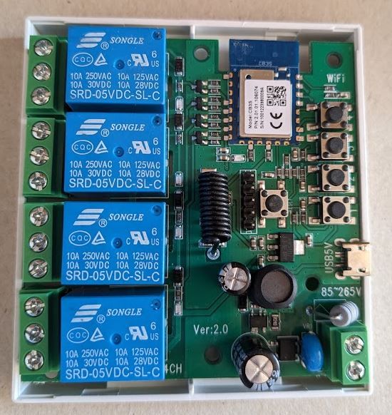

  • GPIO mapping and template for TYWB 4ch-RF v2.0
    #10 21018960
    Pete0815
    Posts: 34
    Hi

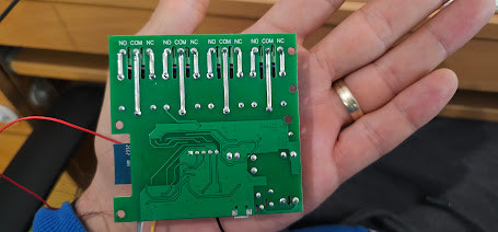

    there seems to be also a Ver.:2.0 available with slightly adjusted board layout now including J3Y NPN transistors for the relays:
    Circuit board with four blue relays and electronic components.
    and also slightly different housing:
    Wi-Fi smart switch model DIY-AC04-TY
    Edit:
    GPIO Assignment figured out based on ESP8266 12F:
    Button1: GPIO15 (not to be used for ESP8266 I used GPIO0 instead)
    Button2: GPIO05
    Button3: GPIO03
    Button4: GPIO01
    Button5(Reset): GPIO04
    Relay1: GPIO13
    Relay2: GPIO12
    Relay3: GPIO14
    Relay4: GPIO16
    RF_Receiver: GPIO10
    Wifi_LED: GPIO07 (unconfigured)
    To make it easy use template:
    {"NAME":"4ch-RF","GPIO":[64,67,0,66,1,65,0,1152,225,224,226,0,227,0],"FLAG":0,"BASE":18}

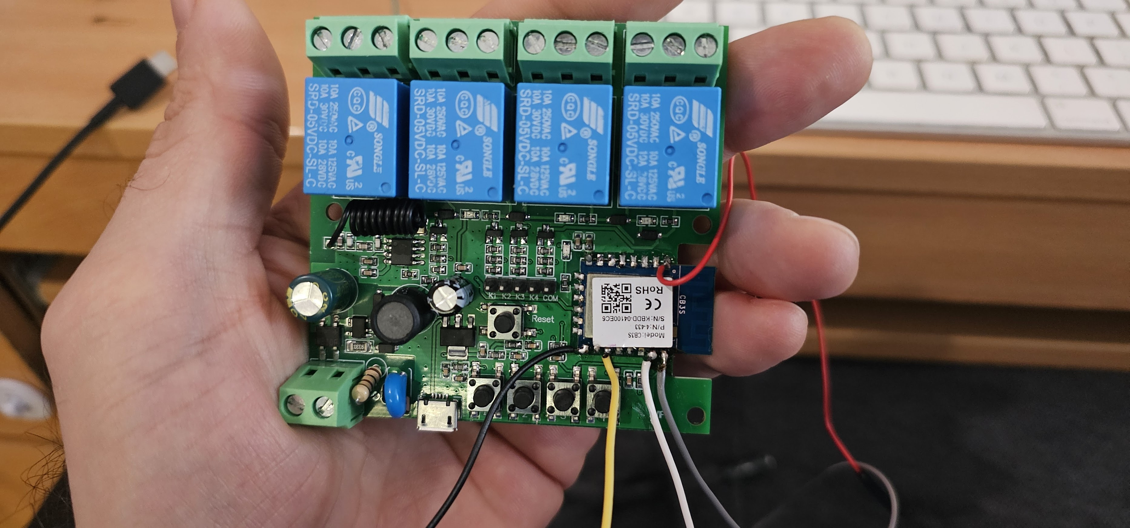

    #11 21310939
    iarcaromica
    Hi,
    I'm new in OpenBK and flashing Tuya chips. So please be patient with me, I would like to flash my TYWB 4ch RF, but I encounter issues. Please see below some pictures with the device.
    I have wires connected to the following pins:
    GND - black
    TXD1 - gray
    RXD1 - white
    TXD2 - yellow
    From the documentation here: https://developer.tuya.com/en/docs/iot/cb3s?id=Kai94mec0s076
    GND is reference ground
    TXD1 is UART1_TXD - connect to RX pin of my USB to TTL convertor
    RXD1 is UART1_TXD - connect to the TX pin of my USB to TTL convertor
    TXD2 is UART2_TXD (used to display the module internal information), which corresponds to P0 of the IC
    The issue is that I have no output when I have connected the USB to TTL convertor TXD1 and RXD1 (so I cannot write the firmware)
    If I connect TXD2 to the RX pin of my USB to TTL convertor, I can see some debugging output.

    Can anyone help me with this? I also tried to reset the device by shorting the RED wire to the GND, but I cannot see anything on TXD1
    Thank you!

  • Remove UART capacitors to flash the device
    #12 21310965
    Posts: 14754
    Rate: 12875
    You don't need to see anything on the TXD1 in order to flash with our tool:
    However, I remember @ArturAVS showing me this device and I think it has capacitors on RXD1 and TXD1, which are also used for buttons. Those capacitors most likely will have to be removed. You don't need to put them back.
    I've already had similiar issue here:
    Watch whole video, we were not able to flash the device until we removed capacitor from the UART pin which is also used for button.
  • #13 21311022
    iarcaromica
    It looks like with the multimeter in diode mode (beep mode) I found direct link from TXD1 to Grey marked capacitor and from RXD1 to white marked capacitor (see attached photo). So I should just remove them and it no need to add back after I finish (it will work fine after that, or is just a noise cancel capacitor).
    Thank you!
    • Using 433MHz RF Receiver with OpenBK on Smart Switch 4ch TYWB 4ch-RF Device 20241120_134046.jpg (1.34 MB) You must be logged in to download this attachment.
  • BK7231 backup works with Easy UART flasher
    #14 21311169
    iarcaromica
    >>21311022

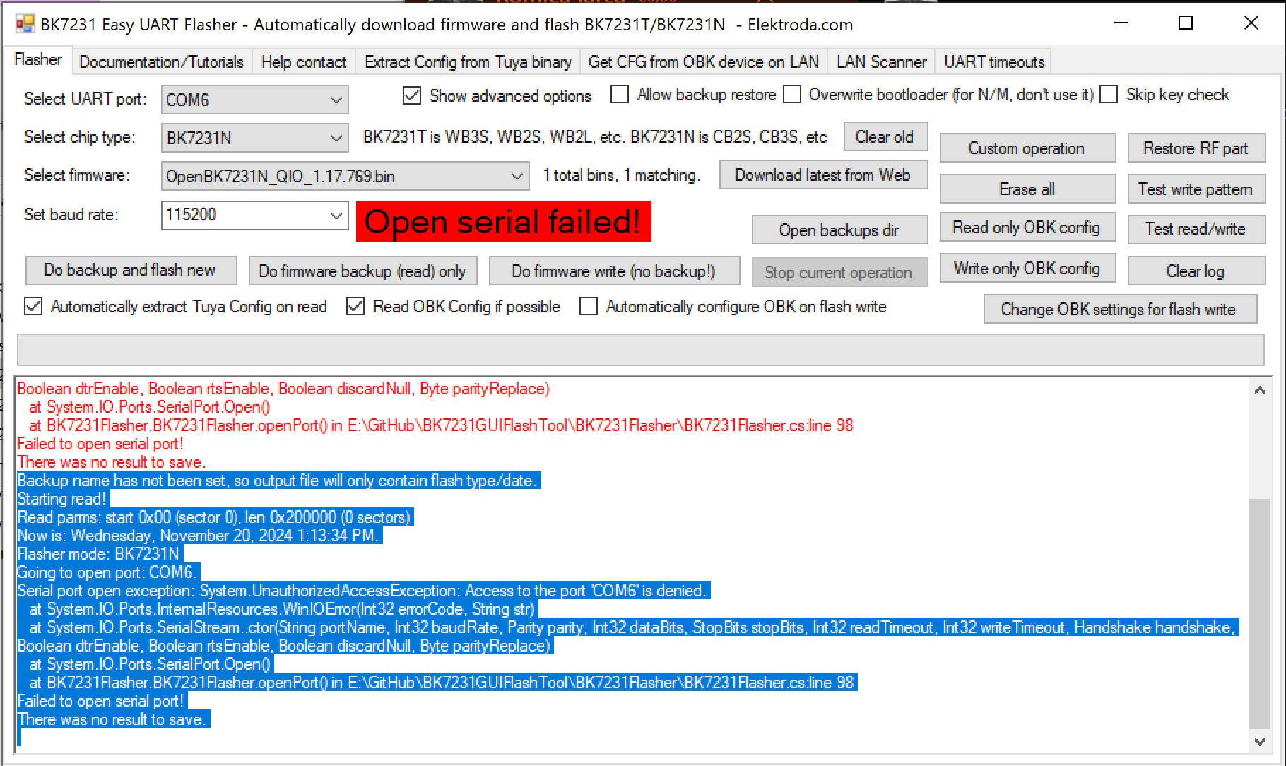

    I have removed the capacitors and also the resistor nearby. When I press Do firmware backup, I receive the error
    Backup name has not been set, so output file will only contain flash type/date.
    Starting read!
    Read parms: start 0x00 (sector 0), len 0x200000 (0 sectors)
    Now is: Wednesday, November 20, 2024 1:13:34 PM.
    Flasher mode: BK7231N
    Going to open port: COM6.
    Serial port open exception: System.UnauthorizedAccessException: Access to the port 'COM6' is denied.
       at System.IO.Ports.InternalResources.WinIOError(Int32 errorCode, String str)
       at System.IO.Ports.SerialStream..ctor(String portName, Int32 baudRate, Parity parity, Int32 dataBits, StopBits stopBits, Int32 readTimeout, Int32 writeTimeout, Handshake handshake, Boolean dtrEnable, Boolean rtsEnable, Boolean discardNull, Byte parityReplace)
       at System.IO.Ports.SerialPort.Open()
       at BK7231Flasher.BK7231Flasher.openPort() in E:GitHubBK7231GUIFlashToolBK7231FlasherBK7231Flasher.cs:line 98
    Failed to open serial port!
    There was no result to save.
    When I run the Beken writer and hit the Read flash, it looks fine and it manages to get the flash (see the screens attached)
    LATER EDIT:
    I've managed to backup the firmware with your BK7231 Easy UART flasher. I'll come back soon as I try to push the new firmware.
    LATER EDIT 2: I've managed to flash the device. Is there any page where you can add the steps like a tutorial for others, or I should put here full steps that I followed. Thanks!
    Best regards!

    • Using 433MHz RF Receiver with OpenBK on Smart Switch 4ch TYWB 4ch-RF Device image_2024_11_20T13_21_15_601Z.png (82.23 KB) You must be logged in to download this attachment.
  • ESP32-C3 pin mapping and pullups for TYWB board
    #15 21438630
    rainerrmn
    Level 4  

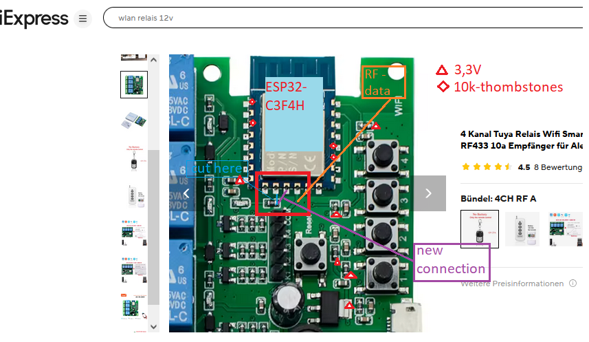

    I use an ESP32C3 in 12F-board like ESP32-C3FH4 from sparkle or aliexpress:
    ESP32-C3F pinout diagram with GPIO labels and pin functions.
    I flashed the ESP32C3F before installing, because you can not use UART0 or the USB D+/D- in the TYWB-board.
    Next step of preparision is to mount/weld 4 resistors as thombstones on the ESP. This ESP-Modul need 10k-pullup on GPIO8, GPIO9, GIO2 and EN/RST to boot from flash in this TYWB-board. On the TYWB these pads are empty.
    After removing the original CB3S i cut a wire between the signal-LED-resistor an the pad No. 18. After mounting the ESP32C3F, i made a connection to the pad No.19(GPIO6) instead.
    On the left side of ESP, there are 3.3V for the tops of the thombstones at EN (pad no. 1) and GPIO2 (pad no. 3) at pad No. 8 or at an capacitor nearby this pad.
    On the right side of the ESP, there are 3.3V for the tops of the thombstones at GPIO8 (pad no. 11) and GPIO9 (pad no. 12) nearby at the pullup-resistors for the buttons or at the votage regulator.
    ESP32-C3FH4 board with connections and labels on a relay module.
    RF is a SYN590 at GPIO7 (pad no. 20)
    Ledlink_i is at GPIO6 (pad no.19)
    GPIO18 (pad no. 13/USB-), GPIO10 (pad no. 10), GPIO20 (pad no. 15/RX0) and GPIO21(pad no.16/TX0) are button_n 1..4. Internal is a connector with COM/GND and this 4 Pins.
    ATTENTION: there is no galvanic isolation to the mains. With this knowledge, i remove the USB-Connector from the TYWB-board, so nobody can touch the mains-connected metal house of this connector. This connector is only for 5V-supply must strongly not be used, when mains connected.
    At GPIO19(pad no.14/USB+) is a button_n with "RESET"-label.
    GPIO1(pad no. 4), GPIO3(pad no. 5), GPIO4(pad no.7) and GPIO5(pad no. 6) are relay-outs. Each of them uses a transistor for driving the relais and a hard-connected signal-led. This signal-leds are useless, wenn the TYWB-board is in the case. If you want to use/see them with the controlled relais, you have to drill holes in the case over these leds.
    GPIO0, 2, 8, 9 (pads no. 2, 3, 11 and 12) are not used. same with th EN/RST at pad no.1.
    I want to use this modul in a kitchen hood. the fan has 3 wires to select the speed and one wire is for the light. Later, i want to use the free GPIOs with a cheap thermal cam, a DHT11 or something like smoke-detector or fog-detector for automation. But for the first trial, i am fine with the "alexa"-matter-connect to my firetab in the kitchen. The ESP32C3 supports "matter" and in the tasmota-matter-config is a virtual fan endpoint, thats fits perfect for this.
  • #16 21448024
    rainerrmn
    Level 4  
    There is another name for a similar module: TYWB-4ch rf and TYWD-4ch rf. The difference between these modules is the supply voltage(AC-mains or low voltage-DC).
    The Beken CB3s, the rf SYN590, the 4 relays and buttons, the gpios used and all this are the same with these modules.

  • Cut traces to isolate noisy RF receiver lines
    #17 21582005
    spleefer90
    Posts: 17
    I ended up just cutting the traces in the end, desoldering everything did not do it for me - it still leads to the pin header and I presume that one still has noise - I desoldered the brown(?) and black(10k resistors) components and the two buttons to no avail, thankfully I managed to put everything back.
    I did not think and I melted the plastic cover with hot air on one of my switches.
    Note that one of the pictures around the forum has the wrong RX/TX marking - refer to docs - https://developer.tuya.com/en/docs/iot/cb3s?id=Kai94mec0s076 - 15 RX; 16 TX

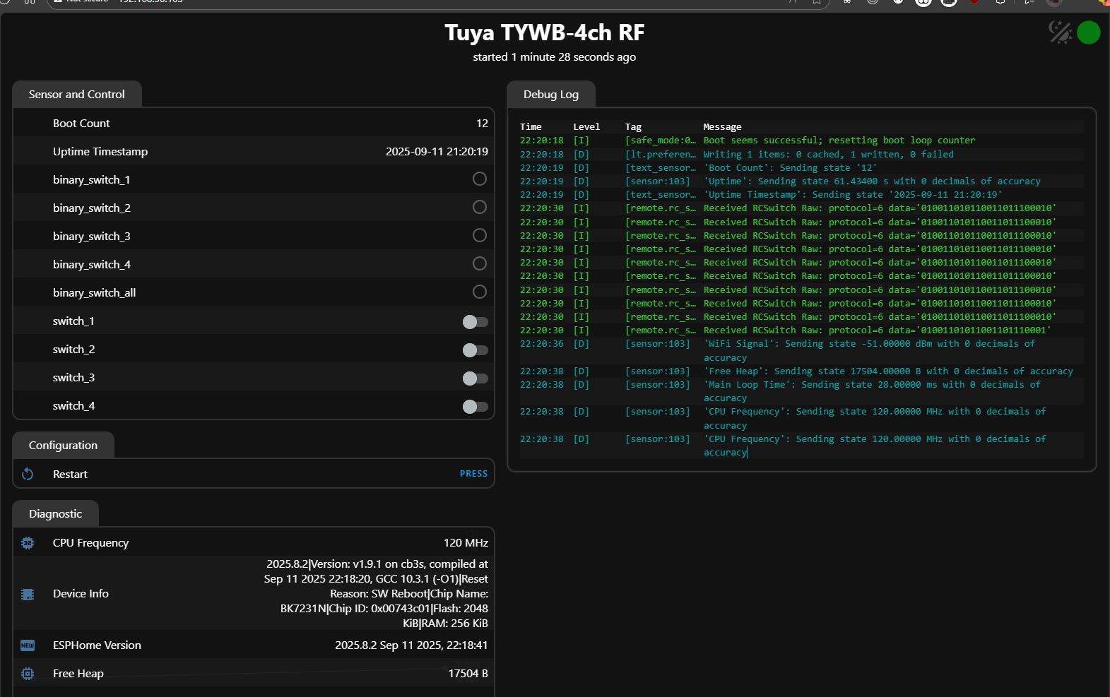

    neilflatley
    For anyone who has flashed the original CB3S module, the RF receiver is connected to P20. You can check continuity between P20 and pin 8 on the 590R RF chip. I have used ESPHome and can confirm I am receiving the RF signals in ESPHome console
    Tuya TYWB-4ch RF interface with debug logs and binary switch controls
  • #19 21771735
    andersonv
    >>21687552
    Hi. I'm having trouble making ESPHome work in the CB3S module for this device.
    Do you have some tips or references so I can make it work as you did?
