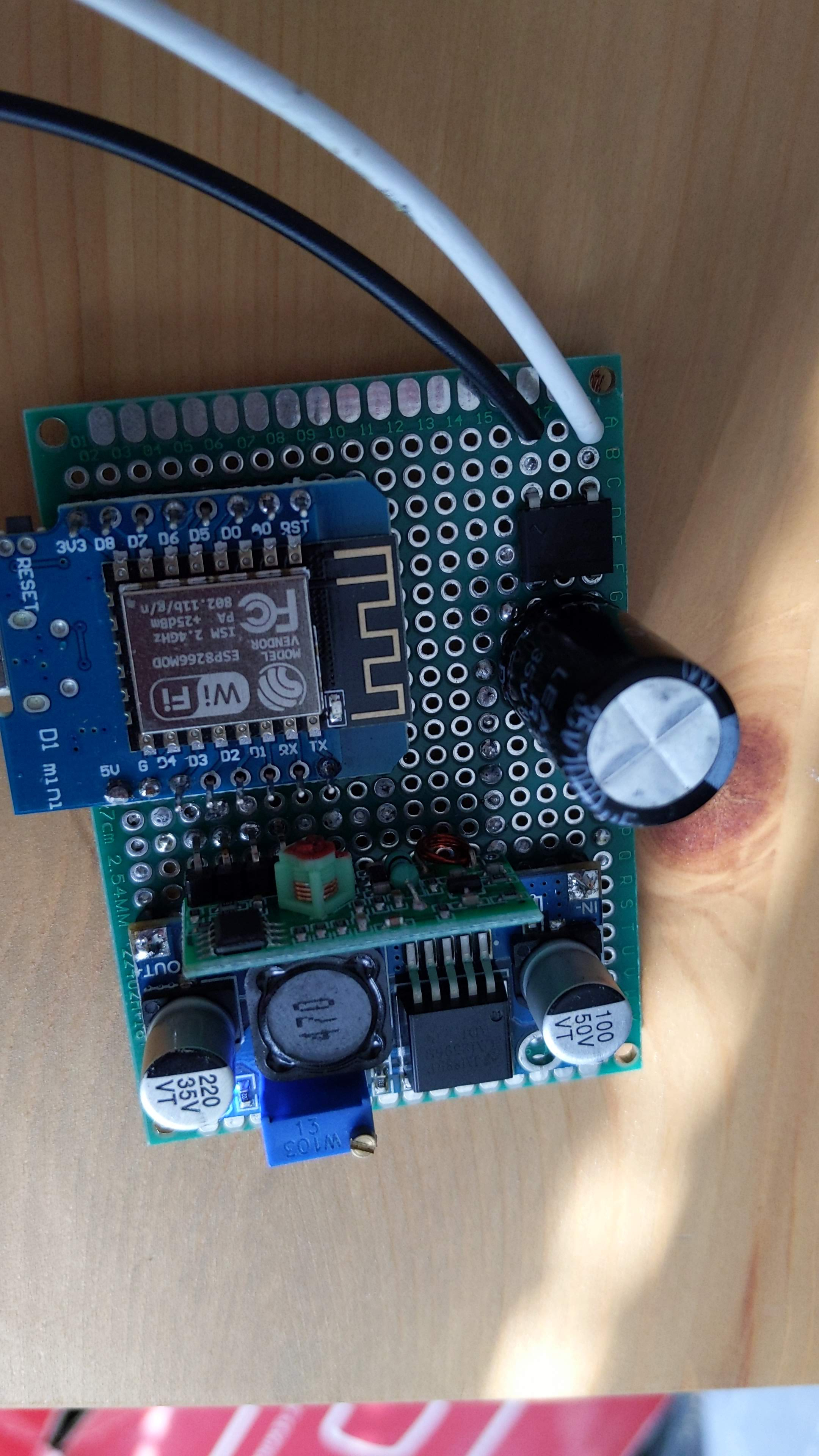

    I have made the board and have everything after connected. First comes the 4 channel 433MHz radio module and then the wemos d1 mini. The libraries are installed and everything is working because I am able to connect to the wifi or light up the LED. However, I don't know how and I've been looking and trying for 2h+ and I still don't know how. When I press the button on the remote control then the radio module receives data and transmits it to the wemos d1 mini. Just how to receive this data? I have tried :
      Example for receiving
      https://github.com/sui77/rc-switch/
      If you want to visualize a telegram copy the raw data and
      paste it into http://test.sui.li/oszi/
    #include <RCSwitch.h>
    RCSwitch mySwitch = RCSwitch();
    void setup() {
      Serial.begin(115200);
      mySwitch.enableTransmit(4);  // Receiver on interrupt 0 => that is pin #2
    void loop() {
      if (mySwitch.available()) {
        output(mySwitch.getReceivedValue(), mySwitch.getReceivedBitlength(), mySwitch.getReceivedDelay(), mySwitch.getReceivedRawdata(),mySwitch.getReceivedProtocol());
        mySwitch.resetAvailable();
    However, nothing happens.
    This is what my board looks like:
    How do I receive data from a remote control on a Wemos D1 Mini with a 433MHz RF module? How do I receive data from a remote control on a Wemos D1 Mini with a 433MHz RF module? .
    And I have no idea why it doesn't work. The power supply is 5v, it now flies via usb as you can see by the stepper down the board is powered.

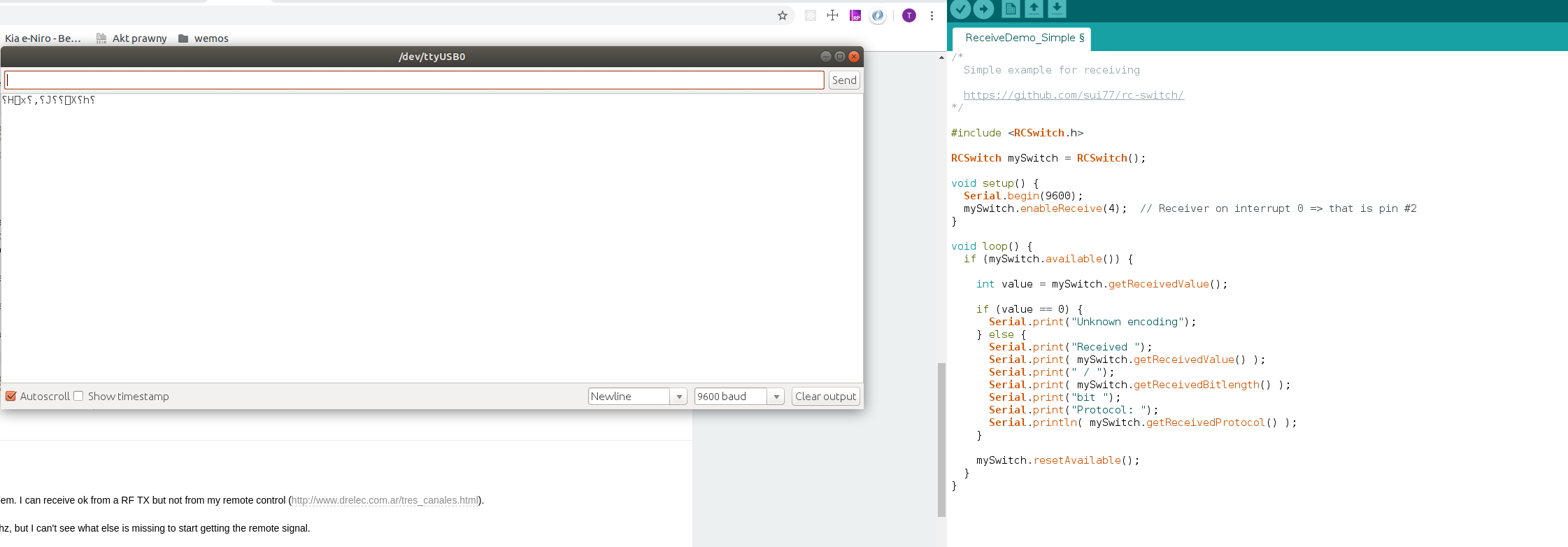

      Simple example for receiving
    void setup() {
      Serial.begin(9600);
      mySwitch.enableReceive(4);  // Receiver on interrupt 0 => that is pin #2
    void loop() {
        int value = mySwitch.getReceivedValue();
        if (value == 0) {
          Serial.print("Unknown encoding");
        } else {
          Serial.print("Received ");
          Serial.print( mySwitch.getReceivedValue() );
          Serial.print(" / ");
          Serial.print( mySwitch.getReceivedBitlength() );
          Serial.print("bit ");
          Serial.print("Protocol: ");
          Serial.println( mySwitch.getReceivedProtocol() );
    This is another example I found from this library but in general most of these queries return some weird bushes in the serial monitor and so I have Serial.begin the same as baud in the serial monitor How do I receive data from a remote control on a Wemos D1 Mini with a 433MHz RF module? .

    kaimaz
    Posts: 37
    @khoam as you can see from the printscreen when I have 9600 set it here and here and when 115200 set it here and here :) .

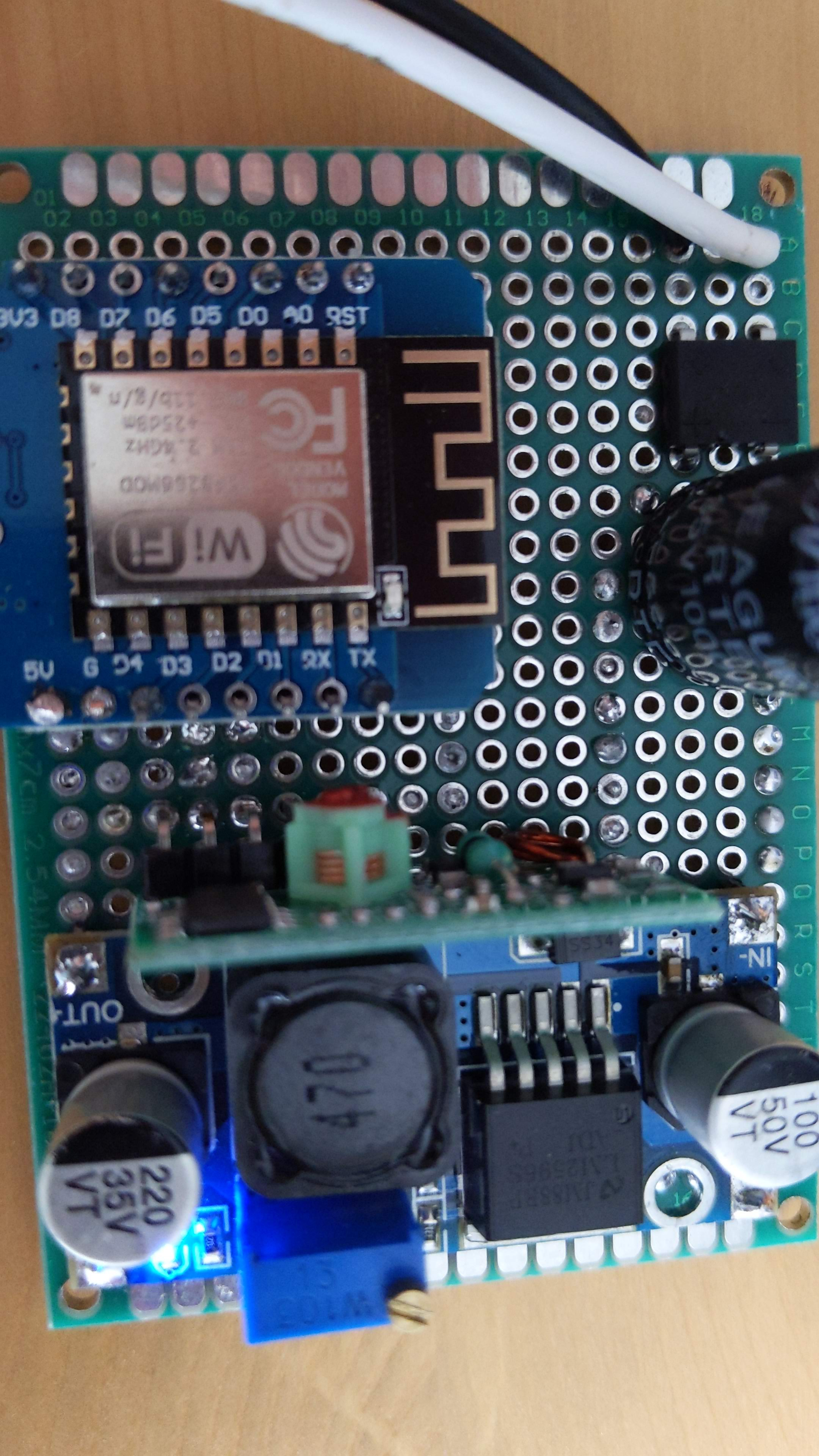

    In general, on my board the current goes through the RF module at 5V, and then it goes to the Wemos at 5V. And when I want to connect to the wifi it works, and the test flashing light too. Unfortunately I can't receive data. My RF receiver has two data and I connected one to D2 and the other to D3.
  • #12 18145162
  • #13 18145174
    kaimaz
    Posts: 37
    but generally when I put the meter to the data pins on the transmitter there is no voltage at all when I press the button on the remote control, so I thought there was no current there?
    Added after 13 [minutes]:
    I have this one and now there is 5V going to VCC at my place.
    GND goes to GND
    DATA 2 goes to D2 and DATA 3 goes to D3
    Then from VCC goes from Wemos d1 mini 5v and GND to GND
    Do you think to unsolder and give a resistor between DATA 2 and D2?
    And interesting that when I check the voltage on DATA2 and GND with a meter it doesn't show anything when I press the button on the remote, is this normal?
  • #14 18145330
  • #15 18145535
    kaimaz
    Posts: 37
    I don't exactly have such a resistor. I have 1k, 4.7k and smaller
    Because this diagram I don't know how to apply to me. I have unsoldered DATA2 and DATA3 and 5V goes to VCC and to 5V in d1 mini and GDN goes to GDN and then to GDN in d1 mini. If I put a resistor there for example from DATA2 to D2 on the d1 mini is that enough? and which one to use?
