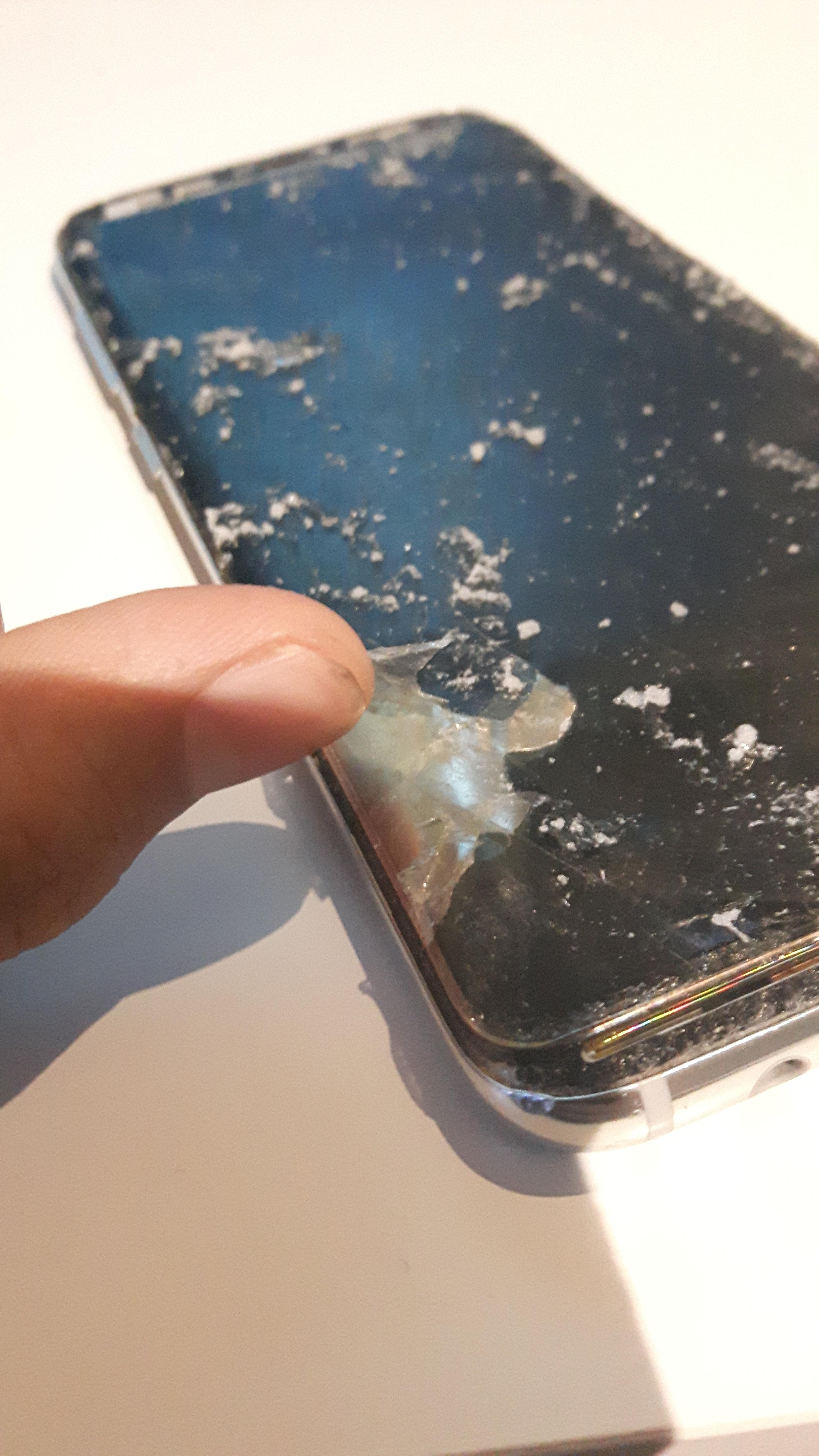

    I exchanged the pane in my samsung and at the beginning everything went well and at the end as I undermined the glass detached me a little polarizer (I think polarizer) I do not know if it is a touch or how but under this black foil is only a plaque or perhaps a display. Can someone tell me what it can be? Let's have a polarizer because it's cheap. I need a quick answer.

    If you do not upload photos, it will be hard to deduce from the description.

    I am already sending, and as to the display, I do not know what else I could spoil because the phone turns everything on, the diode shines only there is nothing on the display.

    If nothing is showing, it's a simple thing, you've damaged the display and it's for exchange.

    Are you sure?
    how could I damage if I removed only the glass .. Maybe too high temperature?
    And as for the polarizer I found it for PLN 5 for only the one I took off is rounded and the auction is rectangular. I will try to order and glue, we'll see maybe it will work ...

    If you have sounds and vibrations and the screen is dark, you have 100% to exchange the entire display and the polarizer will not give you anything.

    could it just get damaged? : /

    If you have not had experience with exchanging glass in phones and started with s8 in which the display is very thin and delicate it is almost certain (especially if you have such symptoms, you describe the black screen).

    Everything indicates that you damaged the display.
    You tried your hand because you probably saw on the youtube that it's so easy :) ?

    Yes :D At the beginning there were all gites only at the end at this edge somehow dug in, and now 1000 zlotys not mine; P
