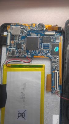

    Hello!
    I need the firmware for the tablet given in the topic. Here is a photo of the motherboard with its model.
    Seeking Firmware for Polaroid MID1047PCE03.112 Tablet - Motherboard Images Included

    The tablet on the back of the housing has some markings, send a photo.
    Or if you want to check it here
    Write down a description of these elements or take a picture of this page so that you can see what is written on them. Clean the glue.
    What symptoms do you have ?
    Did you go into recvery mode, did wipe options?
    From what I can see the motherboard is BRD-86V-4354ACAD
    Just like in Pentagram Eon Prix 2 and it's even you that topic you assumed something you shoot once this tablet is a pentagram and once a polaroid make up your mind

    My mistake, I gave the wrong CD photos - like you say I gave the CD photos from the pentagram. My mistake
    The motherboard is marked YK98VQ-RK3126-V2.1
    On the back of the case
    MODEL: MID1047PCE03.112
    SN: DG15BL006011942
  • #5 17114781

    I installed this software, now the screen is black and lit all the time.
    You asked earlier what my symptom was - it hung on the Polaroid log, in recovery it did not want to enter.

    Hello, I forgot about this tablet, so from the beginning.
    It hung only over the Polaroid logo and no other reaction. I have uploaded the software given by nutergsm from this link
    http://www.firmware1.com/2017/02/yk98vq-rk3126-v21-firmware.html
    when turned on, the tablet now only has a backlit screen and nothing else.
    I am inserting the correct photos of the motherboard, because those in the first post were photos of another tablet inserted by my mistake.
    Seeking Firmware for Polaroid MID1047PCE03.112 Tablet - Motherboard Images Included Seeking Firmware for Polaroid MID1047PCE03.112 Tablet - Motherboard Images Included

    nutergsm wrote:
    The firmware that I gave corresponds to the markings on the disc.
    Yes, I know, it is exactly the same, I tried to upload several times and the tablet only lights up the screen after starting and nothing else.

  • #15 17175503
    Noixer
    Posts: 145
    Rate: 13
    karolnbox works :) thanks a lot, as it is described the camera does not work but it is not important in such a tablet.
