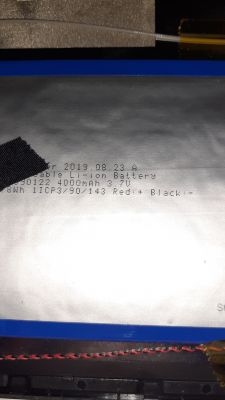

    Dear everyone!
    I'm here to get help with a serious problem. My mom's Selecline tablet gets an infinite loop error. The tablet can turn on, off, but never leaves the boot up screen. I figured out the only way to save the tablet is to reinstall firmware and restart as "factory reset". I know how this works with mobile devices, but this tablet doesn't have Volume or home buttons, so the only solution is to reinstall firmware. The only problem I can't find out what is the firmware number I need for it. This is why I ask for help. I'd be really grateful if someone can help, upload or even give a link where I can get a good firmware for this tablet. I made screens from every part, and put here every info I have. But I'm really not a tech guy. Thank you for any help in this!
    I get this with code reader, not a link:
    PA190615002I0600-M1528I-02R|190722|396
