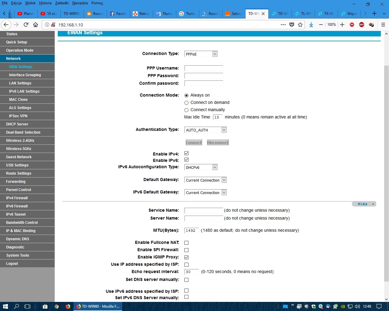

    I put on an optical fiber with Orange. I want to have my router so I have my cousin but I don't want to buy a new one. Can my TP-Link W9980 router without a WAN port be used to connect to ONT and log into the network? Because if not, e.g. TP_Link Archer C7 with WAN port I will have to buy it because then I would have an eye as a last resort.
    Maybe in diffrent way:
    Well, I have an old router that I used as a modem for the VDSL neostrada. TP-Link W9980 but it doesn't have a WAN port. I understand that it is not suitable for connection under ONT. If it doesn't work, will the Archer C7 with WAN work?

    Yes, I have this tab. It has xDSL mode and Wireless router options. I know it should be a Wireless Router. But then in the PPPoE login settings there is an option with the choice of ADSL or VDSL. There is no other choice. Unless he skips it then.

    With Wireless Router MOde you should have full WAN port configuration from Dynamic IP through Static IP to PPPoE which is not necessarily an ADSL protocol.

    Operation mode> Wireless Router Mode

    Great, but you still have to set VLAN ID 35 to make it move, and I don't know if this router has it.

    No, but it doesn't :( . When set to Wireless Router Mode, the option to select VLAN ID disappears. I pitole. I will break down.

    I don't understand something here. You have a fiber optic modem from your provider, you only have internet so why do you need VLANs ??? You connect the modem to the WAN port of the router and configure instead of PPPoE Dynamic IP to Tp-link in WAN Settings,

    You don't know the situation. This is Orange Fiber Optic and it has this terminal, ONT or what it is called there, and it requires PPPoE and VLAN 35.

    I have already purchased the Archer C1200, I hooked up and runs super-cool :) :) On TP-LINK W9980 it didn't go because it doesn't have VLAN on the WAN port.
