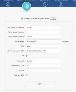

    I am the unhappy owner of a standard Sagemcom router included in the fiber optic package from T-mobile. The problem is that the router has blocked port forwarding, bridge mode and removed the GUI. I need help configuring the TP-Link Archer A6 AC1200 router. I learned from the technicians that the protocol is to be PPPoE, the router is to support VLAN and be in the 802.1Q standard. I couldn't google anything sensible about it, I tried to follow the advice given by the tech department and nothing worked. I am thinking about replacing the firmware in a private router. I already tried PPPoE in the panel, I set the VLAN ID to 35 as they mentioned, but apparently I must be doing something wrong. Has anyone had a similar experience and wants to share a solution to the problem?
    Photo in this post:
    https://www.elektroda.pl/rtvforum/topic3735950.html#19007598

    The problem is that despite following the photo in the post and the suggested hints in the thread https://www.elektroda.pl/rtvforum/topic3735950.html, the router is still not connected to the network. The device supports VLAN and connection via PPPoE, user data is also correct because after connecting it collects the IP address. After a few tries, I managed to get a connection to the network in the router, but it was described as a poor network. It supposedly allowed me to talk on ts3, ping and tracert also returned the IP. Any other action, such as turning on the e-mail, was not possible.

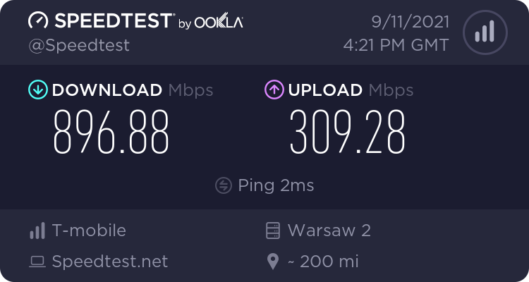

    If you only care about port forwarding, replacing the router in T-mobile will not help you in this matter, until you get a public IP from them, because you have a private IP as standard, and they do not have a public IP service in FTTH, without writing a complaint etc., I won such an IP from them after a few months of "battle".
    And getting back to the topic more, I have a Huawei AX3 Quad Core and the internet runs smoothly without a problem bypassing their router, on the data given above.

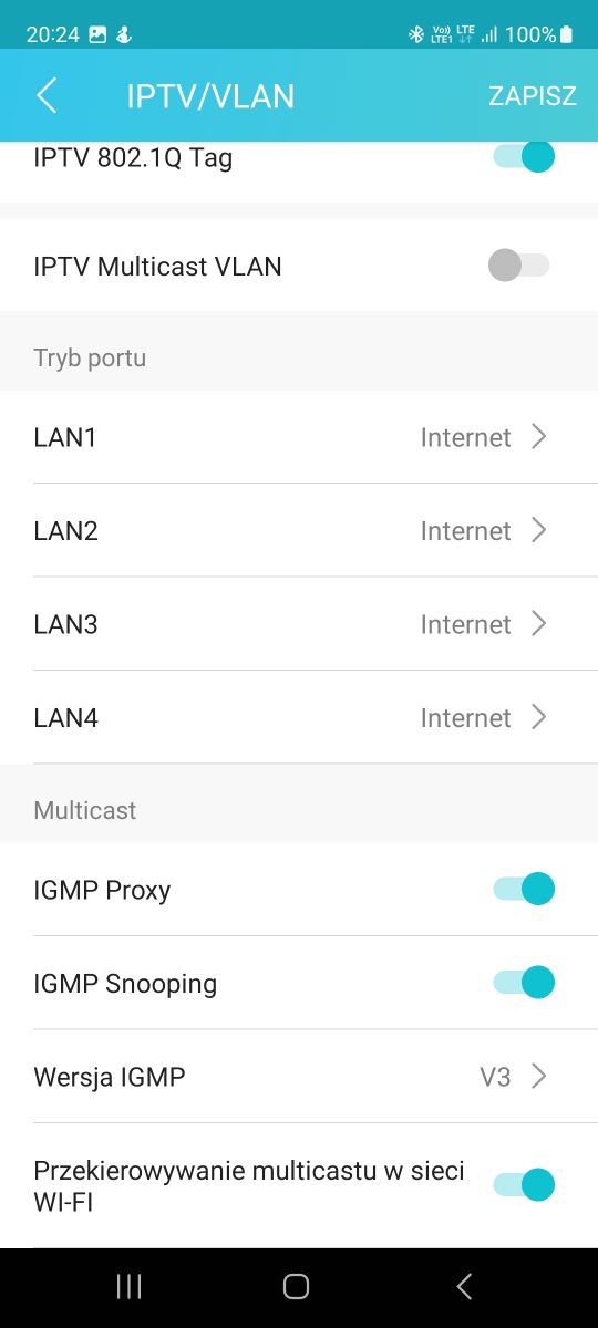

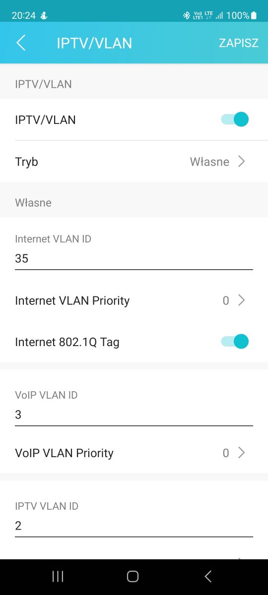

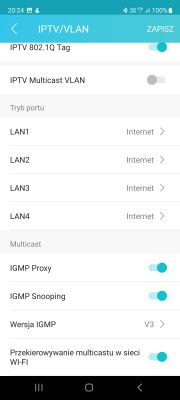

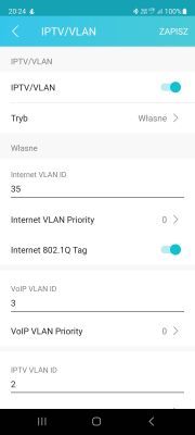

    Hello, I have fiber optic internet from T-Mobile recently. I wanted to change the router to the purchased TP-LINK ARCHER AX1500, I set everything as it should be, but the speed is only 75Mbps both on 2.4GHz and 5GHz. I don't know what the problem is. IPTV/VLAN configuration screen in the TP-Link app on a smartphone, showing different VLAN IDs for internet, VoIP, and IPTV. TP-LINK router IPTV/VLAN setup screen showing LAN port and multicast settings.
    I have VoIP VLAN ID and IPTV VLAN ID in my configuration, I don't know what to put in these fields and I can't leave them empty. Please help me solve the problem.
