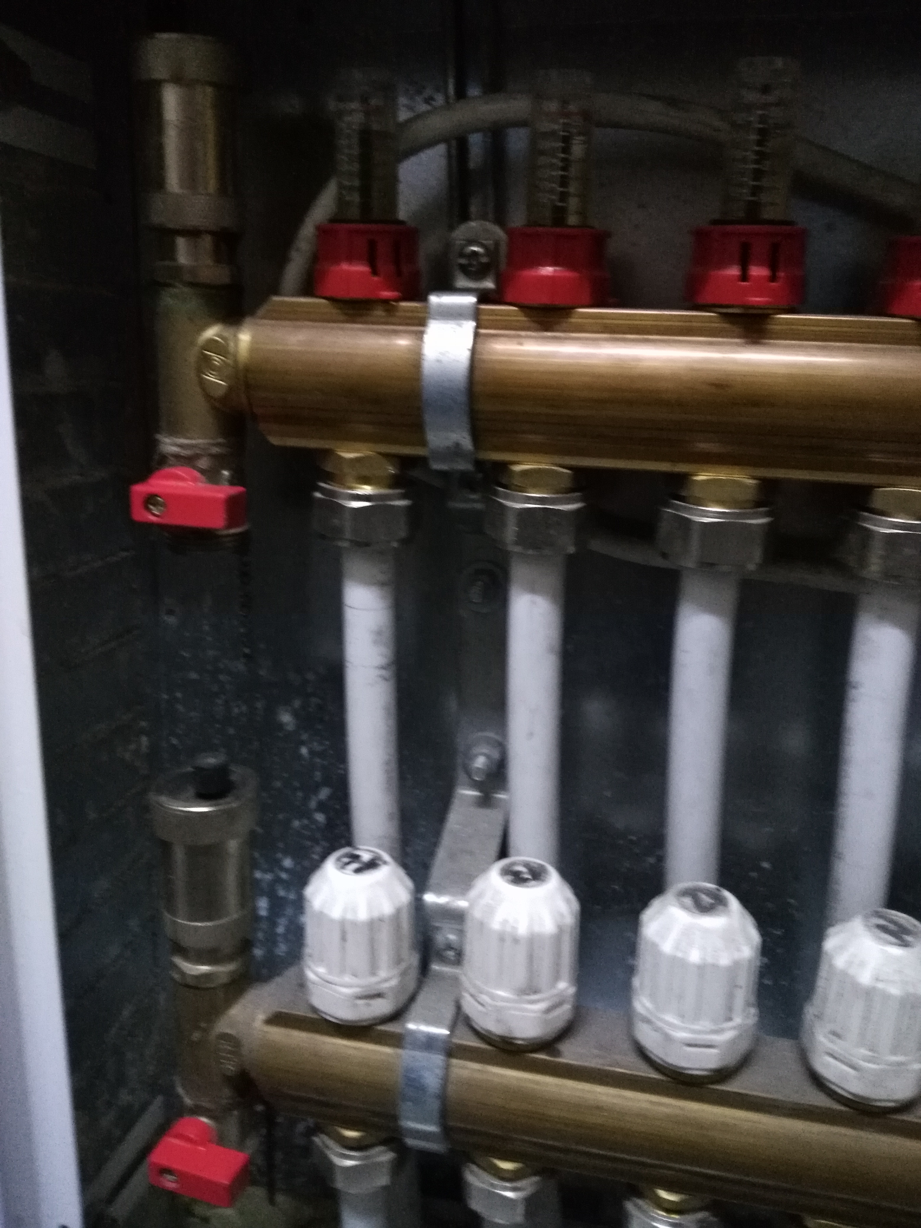

    Hello. I have a problem with the floor. Zero flow on the rotameters. I have a floor covering the whole house 150 m2. Pump type Solar 25-60 / 180, three-way valve Vta 572-31700200 20-43 ° PN 10. Brastal 25 kw charging furnace, divider 14 loops. The pump runs on 2nd gear. The situation is as follows: if you turn 13 out of 14 loops, then on one open loop the rotameter will show max 2.5. If all loops are unscrewed, then there is 0 on all rotameters. Maybe someone can help in this matter. burns macabrely much more than 50 kg of opal a day and it is cold at home. In addition, I will mention that all loops were overflowed and vented. Rotameters with approaches were already replaced with new ones because one specialist said that they were probably damaged after replacing them with a new one. I do not dalo. I have a 1200 m of pipe in the floor installation, laid every 10cm. Please advise what could be wrong here.

    Can you take pictures of the installation? Why don't you have a valve with an actuator?

    Maybe take some photos.

    Be sure to send a photo of the splitter.

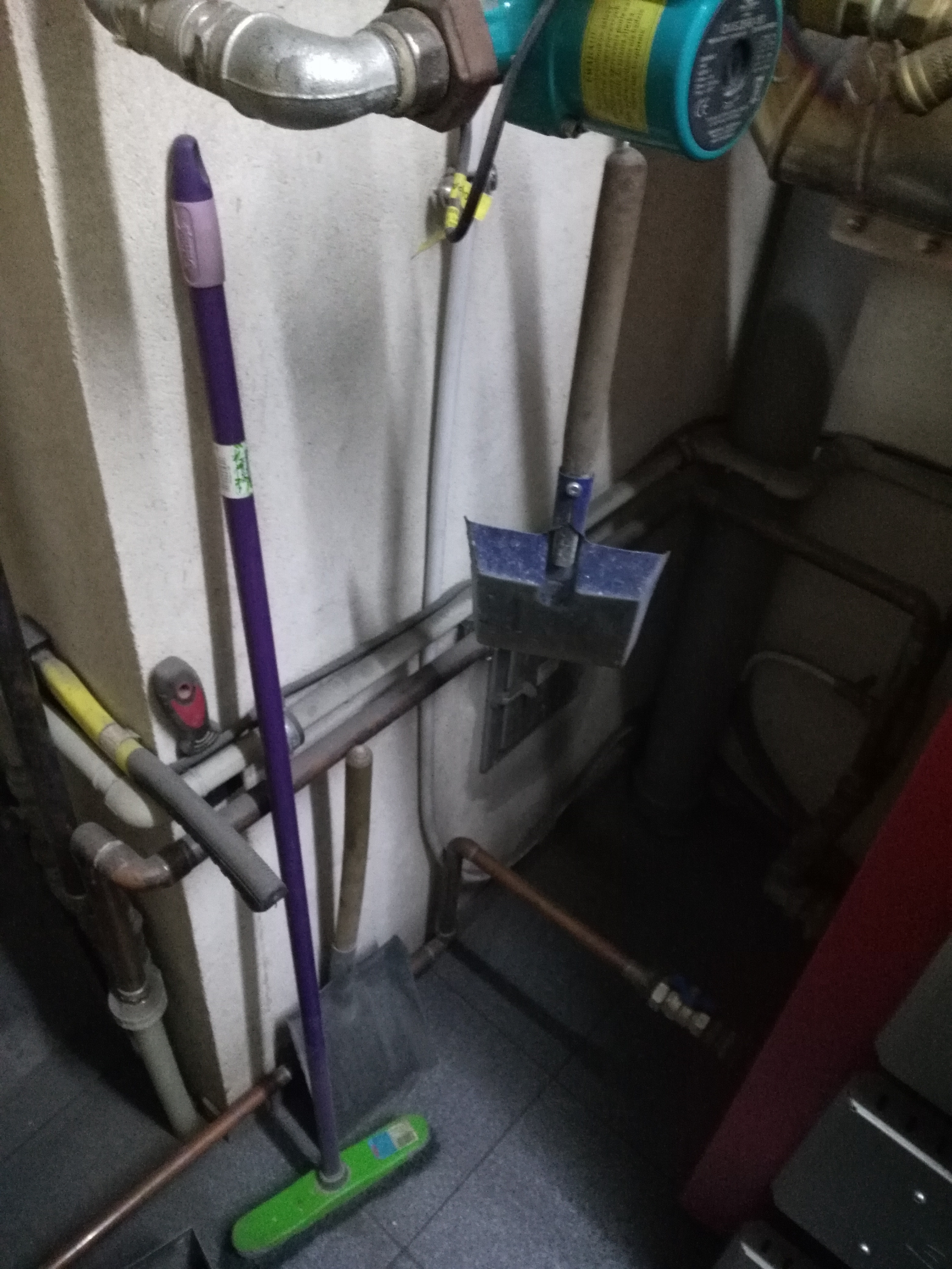

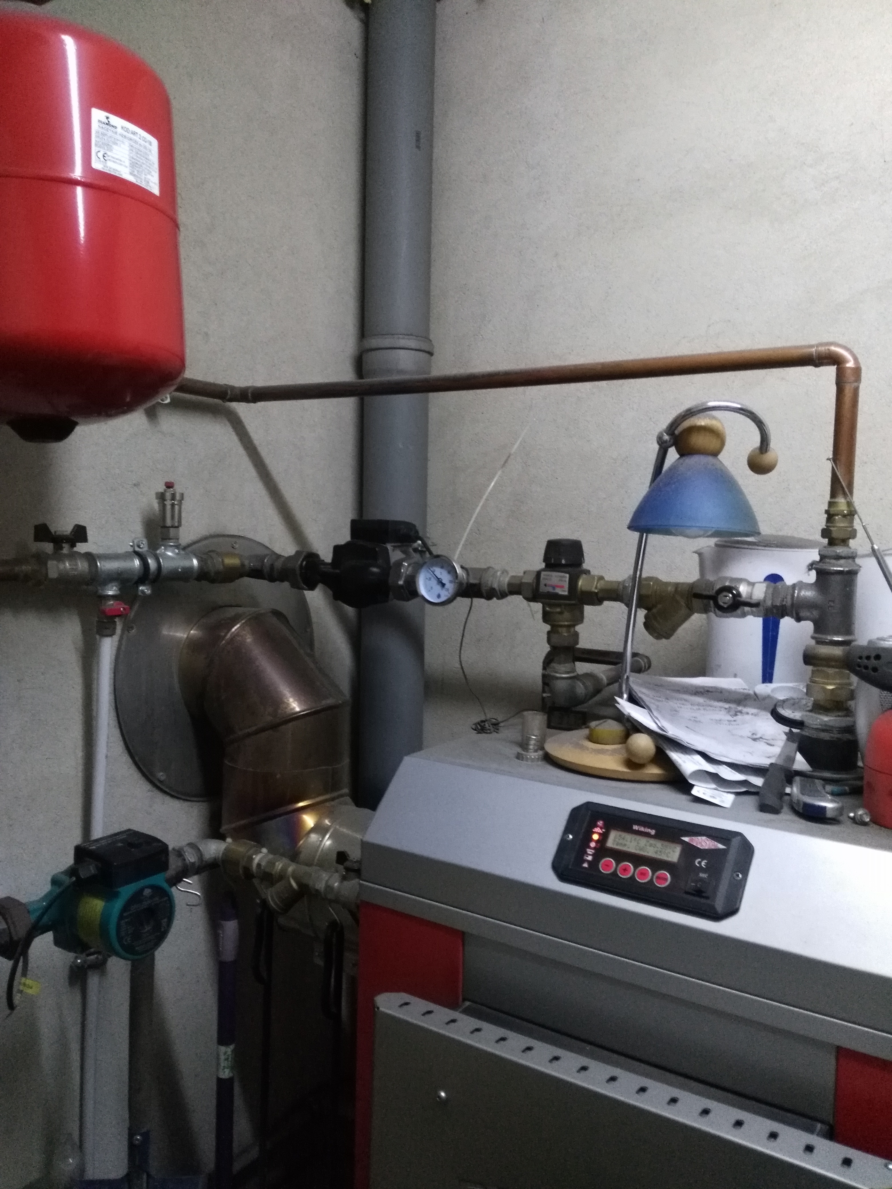

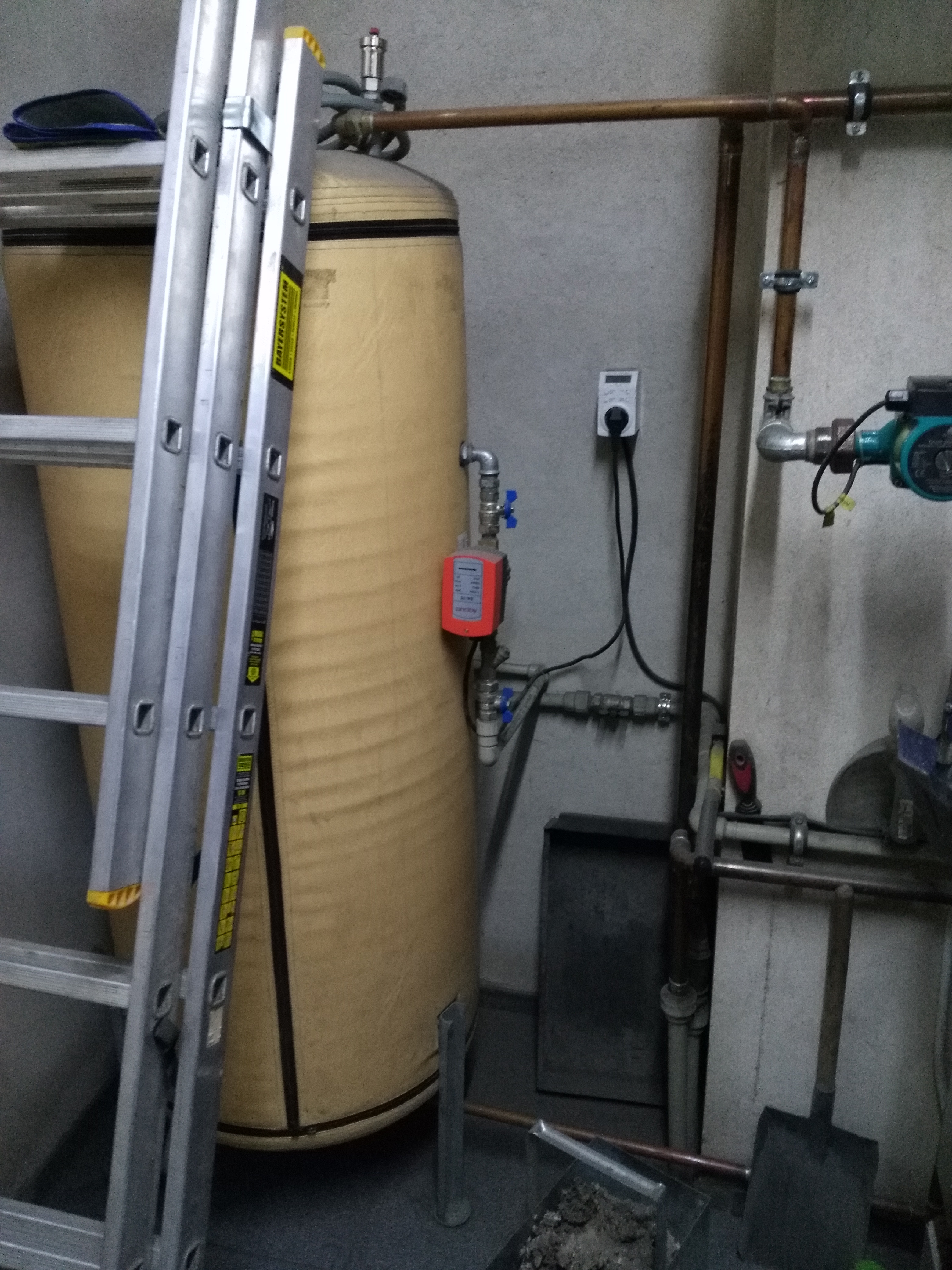

    Pictures taken.

  • #15 17112464
    przemas.j
    Posts: 12
    Rate: 12
    I did not design this installation. Everything was commissioned to the company. And why did they not decide on a valve with an actuator. I do not have a green idea. They said that with this 3-way valve it will go and there is a lime here? .

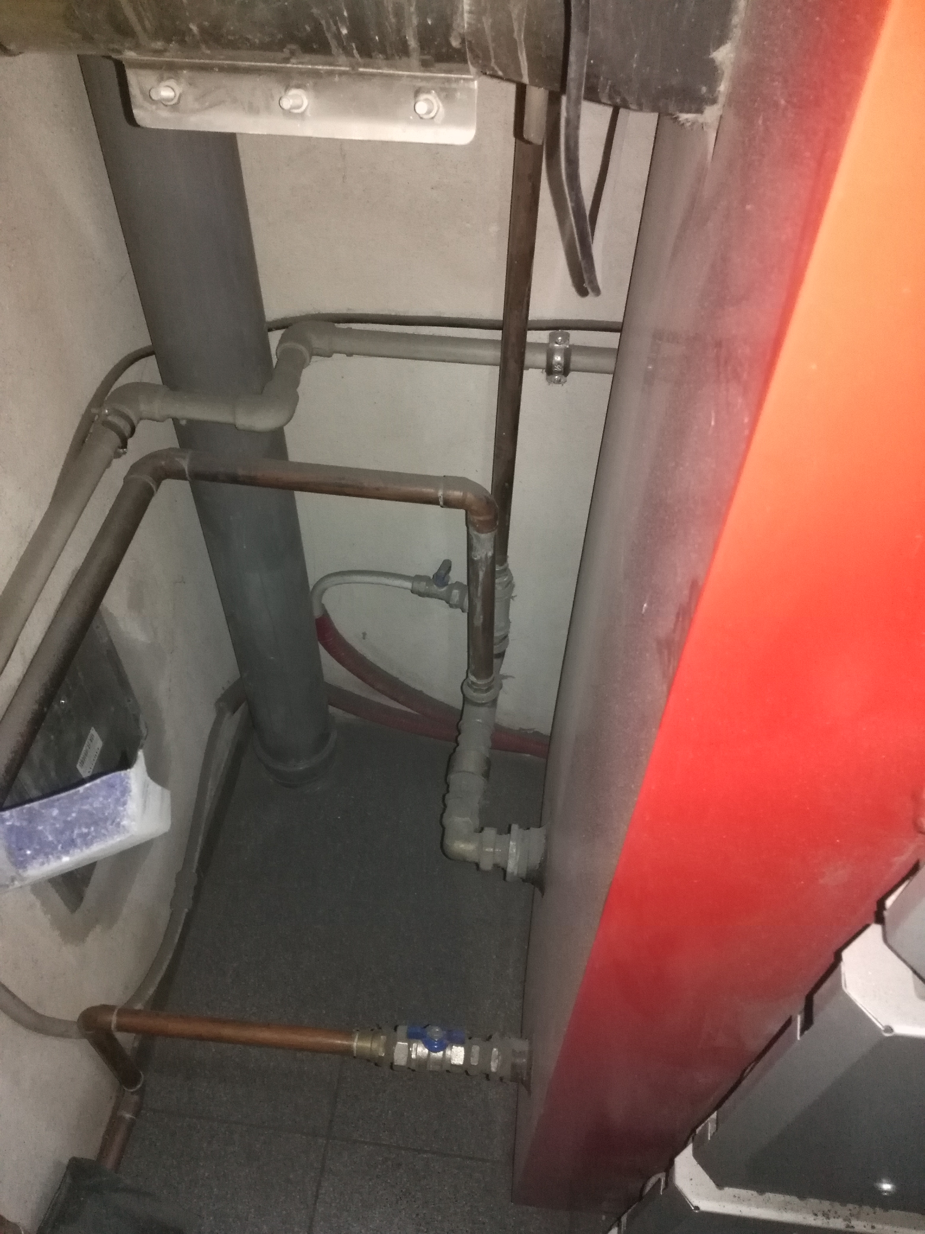

    The question is what is behind the boiler. This pipe from the bottom of the mixing valve where it goes and what is there.
    The question is whether if you turn the mixing valve to max or min, does something move (test on a cold boiler)
    The question is whether the rotameters have zero at the top and max at the bottom and are they always up or vice versa?
    The boiler room is not perfect, but it should work somehow. The flow, if not all loops, should be at least some.

    There is a return from the bottom of the valve, it goes behind the stove and it is connected back to the installation. There is also a non-return valve on the return.

    Take a picture, just a little more light.
    Have you checked if the check valves are in the right direction?
    The return from the underfloor heating system first returns to the mixing valve, and only then connects back to the installation and to the boiler?

    1. Copper installation with galvanized couplings is probably forbidden by the standard, or at least very unfavorable in installation.
    2. Check if the upper or lower beam is warmer, maybe directions are reversed and therefore the flow meters do not work.
    3. in the three-way valve we have a filter on the hot water side, but there is no on the cold return side - maybe there is some muck there and no inflow, maybe something fell and blocked the valve.
    4. Check that both beams are warm, they should have a comparable temperature.
    5. the valve on the hot utility water pump is installed in front of the pump, not what is an error.
    6. What's your temperature on the boiler?
    7. Turn on the pump from the floor heating and try to turn this knob from the mixing valve several times from 1 to 6 and check again if the pipe after the valve gets warm and cold.
    8. take a picture of what is behind the boiler, maybe someone has plugged the return from the floor heating to the return from the hot water.
    9. Open or closed installation? What is the pressure on the installation ???
    This installation is probably one of the first of this company and they are just learning :) just a pity at the cost and material of the client.
    Don't bodyguards install it sometimes ??? :)
    The pump and mixing valve for this installation are selected approx.
    Added after 8 [minutes]:
    Check all the pipes in front of the battens in the box to make sure that all of the two ends are warm. Check as far as possible from the slat.

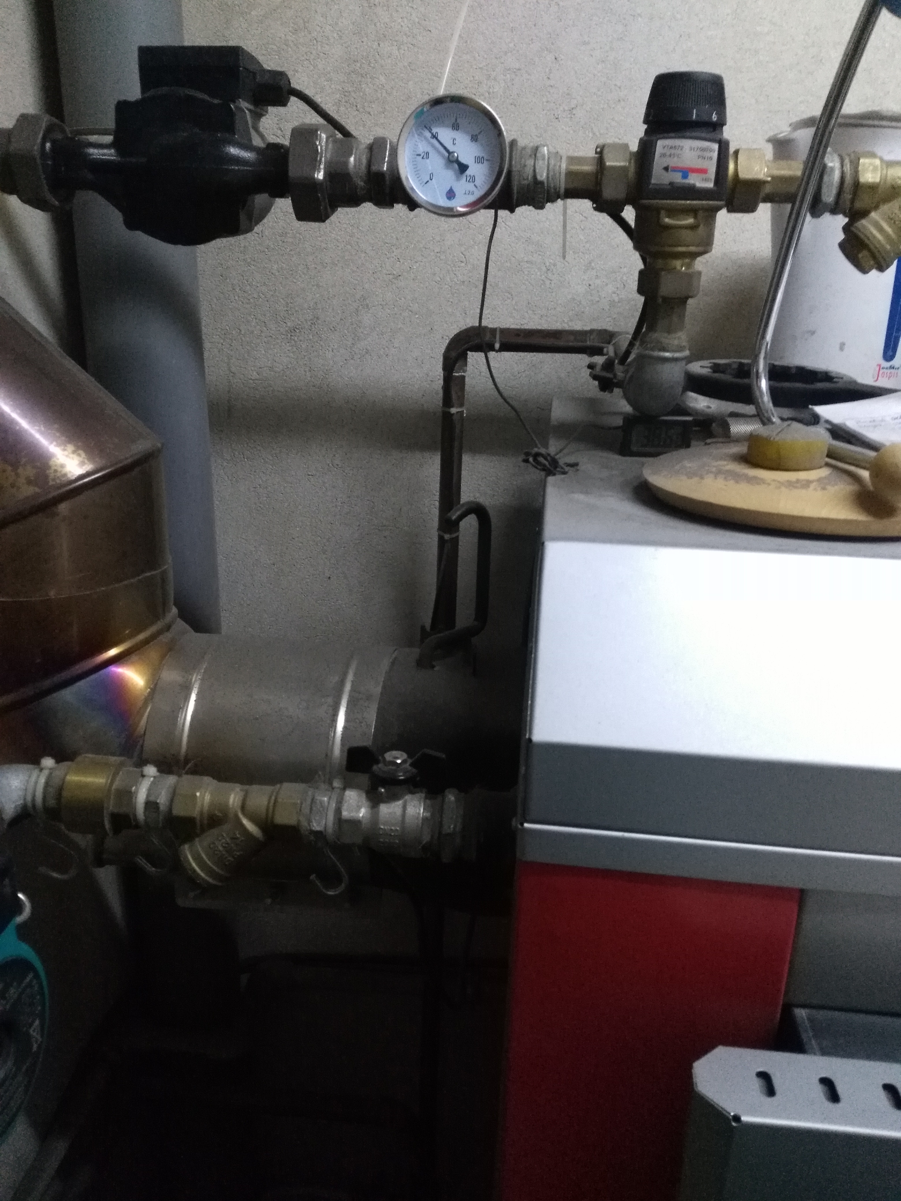

    Hello. This is what it looks like behind the stove. What the rest of it looks like on the stove at 55 °. The valve is set to 5.5, the maximum can be 6. Temperature immediately after the three-way valve measured with an electronic thermometer 38.5 °. Then temperature. On supply beam at beam start 37.1 at end of supply beam 36.2 ° on return beam at beam start 33.2 ° at beam end 31.8 °. 5 are also ok, that is, for the supply beam. As for the moment, the twist of the inflow to the beam is all rotameters for a moment of vibration. Yesterday I checked how to twist 7 circuits on the beam 7 out of 14, then the rotameters start to show something like 0.5 l

    And yet. Closed installation. Pressure 1.5
    Added after 5 [minutes]:
    The valve as it turns from 0 to 6, the rora behind it gets warmer. Really something with this flow must be. Can disassemble this valve and something inside restricts this flow? Because why is there a difference in temperature even on the beam itself in relation to the beginning and end of the beam?
