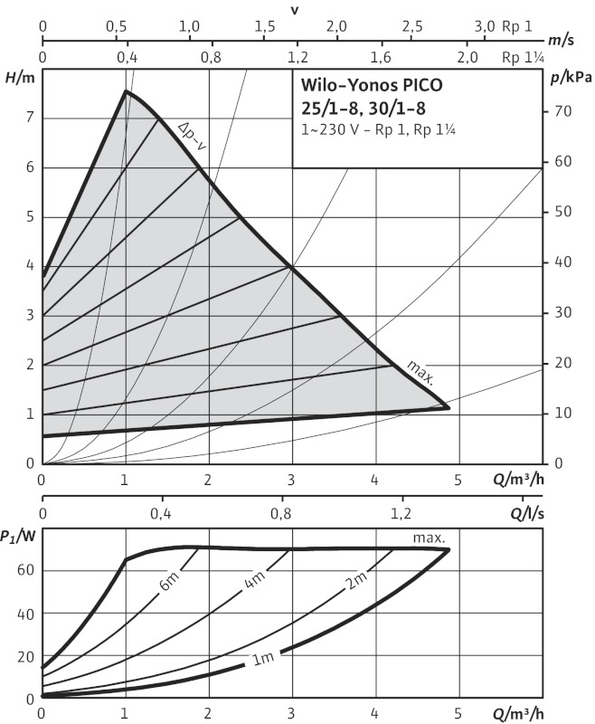

    Hello. In the newly built house, we have installed underfloor heating in its entirety, i.e. about 250m2. And so the bottom is served by one 7 circuit divider and the top two 4 and 6 circuit dividers.
    The entire heating system is based on a 16 pipe and a total length of approximately 1600m.
    The main power supply is an air-water pump which loads the 1000/200 multivalent tank (i.e. 800 liters of CO and 200 DHW) to about 43 degrees Celsius.
    In addition, a fireplace with a 24KW water jacket is connected to the container, used occasionally so far.
    The floor is powered from the upper part of the buffer through steel pipes (clamping system), the pump is controlled so that it does not pump the coolant cooler than 35 degrees into the floor.
    And so, start from the buffer pipe 1 inch, then the thermostatic mixing valve atm341 (protecting against loading too hot medium heated by the fireplace into the floor - the indicator is open to the maximum at 6)) then the pump Wilo Yanos pico 25 / 1-6- (ROW) and then ZZ, then parallel to all three dividers, i.e. one 7-point at the bottom and two 4-point and 6-point on the first floor daw at the top, separated by a tee for 3/4 pipes.
    At the moment, the heating is able to maintain the set temperature of about 21 degrees above, while the temperature at the bottom is much higher because the whole is lined with tiles, while the top heats up with more difficulty (most are panels but tiles also in the corridor, bathroom and utility rooms.)
    At the moment, the indicators on rotameters oscillate between 0-0.5 and not on all loops. When trying to regulate, i.e. checking the flow on individual beams, after tightening all loops and leaving one (each in turn) on the rotameter, the maximum flow of 2.5-3l / min is displayed. range, but it is known that the pressure in the water supply was greater)
    When two manifolds on the third are blocked, the rotameters show the flow in the limit of 1.5.
    There is no way I am now able to adjust the flow on the individual loops.
    The loops mostly consist of sections of 80 to 100 m, except for 4 shorter ones, between 30-50 meters.
    My question is whether the lack of flow is caused by the installation of only one circulation pump for such a large installation, or is it too weak.
    What solutions do you recommend?

    I understand correctly that you supplied two manifolds with one pump?
    What is the 30stka pump? Because not 25? How many meters of lifting?
    Do you have any schematic of this? Pictures? How do you regulate the temperature on the floor?

    All three manifolds on one pump Wilo Yanos pico 25 / 1-6- (ROW) - the installer said that he would pull.

    Recently, for less than 1000 meters, we chose the 25 / 1-8 pump and it can barely make it.
    Here, 25 can't do it. You have to choose something from 30 steak.
    I would not assume smaller than the WILO YONOS PICO 30 / 1-8.

    So fast, you would need something about 4.5 meters of lifting with a capacity of 3.5 m3 / h
    The pump you have for this lifting height is just over 1m3 / h

    What pump and valve do you suggest?
    What do you think of the SPRINTA 32/80 LFP?

    The best Stratos Pico 25 / 1-8 Minus is the Plus price you stay with a diameter of 25
    Poor Flow in Underfloor Heating System: Causes in New Construction with Air-Water Pump, 250m2 Area
    Stratos 1-6 a bit too weak
    Additionally, check if the pump would be able to regulate the temperature to the floor. Alternatively, you can install a driver, eg ST 430 TECH

    Hello. Thanks to everyone for the hints.
    I start with the simplest one, i.e. blasting the thermostatic valve, then I will check the flows on individual floors separately, i.e. up and down.
    If it would be enough, I will only buy the second, same pump for the second circulation, if not, I will use the suggestion of my colleague "piracik" and buy a Stratos Pico 25 / 1-8.
    If it is chulało, you will only install a three-way valve (to protect the floor when heating the fireplace) and that's it.
    I hope that the first option will work, i.e. the second pump, the same as I already have (but the stratos costs a bit).
    I still have a question because I have seen Wilo pumps with an LCD display somewhere, which supposedly adapt themselves to the floor heating, i.e. power depending on the temperature on the supply and return, etc.
    Maybe someone knows what model it is?

    I removed the thermostatic valve and the flow with 3 manifolds turned on is in the range of 1-1.3. When closing the lower distributor, the upper one is in the range of 1.5-1.7 and it will not perform any more. But that's definitely better than below 0.6 before disassembling the valve. How do you think to buy a second wilo pico 25 / 1-6 and divide the ground floor from the attic into two pumps or the entire installation of wilo stratos 25 / 1-8 as suggested by one of your colleagues?

    I will wait a little, see how it heats up, i.e. whether the floor heats up faster and more easily and I think that I will enter two circuits so as not to heat the bottom of the house if it is not necessary and vice versa.
    I think that you could buy a stratos 25 / 1-6 for power supply, because it is probably more efficient than the pico YANOS 25 / 1-6
