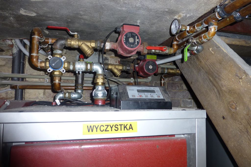

    I have a problem with underfloor heating, namely it does not want to heat.
    I have heating in 3 rooms, i.e. kitchen-living room (4 loops approx. 30 m2), bathroom (one loop approx. 9 m2), corridor (one loop approx. 7 m2)
    I also have one ladder radiator in the bathroom and one radiator in a room with no underfloor heating.
    Heating was used by a plumber who supposedly knows his job. He vented the entire system twice.
    I regulate the temperature for the floor heating using the Hertz thermostatic head with a capillary.
    How I started the floor heating and set the temperature to 25 degrees. the floor was not warm, the radiators were hot. After turning off the radiators, nothing has changed, i.e. the floor is still cold.
    I set the maximum temperature on the head, i.e. over 50 degrees and the floor heating started, the temperature increased in the living room indicated about 25 degrees in the bathroom, almost 28 degrees. I changed the thermostat to 30 degrees and the temperature on the floor heating dropped to 21 degrees.
    The input collector is warm at 30 degrees Celsius, but the pipes further away from the collector are cooler, and the return collector is completely cold. I noticed that when the head was set to the maximum, the return was warm.
    Which may be the reason why the floor heating does not work at low temperature. It seems to me that the floor heating should be heating at the same time. about 30-35st.
    Pictures of my boiler room may help.
    Best regards and thank you for the advice.

    You need a floor pump on the manifold after the control valve.
    I do not know what kind of fashion it is to mount the splitter to the floor heating system lower than the loops. How is it supposed to vent?
    You need to stick something like this: Underfloor Heating Not Warming Up: Hertz Thermostatic Head, Capillary, Venting & 3 Room Setup
    See also this topic: Link

    This floor does not heat up because the capillary valve does not release water that is more than set at 30 degrees C. You would have to first supply it with water at a steady temperature, ie through a mixer.
    You need to assemble such a system as the piracik color shows in the picture, otherwise it will not work.
    Such a valve with a cap is assumed to: to regulate the temperature of the room or the floor itself. The capillary is then on the wall or in the floor between the loop pipes.
    As you have, when the valve flushes a little water with a temperature higher than the set temperature to the manifold, the capillary will close the valve until this small amount of water in the manifold cools down to the set temperature. Then it runs a little water again and the valve closes.
    It is a "pulsation power" of 200 grams of water per minute. :-)
    Before the first dose of water reaches the end of the loop, it will probably be about 3 days.

    It is not about the pump itself, but about the mixing and pumping set. The mixer mixes the hot supply water with the cool water from the floor return which the pump feeds to the distributor.
    This capillary valve is not needed there. You can use it for a heater-radiator.
    If you switch the capiare to return, you will have a high temperature on the supply, i.e. the temperature given by the boiler, and this may damage the floor pipes.
    The mixer acts as a thermostatic mixer for the shower cabin, you set the temperature on it and hot water flows from the showerhead so that you do not burn yourself.
    Podogowka also needs such a constant temperature and protection against "burns" - deformation of the tubes and scalding in the feet.

    Just install the pump and the bypass. The rest is ok. The valve is good.
    Only after installing the pump the loops will work the other way and you will either have to transfer the capillary to the lower beam or change the supply and return from the boiler.

    The pump forces the water through the loops, if the capillary determines that the temperature of the water flowing into the loops is too cool, it will slightly open the valve and release some hot water from the boiler to the floor, if the temperature reaches the set value, it will close the valve again, cutting off the water from the boiler, and the pump will it will still pump only through loops. This is in a nutshell and the easiest way.
    If you install a pump, the beam feeding the loops will be the beam to which the return to the boiler will be connected. Again, I refer to the pictures attached in the topic from the above-mentioned LINK.
    So if you mount a pump, you have two options:
    1. Swap the power supply from the boiler back, leaving the valve on the flow. That is, the power supply on the lower beam, return on the upper beam, the capillary on the upper one, the pump moves from the lower beam to the upper one.
    2. If the loops can work in the other direction than at present, you install the pump, the upper beam is the return beam, the lower beam is the supply beam, the capillary is transferred to the lower beam, the valve remains on the boiler supply, the pump presses from the upper beam to the lower beam.

    First, install the pump so that it pumps from the upper beam to the lower beam and place the head capillary on the lower beam. Yes, it is a copper sensor attached to the wristbands.

    I did the piracik as you said, the floor heating is already working. Thank you so much for help :)
