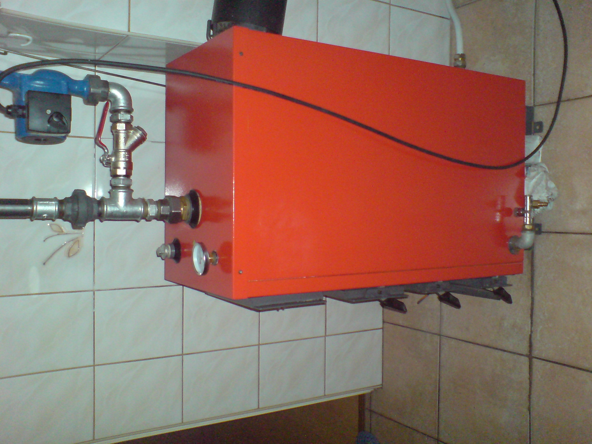

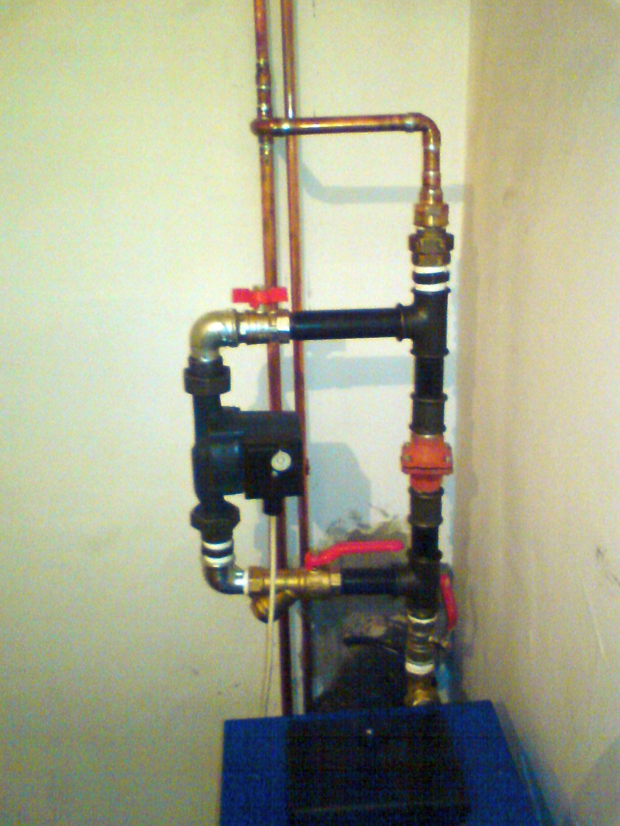

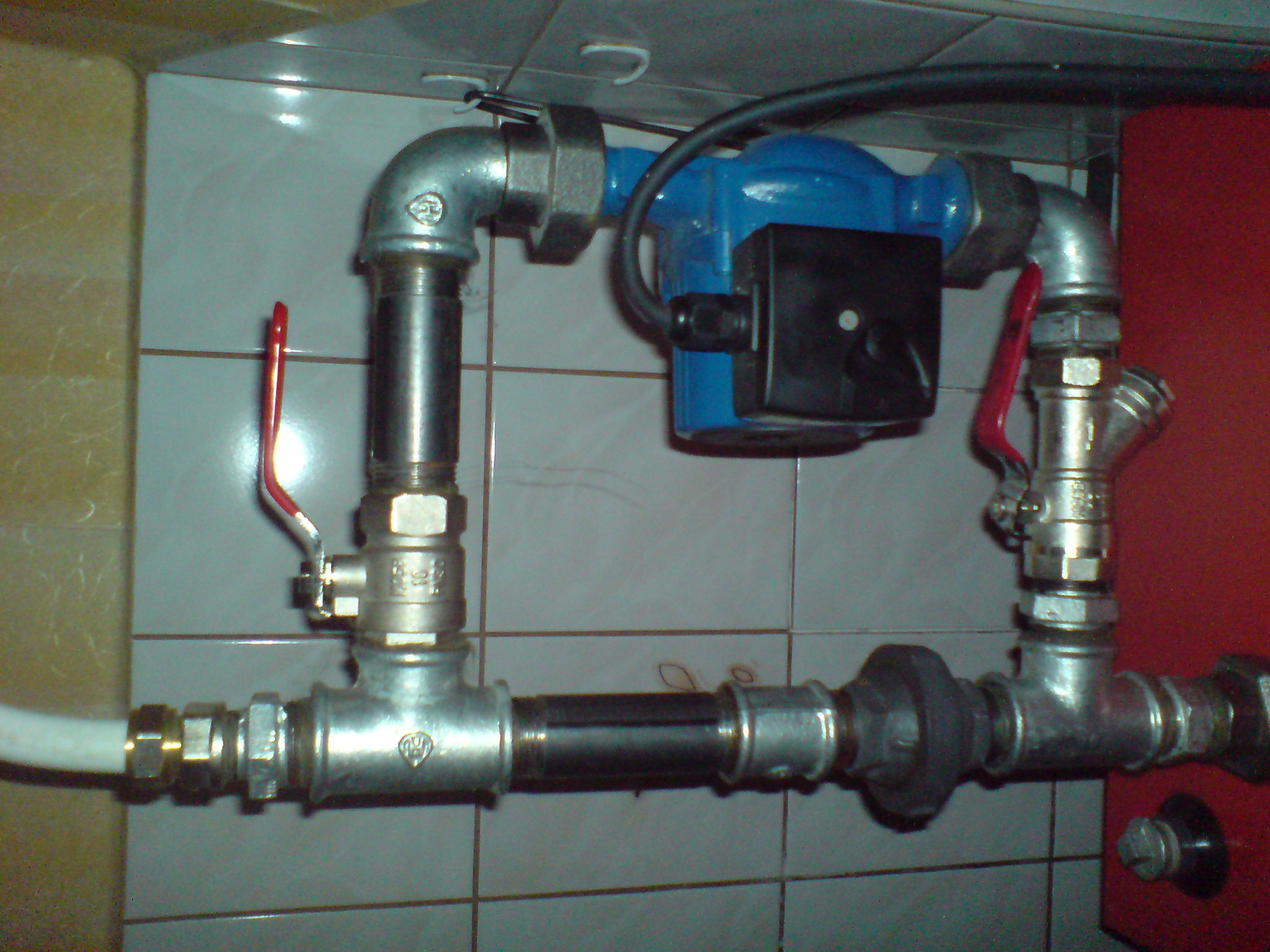

    https://obrazki.elektroda.pl/4979707800_1291412285.jpg
    https://obrazki.elektroda.pl/7019911000_1291412288.jpg
    https://obrazki.elektroda.pl/3358849900_1291412290.jpg
    https://obrazki.elektroda.pl/6003525400_1291412293.jpg
    these are photos.
    Added after 3 [minutes]:
    I have a stove in an apartment on the 2nd floor, which is on the same level as the radiators.
    Added after 45 [seconds]:
    from the stove to the last radiator, the horizontal is approximately 14 meters.

    In fact, it looks like if you have 95 on the stove and the radiators are cold, the pump is blocking the flow rather than pumping. Maybe you have a reverse-mounted check valve behind the pump. Since this is a new installation, maybe no one has checked it thoroughly during the first run. I've had something like this before. A large installation company remodeled my boiler rooms and in one of the circuits put a check valve in the opposite direction. I found out only after the heating season started.
  • #20 8822695
    zadario
    Posts: 25
    Rate: 54
    So meatball. There is no valve in the straight section of the installation. Bypass pump :( No check valve, orifice at the outlet to the receivers. Effect: the pump circulates the water, but for the most part around it.
  • #21 8822721
    canon314
    Posts: 15
    Rate: 49
    maybe it would help if I would record a short film?
  • #22 8822743
    zadario
    Posts: 25
    Rate: 54

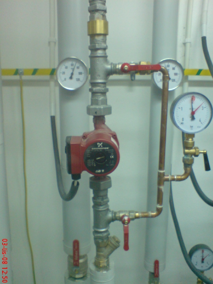

    The heaters do not heat up. The heat seems to be trapped in the furnace.
    First, you should put the valve in the place indicated by the arrow. When the pump is in operation, it should be closed. In the absence of power to the pump, you open it and rely on gravity.
    Apart from that, the pump should be installed in the place of the arrow and the bypass should be fitted with a pressure gauge.
    Added after 4 [minutes]:
    And this is what it looks like in a professional boiler room.
    The brass piece above the pump above the tee is the check valve

    Oh, and if I move the pump to the place indicated by the arrow, will it have an effect?
  • #24 8822795
    zadario
    Posts: 25
    Rate: 54
    Thanks to the manometer, you can check if the pump is actually working. You close the lower bypass valve and open the upper one and you have pressure downstream of the pump, setting the valves in the opposite way you have pressure on the pump supply. When the pump is working properly, the pressure above the pump will be higher than the supply pressure.
    Yes, because you will be able to cut off the bypass and force the water to flow through the radiators. This will prevent water from returning to the boiler before it reaches the radiators, which is likely to be the case at this time, and if the pump is installed in the bypass, the efficiency of the pump is lost.
