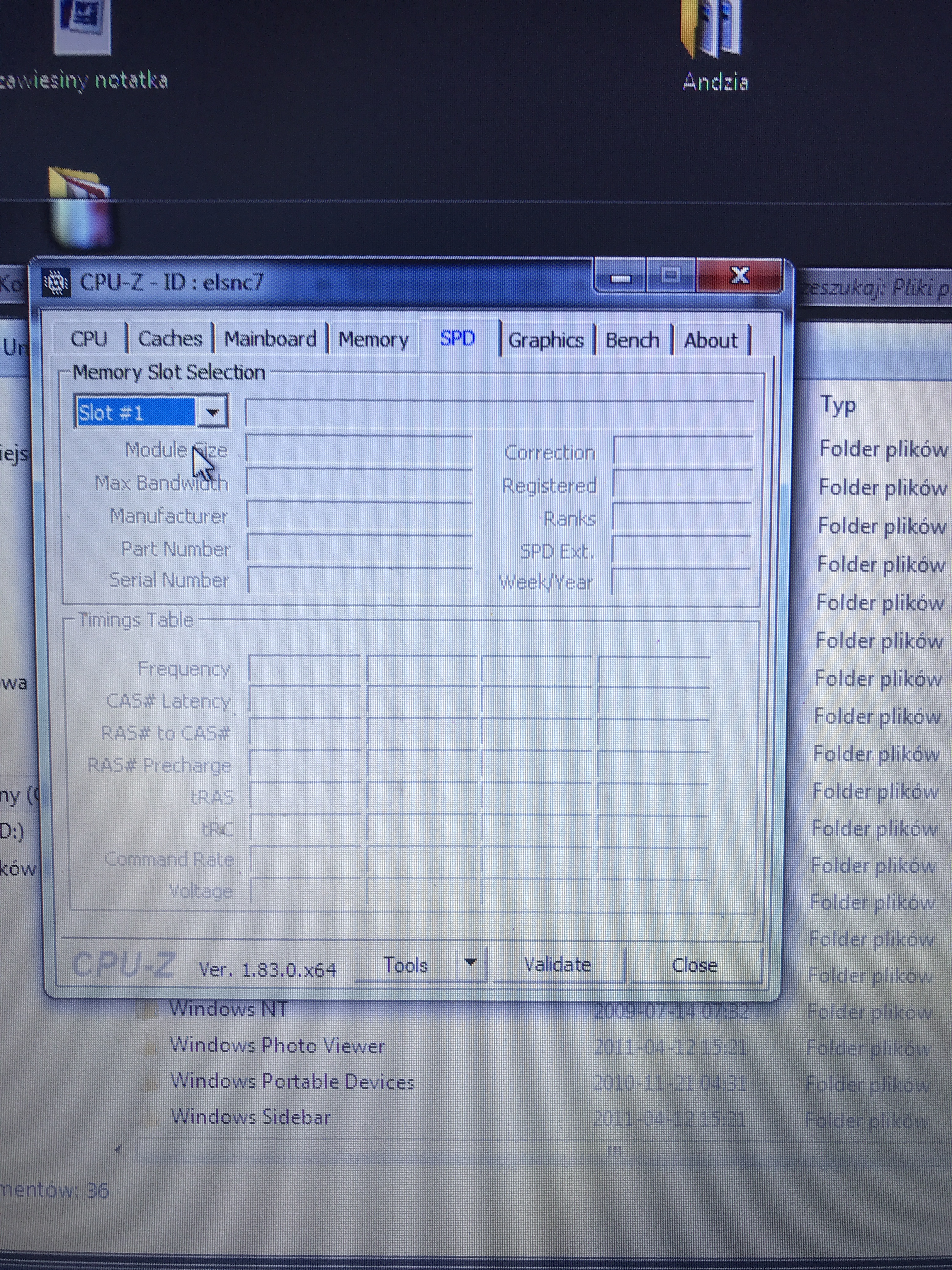

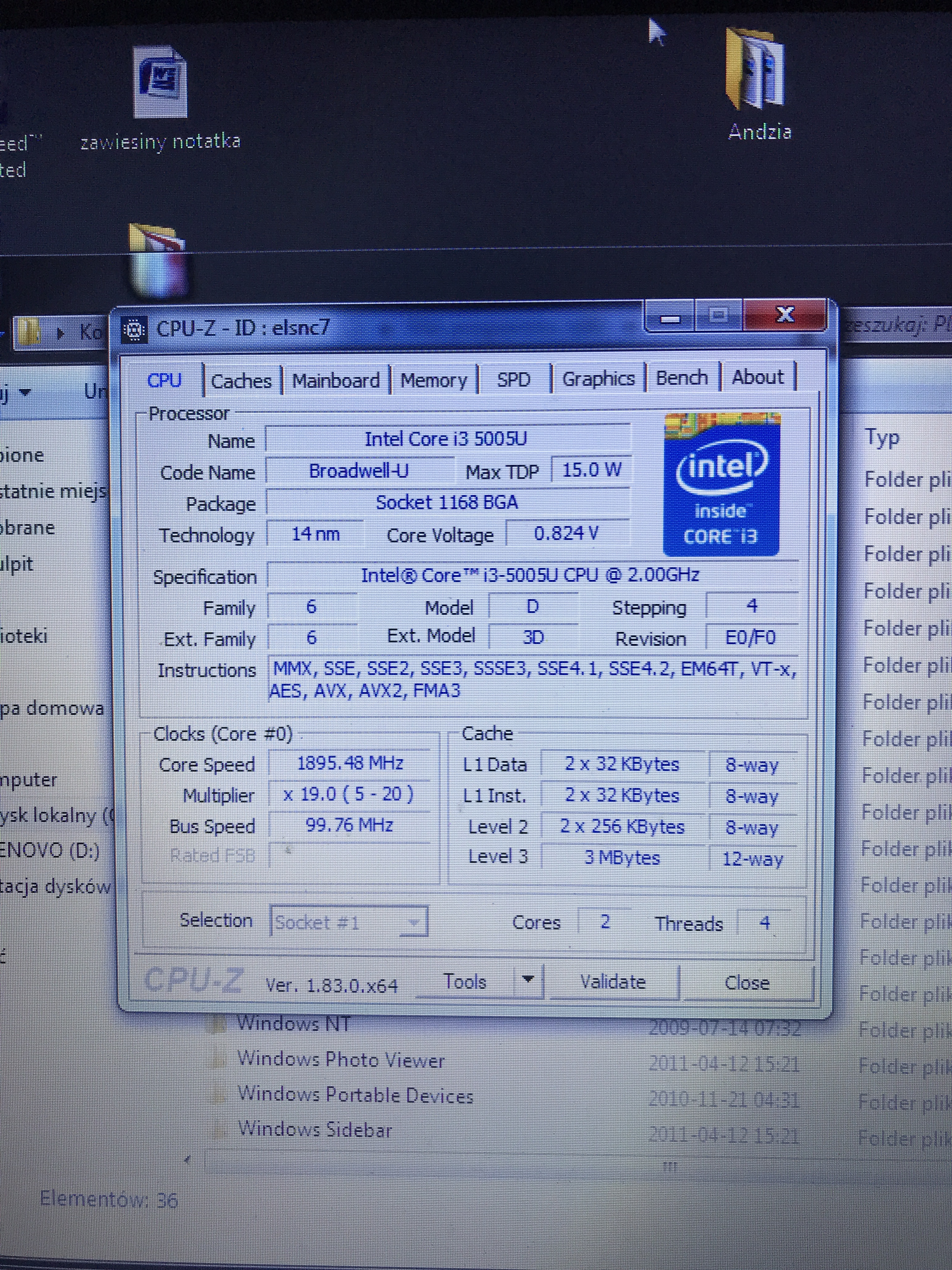

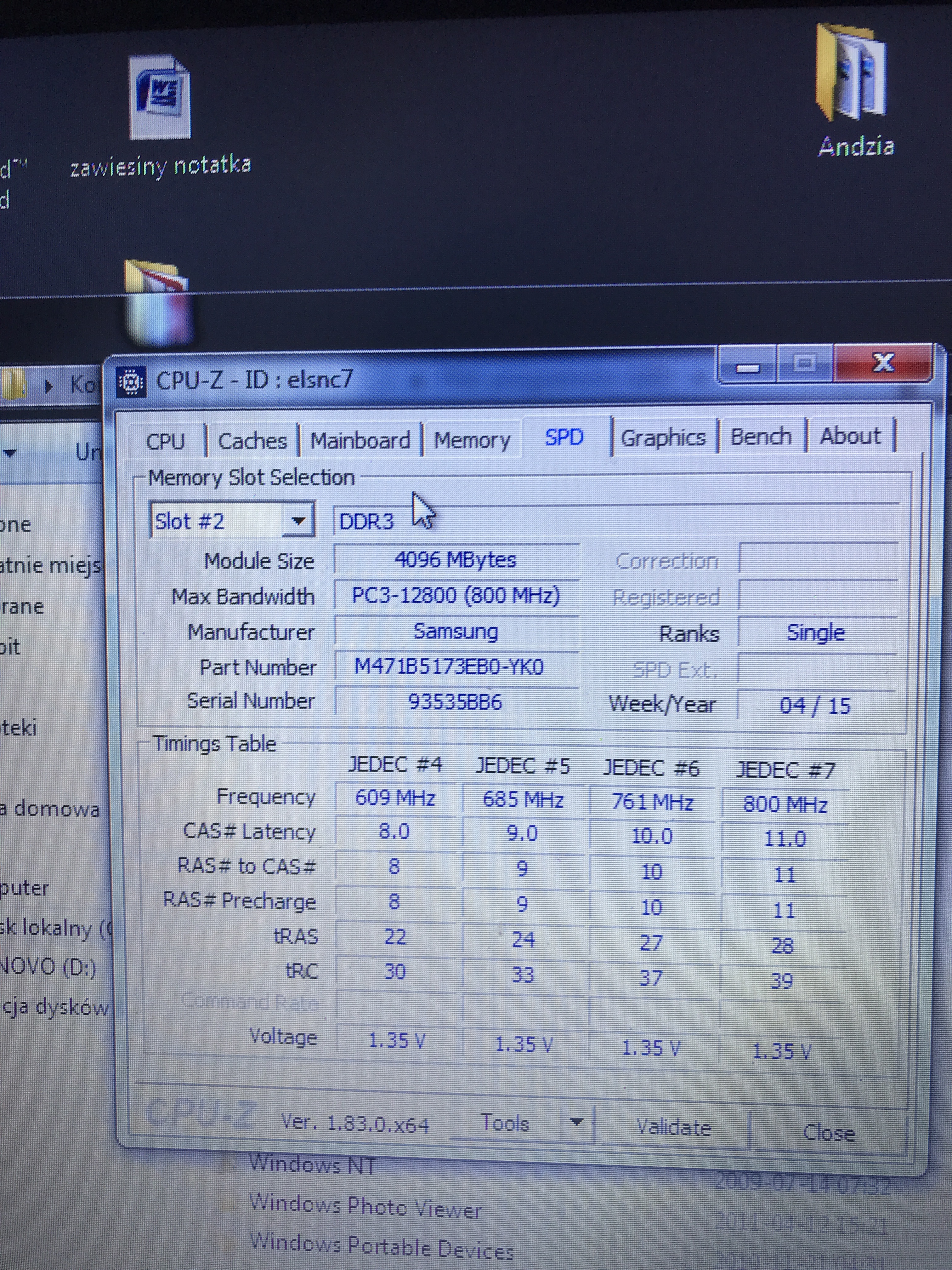

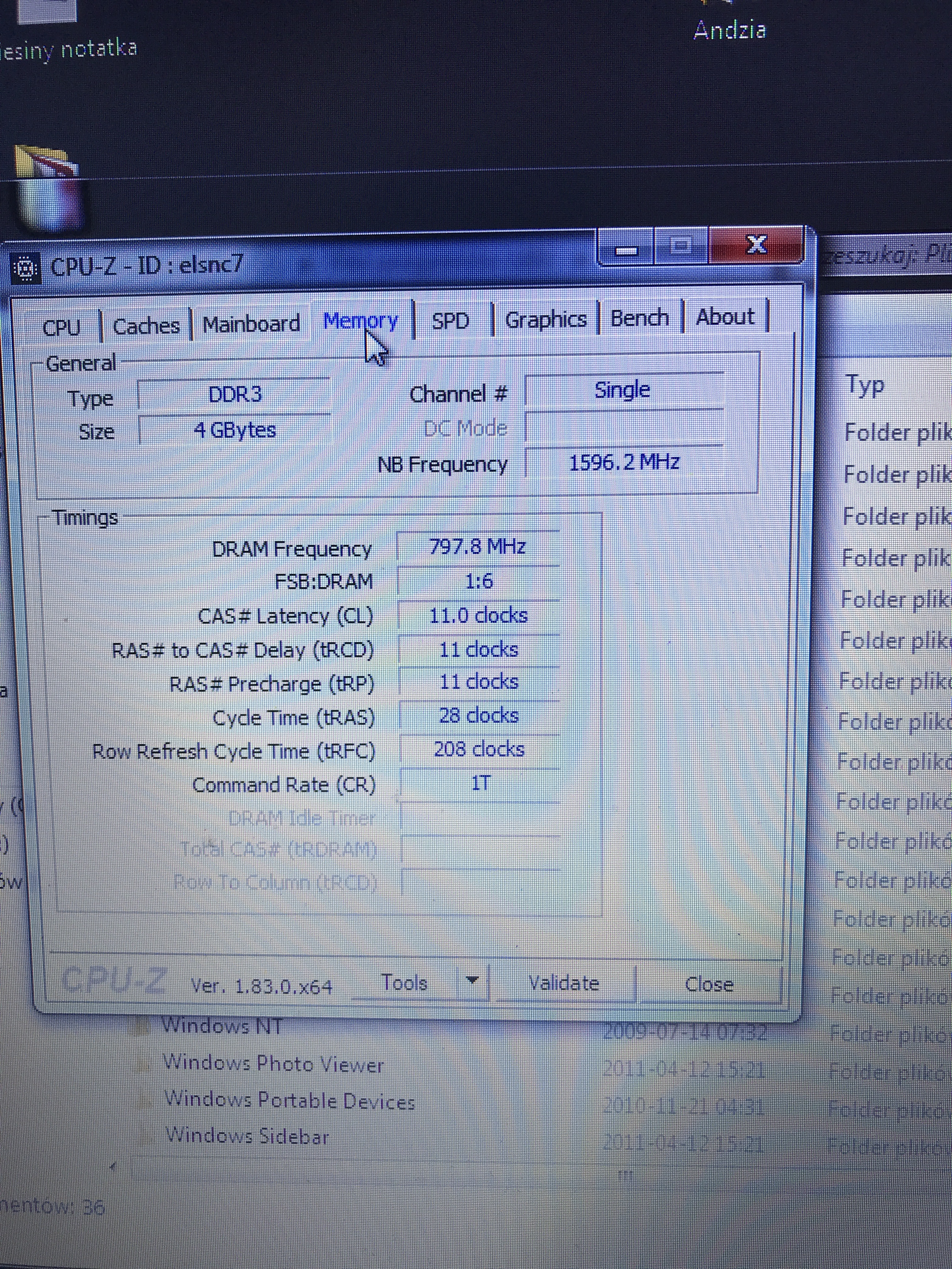

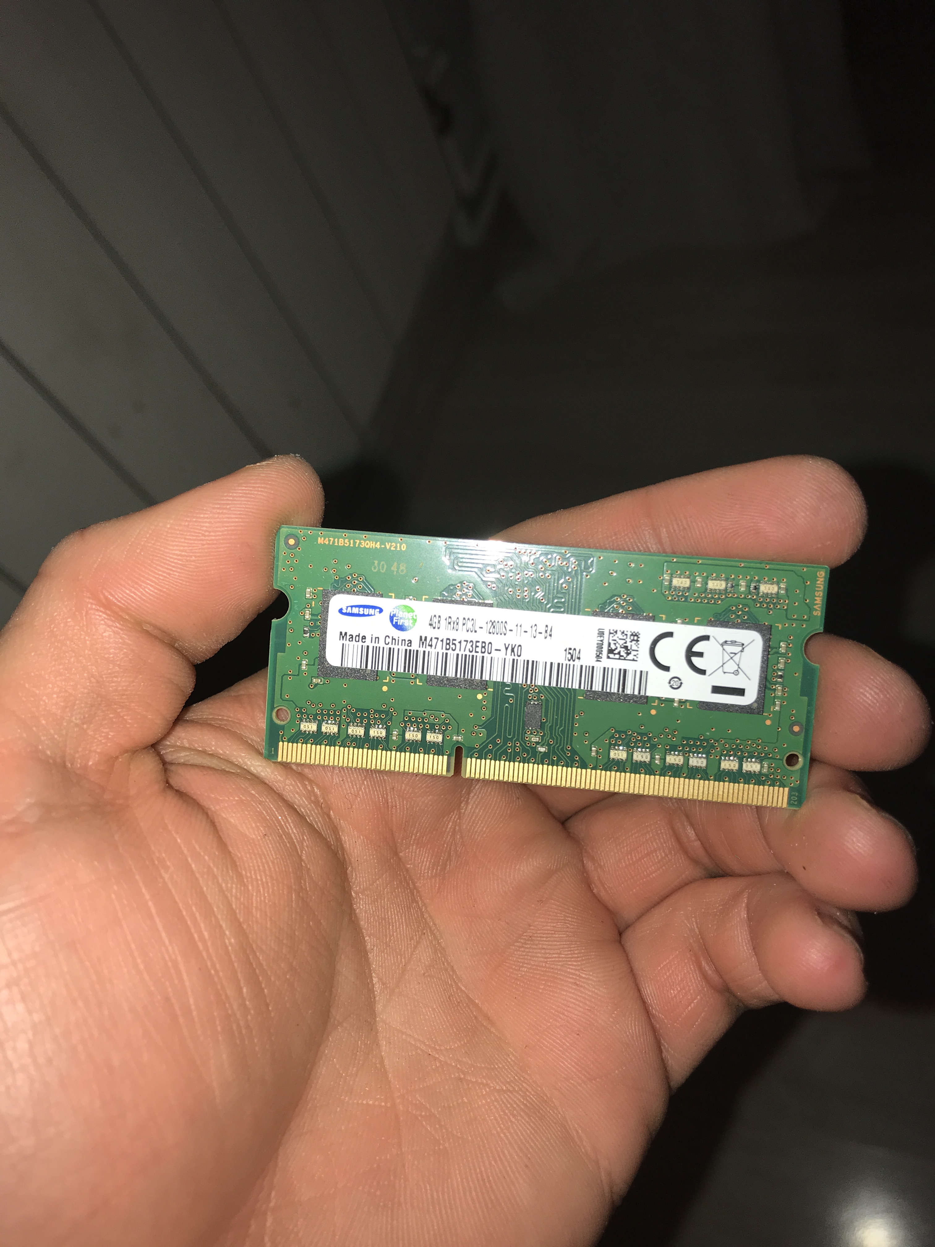

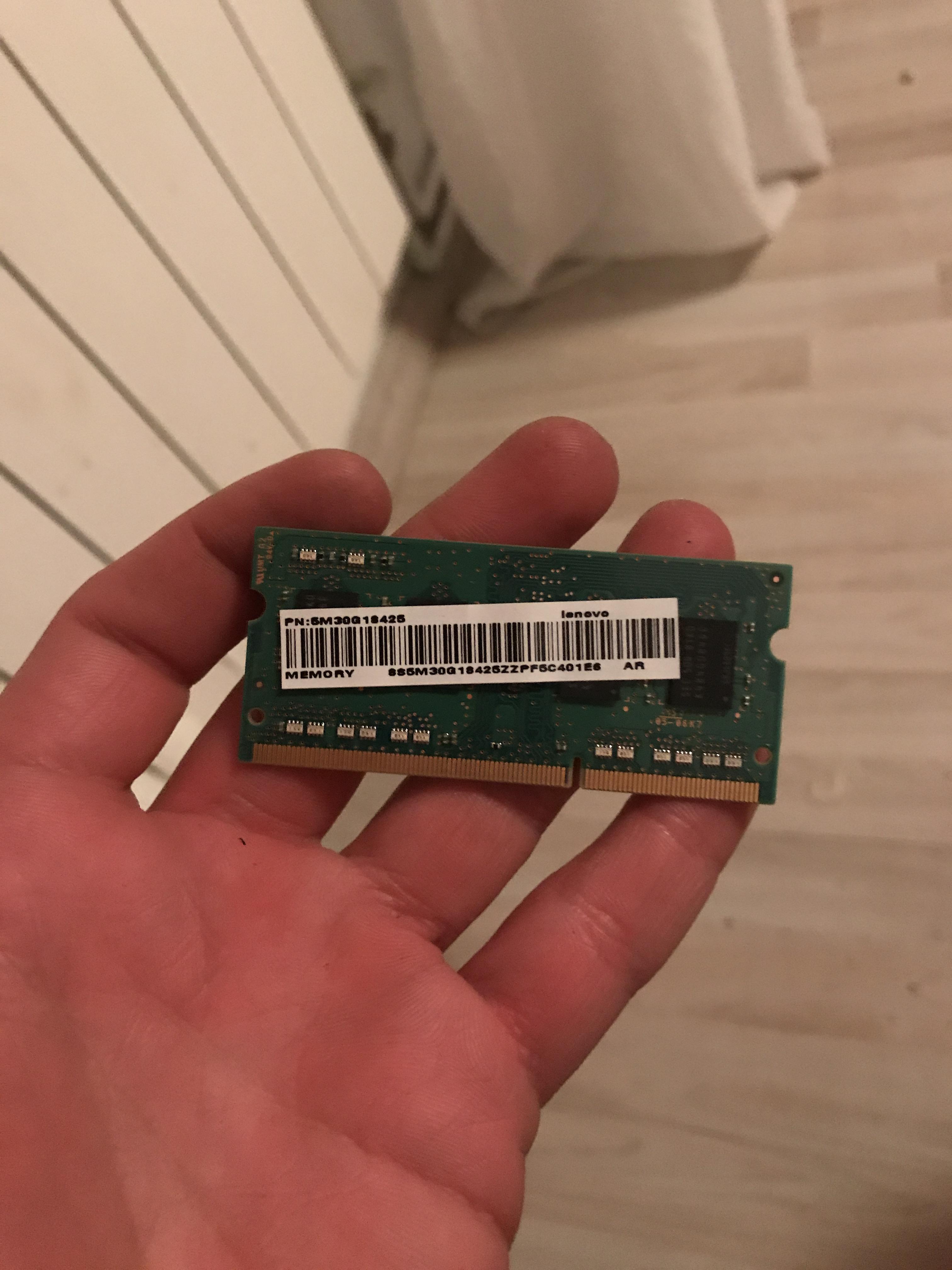

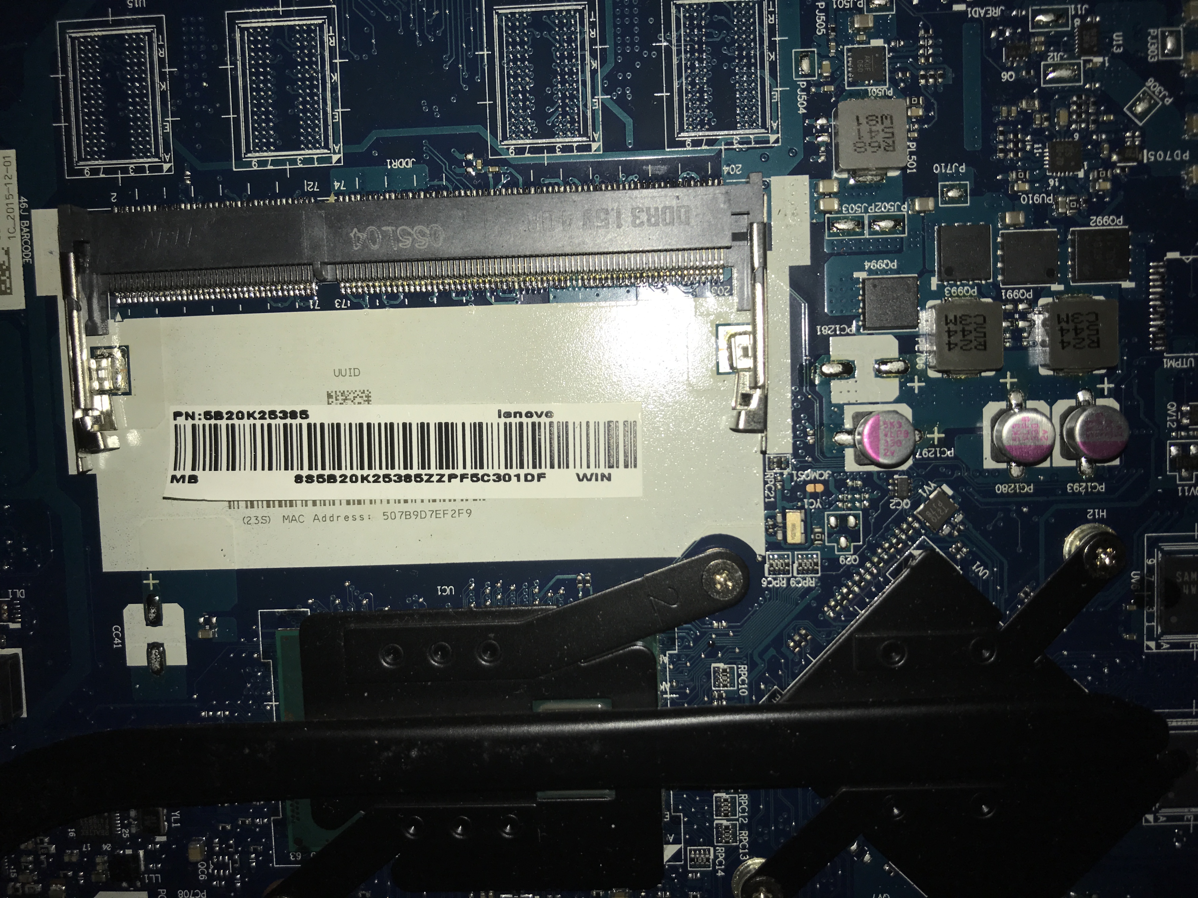

    Hello, my laptop currently has 4 Gb Ram. I read on the internet that usually the first bone is soldered and the second one should be free to attach the second bone. For me, it is different, unfortunately, I have only one bone and it is just a plug. And my question is, can I put an 8Gb Ram bone in this laptop? And do I have to do anything in the settings in addition to inserting? I looked around the internet a bit and found such a bone, will it be good?

    Up to 8 GB DDR3L memory

    I understand. And what I put in the link could be for this laptop?
    Ok, so if I understand it correctly, it will fit. Can the one from the link be? Do you recommend anything else? And is it enough to pull out a 4 GB bone and insert 8 GB? Will I have to set or change anything else?

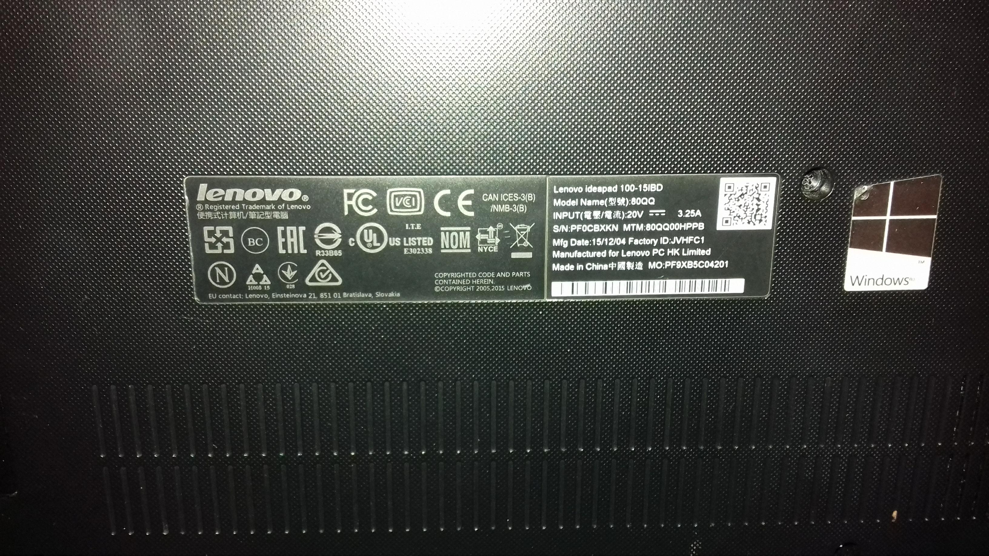

    You need to enter the exact type of Ideapad 100, and then what?

  • #10 17120065
    kindlar
    Level 42  
    Posts: 7888
    Help: 919
    Rate: 1622
    When you put it on, it will work at 1600MHz (800).
    As a side note, how many bit windows do you have?

    JasiekSDZ
    Posts: 35
    Lenovo Ideapad 100: Upgrading to 8GB RAM - Compatibility & Settings for HyperX DDR3L 1866MHz SODIMM
  • #13 17122116
    Freddy
    Posts: 19997
    Help: 1394
    Rate: 2821
    Go to https://support.lenovo.com/pl/pl/
    in the box in the middle, start typing 100-15IBD and select the 80QQ model
    You will learn exactly everything about your hardware, including the possibilities and the latest drivers.

    Maybe I'm too stupid but I don't see anything about the frame, so how would you tell me if I can easily put the 8gb frame in what I gave in the link and will I see the differences in walking the laptop and if after inserting the frame bone into the laptop, I have to do something else, e.g. in the settings ?

  • #17 17122161
    Adam-T
    Posts: 5113
    Help: 834
    Rate: 1096
    JasiekSDZ wrote:
    But can you tell me if I have to do something, for example in bios or some other settings?
    No. At most, you can see if it detects it correctly.
  • #18 17122195
    Freddy
    Posts: 19997
    Help: 1394
    Rate: 2821
    Nothing in the BIOS needs to be changed. you can as he writes Adam-T see if it detects correctly.
