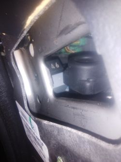

    Hello, I have a honda civic ufo 2009 year. I have a problem with the radio and the cigarette lighter plug (between the seats, display from the radio and air conditioning, after starting the car does not work can turn on the whole after 10 minutes and sometimes after 30 mins another time after an hour ... radio does not react, nothing is played and the same applies to the display and the lighter. He had a similar problem. I checked the fuses.

    I have the same problem. Half cars have already been dismantled. Maybe one of the relays is damaged?
    Added after 8 [hours] 59 [minutes]:
    There is a reason. The relay is damaged in this car. Honda Civic UFO 2009: Radio, Display & Cigarette Lighter Delayed Response Issues
    It's the one above, black. Good luck

    Immediately behind the cover of the side of the dashboard, you can see how you open the driver's door

    I did not receive a notification about the topic and at the same time conducted an operation to search for power failure of the radio and lighter. I was supposed to take out the radio, but after cutting the board, I saw two relays which I decided to check for the beginning. I replaced them and the radio immediately turned on. I wanted to share with the topic but a colleague above overtook me. It remains to me to confirm that the diagnosis is accurate. The relay symbols are: Mitsuba RC-5102 12V 1T. I replaced the relay yesterday, everything works as it should.

    Friends !!! Thanks to you I stunned my trusted colleague of electromechanics, not to mention the local car electrician guru in my village who told me everything is OK !!! Diagnosis is 100% accurate !!! As I read previous posts, I thought it was crap and there are no such relays in this place. But the garage was cramped and dark. But I did not give up and started to check all the fuses under the steering wheel and under the hood - because the car did not start, and I had to somehow fail them to the mechanic? Suddenly I discovered that fuses in the middle of UFOs better to check without a cover ..... to download it, you have to take off the "bacon" at the steering wheel and unscrew one screw. Suddenly I saw two relays Mitsuba RC-5102 12 V 1T ... (73K2 ... it is not important), no replacement, I did not ask for the original, but I went for scrap and bought two for 10 zlotys, this "mark - do not agree, but I took a chance because it was different. The car is burning, the display is switched on immediately, thank you FORUMVICE FOR HELP !!!

    As we wrote, open the driver's door, the plastic from them touches the side of the dashboard, remove it, I don't remember, but I think there's something else going on from the bottom unscrew the cover so that the relays can be seen. Go for scrap metal, or knock on Allegro and exchange it. There are 3 pieces, I gave 10 zlotys and exchanged all of them, but you can exchange one each. greetings

    I just dialed etc. I see these relays etc. But for China, I have no way to get in there with my fingers to pull them out. I took the plastic from the side and bottom and I don't know what to do next ...

    I have not had a UFO for 3 years but I somehow wrenched it out, I know that these plates interfere, try some pliers with hydraulic frogs

    For people looking for a solution to two things: not turning on / not working air conditioning or not working radio, I recommend replacing the relays in the first place just under the steering wheel in the corner. There are 2 MITSUBA relays, one is responsible for the operation of the air conditioning (upper) and the other for POWER the radio and the cigarette lighter (lower). If, for example, someone does not start the radio after inserting the key into the ignition switch or it starts, but after starting the car, the radio display goes out, it means that 99% of the problem is with the relay itself, not the radio display. The easiest way to check it is that when the display does not work, measure 12V on the cigarette lighter - if it is not there, it means that the relay needs to be replaced.
    The radio itself usually fails if the display shows incomplete inscriptions - then you need to solder the pins to the display controller in the radio itself.
    And the last thing - for me, as a replacement for the original MITSUBA relay, I put the BOSH 0 332 201 107 replacement (also 5 feet). In my experience, however, it is much less durable, because it fell after about 2 years, but the price of a new one at PLN 12 forgives everything. Or maybe it's just a single incident.
