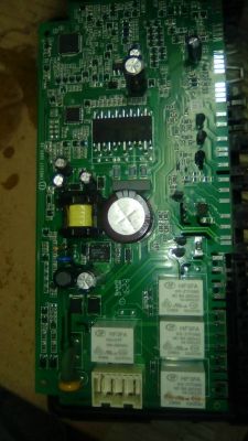

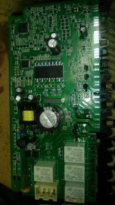

    Hello, I have a problem with the Ariston dishwasher such a model: LFF8M121CXEU does not pour water and displays error F03. The pump is operational, I connected it directly and the intake and exhaust system are clean, and someone will tell you what is wrong?

    As I wrote before, the pump chamber is clean, nothing is blocking it, as well as the exhaust system and the pump is operational. I connected it briefly and it worked when it should turn on. You can hear some ticking as if a contactor is ticking several times and then error f03 pops up.

    Take photos of the module that is at the bottom behind this hinged panel. Only such good quality. To check, the pump power circuit may not connect something in the cube.
  • #8 17144813
  • #9 17152846
    dawinczo1234
