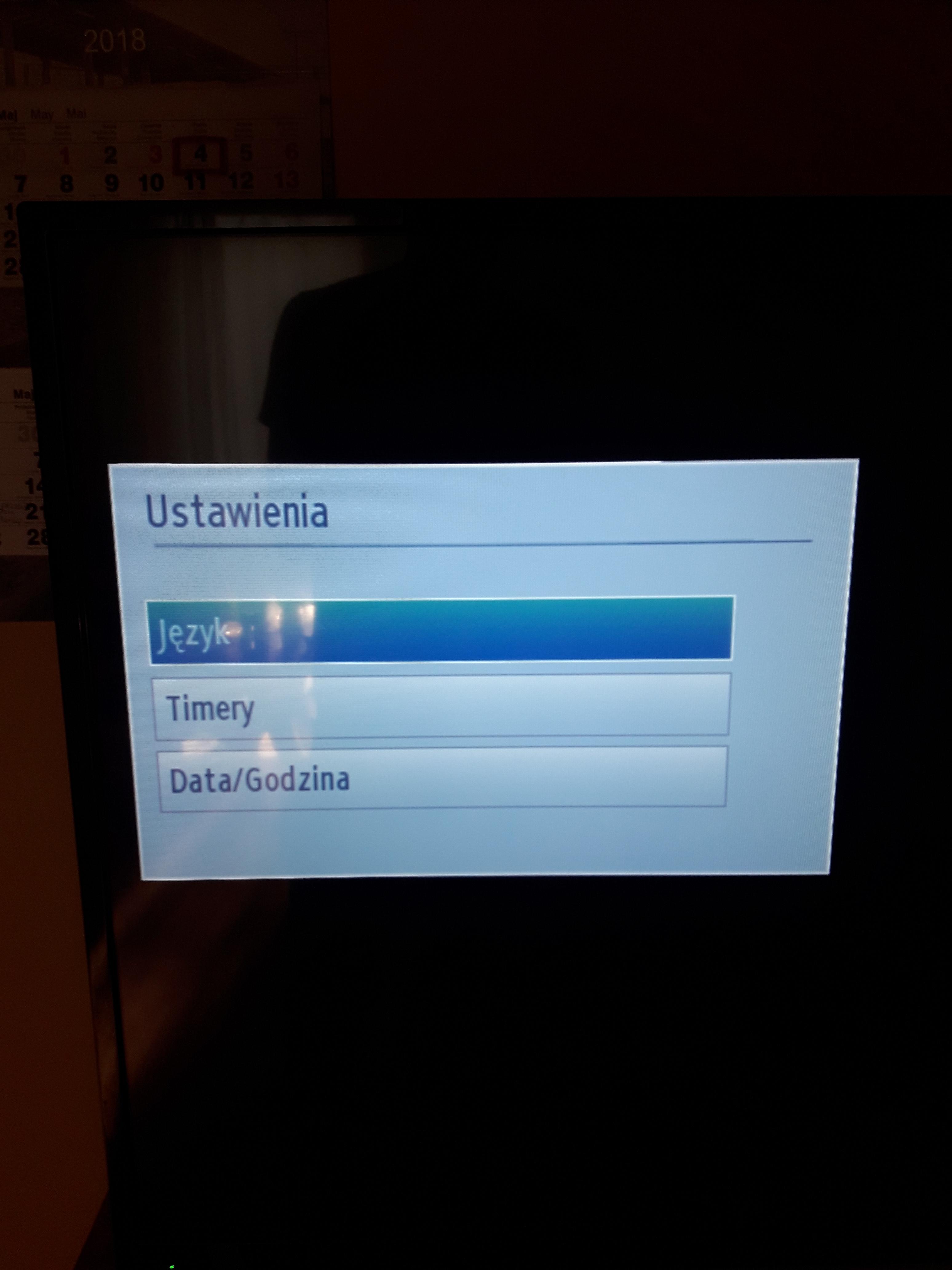

    Hello, I have the same problem.
    Anyone know how to turn off this hotel mode?

    Unfortunately, the menu is very limited, it is possible to set the picture, sound, date and time.

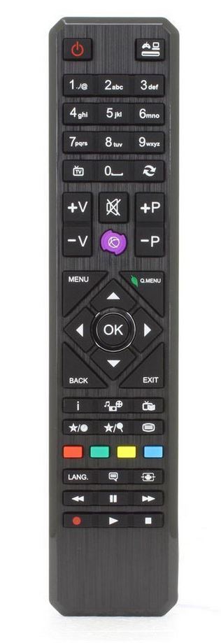

    It is attached to the TV
    - User Guide (Quick Start Guide ;)
    There is no way to navigate through the menu?
    - Remote control: CT- 8073
    Is it like that? There are 2 menu buttons. What is underneath them?

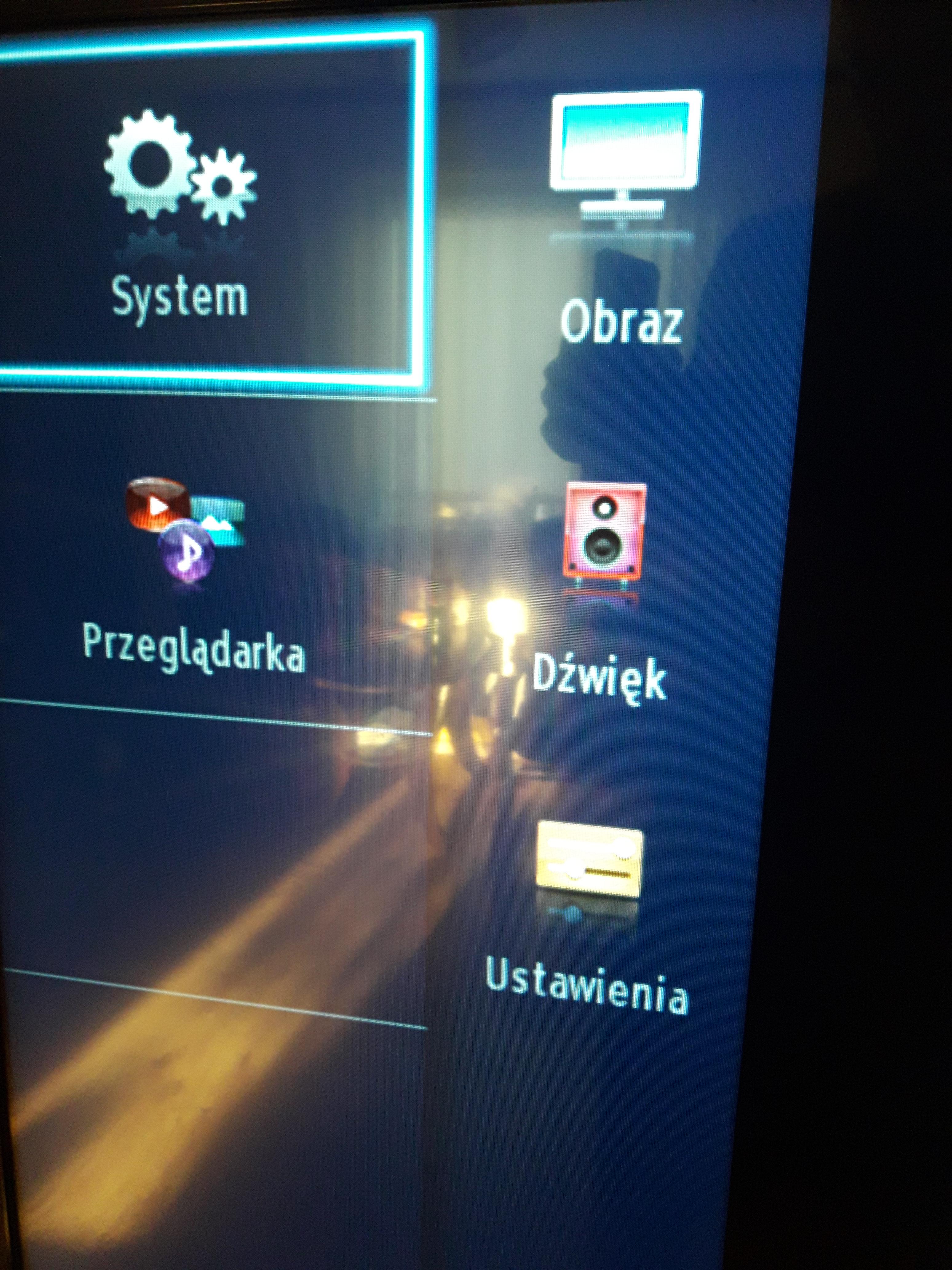

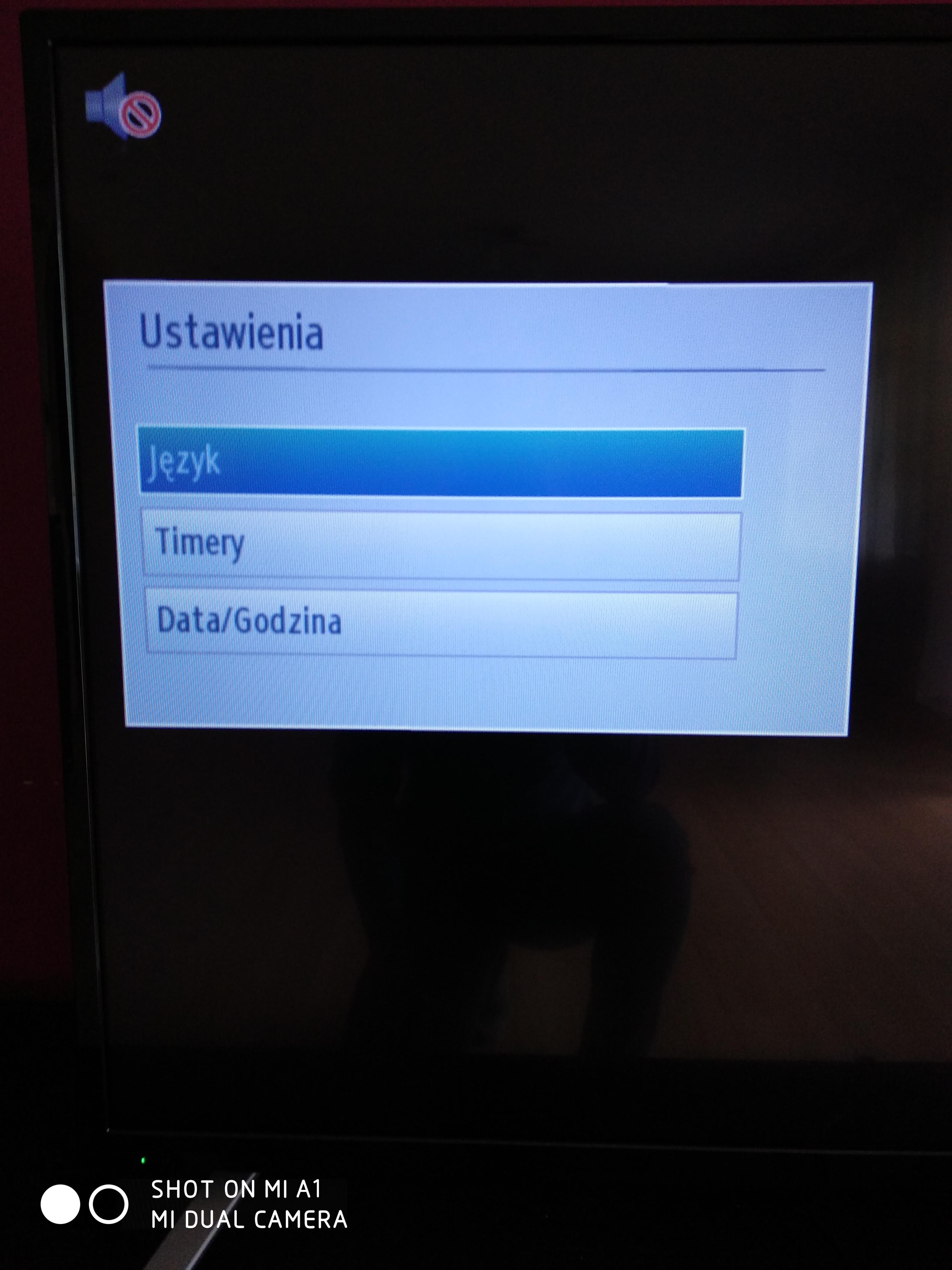

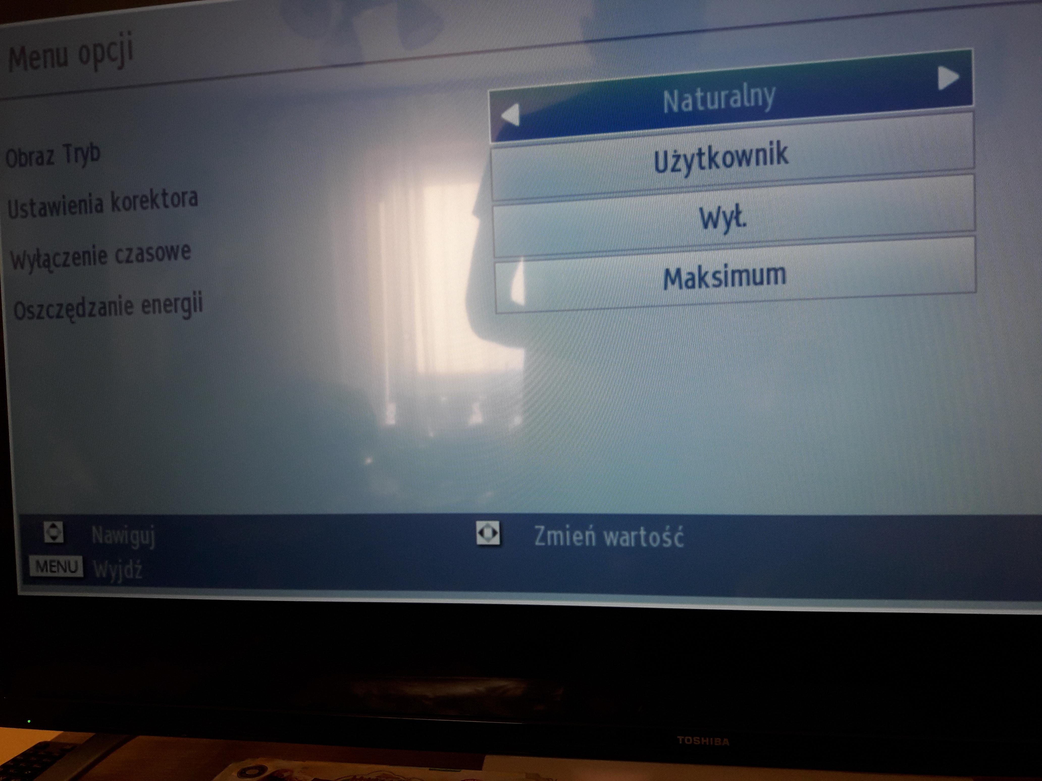

    I attach photos, which turns on when the buttons are pressed.

    Yes, the pilot is like that.

    What is your selected signal source? It should be TV or DTV (button number 31 on the remote control).

    However, everything is available
    you press: menu
    you go to: settings
    -more
    you choose - home mode
  • #15 17280802
    tommy4952
    Rate: 9
    How to go to the settings to the more tab if it is not there?

    The problem is solved, you need to enter the menu, enter the service code and the TV goes to the service menu

    Switch on the TV press the menu and enter 7935 press ok
