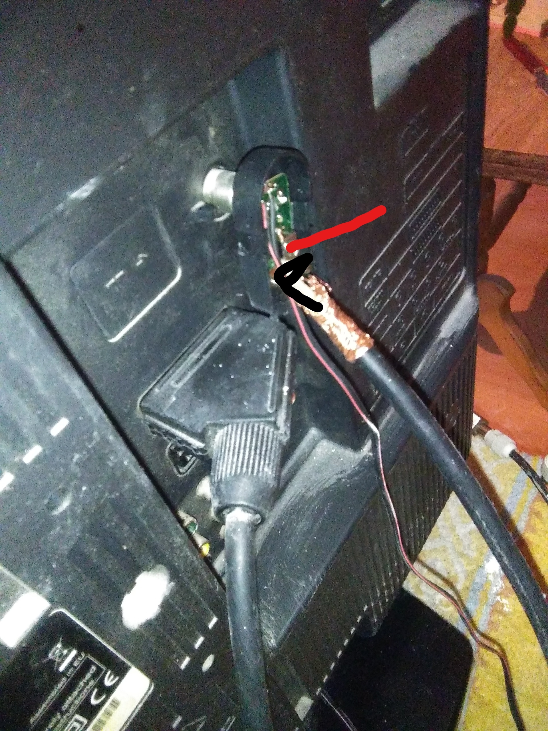

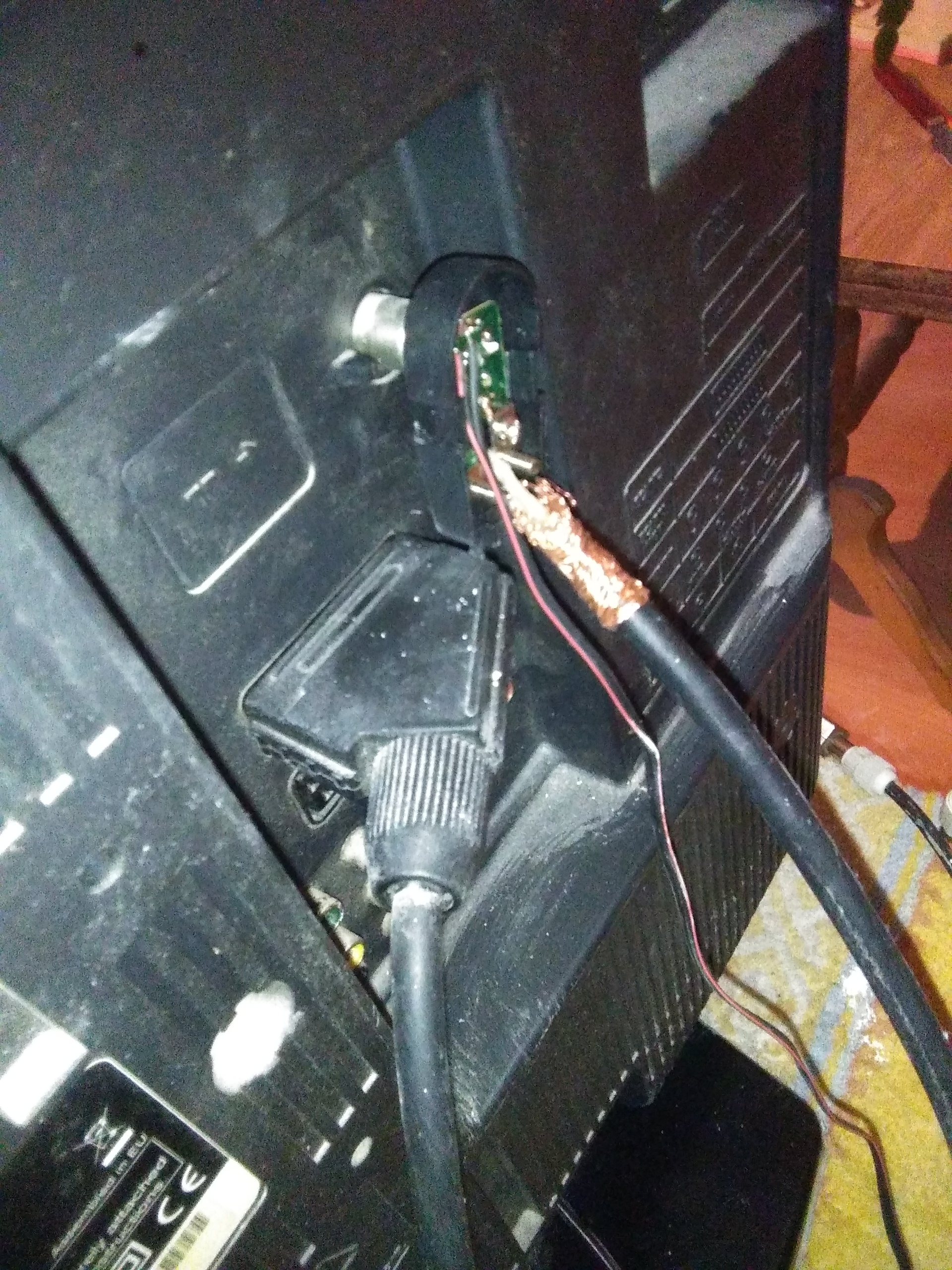

    Hello. Frame the coaxial cable specifically. The antenna has an amplifier the LED in the power supply is on, the direction of the antenna is well adjusted? TV Decoder - No Antenna Signal: Troubleshooting Connection, Antenna Power Supply & HDMI Cables

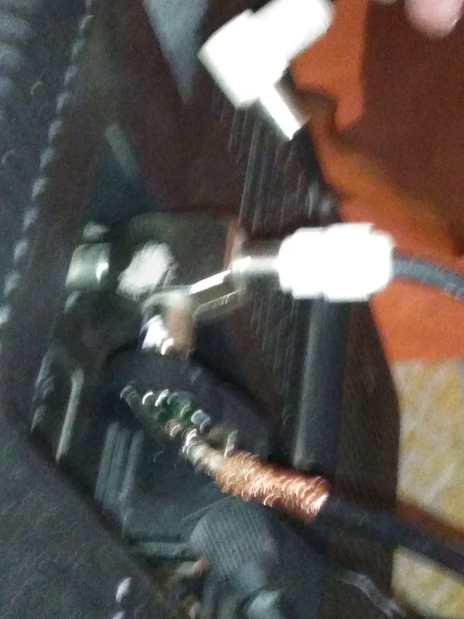

    But the cable is badly framed, there is no weight, you can see in the photo that it is to be corrected. Check the socket on the TV or not damaged?

    First of all, the installation of the antenna cable with the plug from the power supply should be improved, because it begs for problems. The power supply works, the power supply diode is on, the braided cables do not short-circuit to the center conductor?

    Michalek1906 wrote:
    The LED lights up

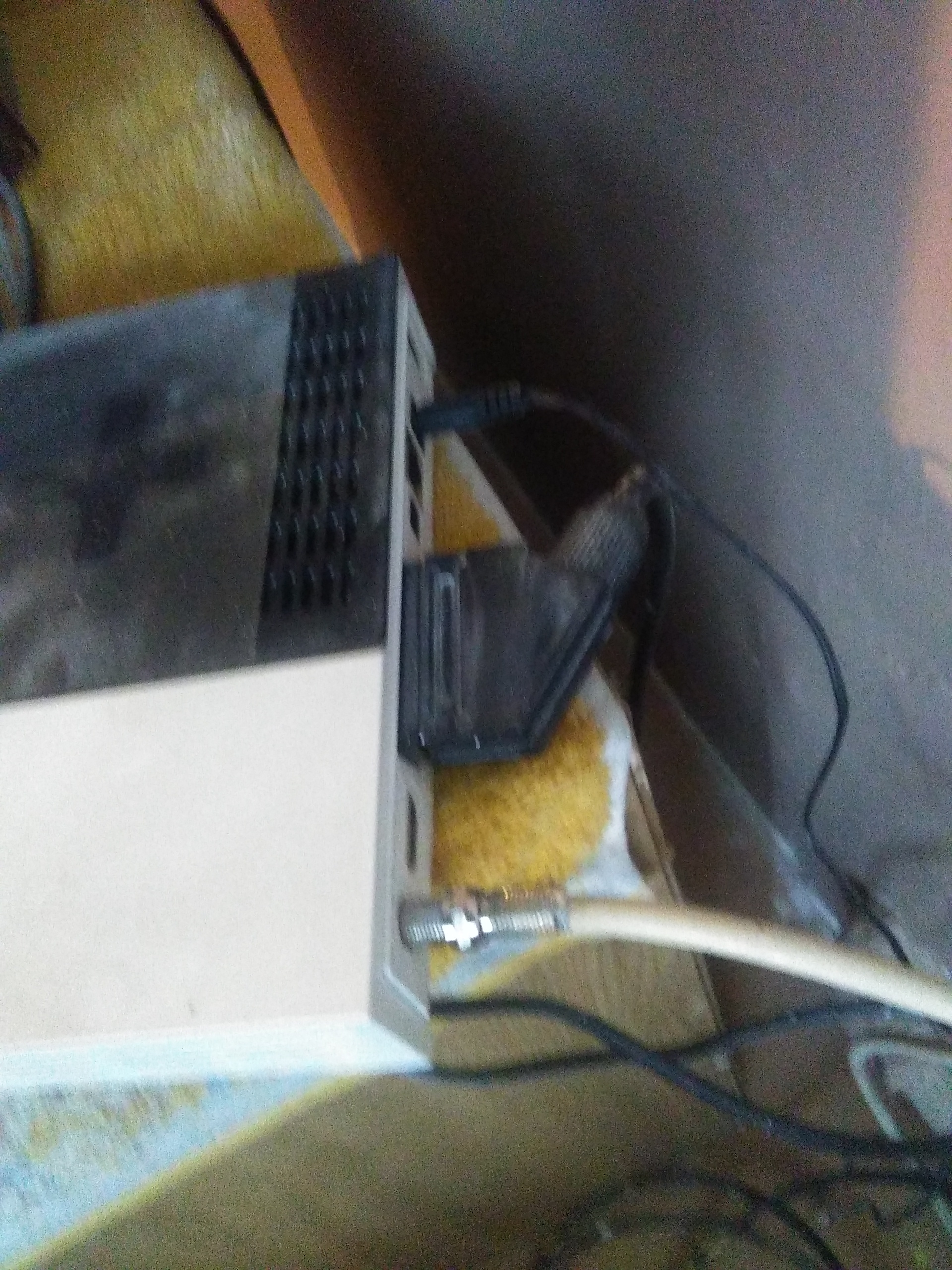

    It just fixes this cable and the signal must be there. And in the TV settings, go to DVB-T digital TV. Because I can see that you still have a SAT decoder connected to the euro.

    As you can see, it also has a SAT decoder. Does it work?
