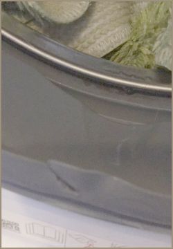

    Hello, I have a leak under the washing machine door. I do not know how, but there was a tear in the apron at the door as in the picture. Does anyone of you know where I will buy such an apron (I can't fix it)?
    How to replace the apron on this model? In the videos, the washing machines have a removable bottom bar, and here is the whole? Where to start? I have some manual skills and before I call a technician I would like to try it myself, which will give me maybe some satisfaction ...

    You need to remove the top cover of the washing machine by unscrewing the two screws on the back of the washing machine, then you need to unscrew the band from the apron inside the washing machine, admission is difficult, but it can be unscrewed.
    Then you need to remove the wire with a spring from the front of the apron and then you can remove the apron.
    The apron can be replaced anyway with a thin screwdriver.
    Take care to put on the apron like the old one.
    For what he has not done so, it will take some time, but the satisfaction that it was invaluable.
