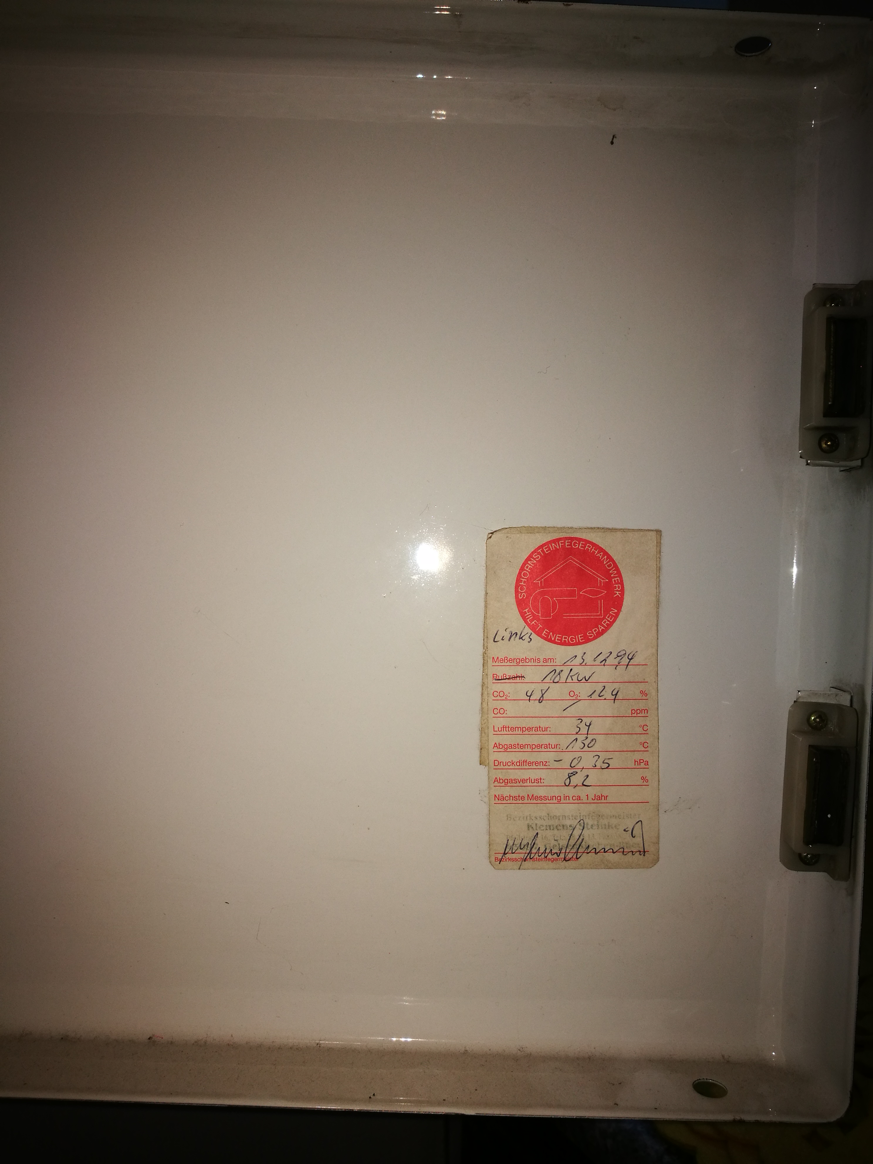

  • #8 17146506
    euterpi2
    Posts: 13
    Rate: 18
    I don't see much information here, what is in the pictures. I do not have documentation.
    • Vaillant Gas Boiler Pressure Issue: Drops to 0 in 2-3 Days, Adding Water & Air - 18yr Old Model IMG_20180403_163504.jpg (2.83 MB) You must be logged in to download this attachment.
    • Vaillant Gas Boiler Pressure Issue: Drops to 0 in 2-3 Days, Adding Water & Air - 18yr Old Model IMG_20180403_163448.jpg (2.82 MB) You must be logged in to download this attachment.

    Symptoms may indicate a cracked / unsealed heat exchanger. Drips do not drip but during boiler operation more escapes and water simply evaporates and escapes with flue gas.
    This is a vintage model, because I look at your photos like a calf on a painted gate ;)
    It looks like this is a 1-function boiler, because I cannot see the water inlet and outlet for hot water
    It can be, as Gasak writes, that the primary exchanger is defective.
    In this case, it is more likely to replace the boiler with a new condensing boiler, because the exchangers are expensive, in addition to such a monument there may be a problem with getting it, and from a demobil I would not risk it.
    The sticker suggests that the last German review was in 1999 and we have 2018, so replacing the boiler with a new one is justified.
    The new boiler means a modification of the connections, a modification of the chimney liner, so these are additional costs that you need to consider.
