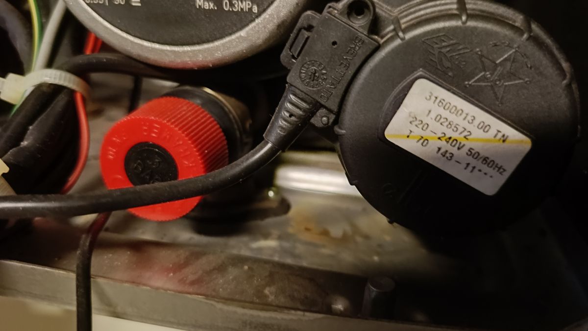

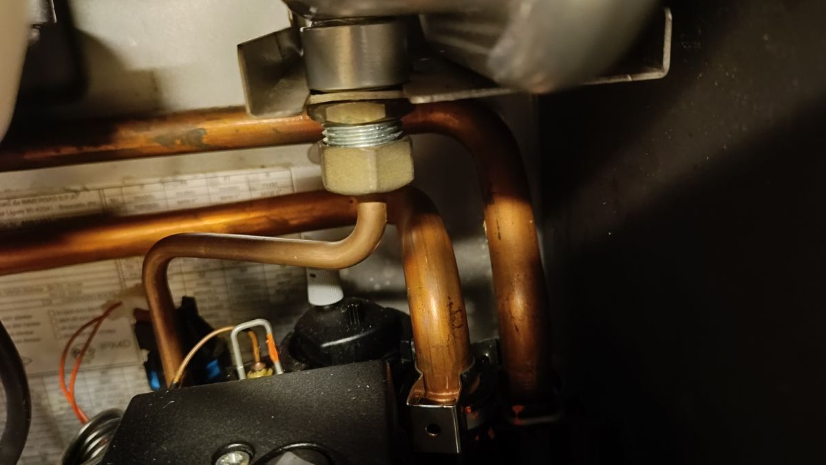

    zeppelin60
    Posts: 148
    Rate: 31
    In total, it lasts 2 weeks after the replacement. I think there were only 2 days when it didn`t have to be refilled in the morning. The pressure in the diaphragm is . Close-up of heating system components with visible electrical and hydraulic elements. Refilling approx. 0.5 l according to the water meter. The safety valve is in the boiler casing and there is no outlet to the outside, but it is dry underneath, the automatic air vent also has no stains/leaks, like new. The heating system for the domestic hot water tank is cut off because I do not use it: the domestic hot water is heated in a separate electric boiler (PV). and there are no traces on the circulation system, some of the pipes (PVC) run in the walls, of course, but there are no stains or dripping from the pipes to the bottom of the risers. Every day I add about 0.5 liters of water and it should flow somewhere. I`m already wondering about the leakage of the primary exchanger, which would then lead to exhaust gases entering the chimney... View of the plumbing inside a boiler with visible copper pipes and fittings.

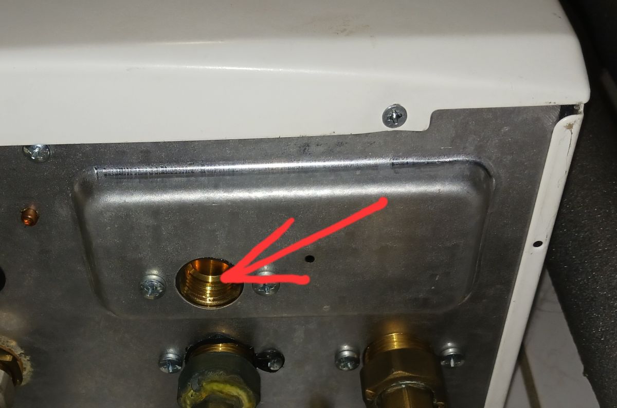

    zeppelin60 wrote:
    The safety valve is located in the boiler casing and there is no outlet to the outside
    There is a drain from the safety valve leading outside. Look from the bottom of the boiler. I marked it with a red arrow in the photo below:
    Safety valve on a boiler with a red arrow indicating the outlet.
