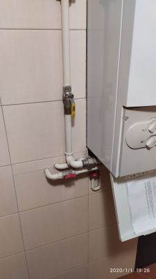

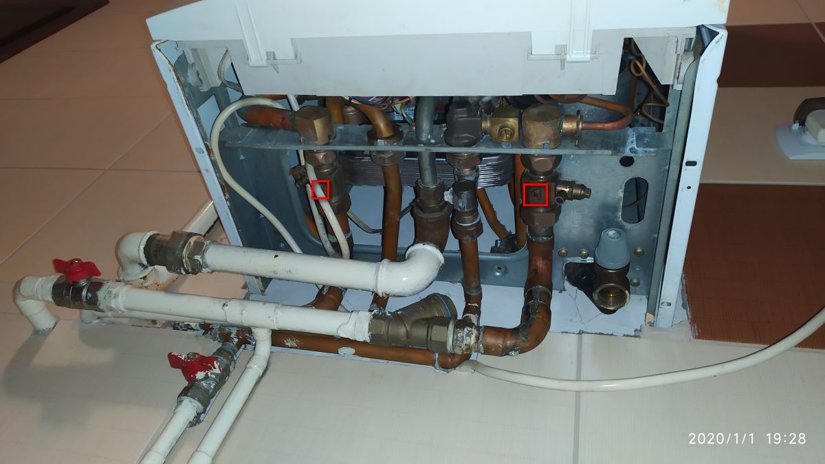

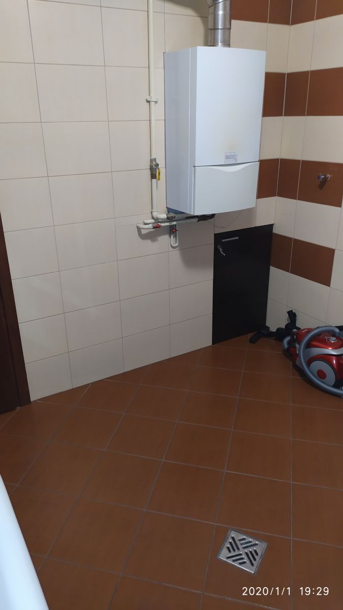

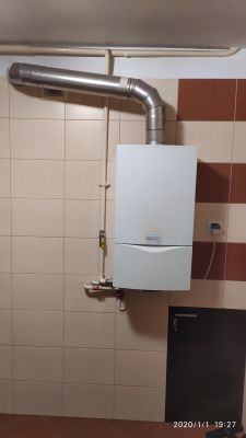

    Maybe I'm sending photos, they'll help! Vaillant Dual-Purpose Gas Furnace: Low Pressure Issues, S54 Code & Expansion Tank Queries Vaillant Dual-Purpose Gas Furnace: Low Pressure Issues, S54 Code & Expansion Tank Queries Vaillant Dual-Purpose Gas Furnace: Low Pressure Issues, S54 Code & Expansion Tank Queries Vaillant Dual-Purpose Gas Furnace: Low Pressure Issues, S54 Code & Expansion Tank Queries Vaillant Dual-Purpose Gas Furnace: Low Pressure Issues, S54 Code & Expansion Tank Queries Vaillant Dual-Purpose Gas Furnace: Low Pressure Issues, S54 Code & Expansion Tank Queries
    I marked in red the places where the boiler can be cut off from the central heating system with a screwdriver, preferably a size 4 hexagon
    The safety valve is on the extreme right position with a gray knob.
    You don't have any hose there, so the safety valve does not run the water out, otherwise it would run out of the valve onto the floor.
    In such a system, as zales.vip wrote, it is best to cut off the boiler from the central heating installation
    Assuming that the valves are 100% efficient, if you cut off the boiler from the central heating system and the pressure continues to drop to zero, you will know that the problem is in the boiler. If the pressure does not drop it indicates that the pressure problem is somewhere on the central heating side

    And, if something can be said, it is best to do it on a cold boiler to minimize the influence of thermal expansion. For example, before going to work in the morning, top up the water pressure and shut off the boiler.
    Only colleagues should tell me if they are valves only 90 * turn or turn until the stop.

    The valves are turned 90 degrees, which is a right angle. The screwdriver can be reinforced with a screwdriver, so the best option is an allen key. You turn it as if you were turning the screw, i.e. clockwise and clockwise. We unscrew the opposite ;-)
    It is easy to remember that the slot for the screwdriver will be along the flow of the water when the valve is open or it will be across like a dam when the valve is closed, so you can visualize it like this to tell straight away whether the valve is open or closed.

    The valves are designed to prevent more than 90 degrees of movement. So twist it until you feel resistance.
    BUCKS is right - preferably with an imbus
    As my colleague Wojtermet25 wrote - preferably on a cooled down boiler. Do not forget to turn off the CO function - otherwise the boiler will overheat.
    Carefully check all flare connections in the installation. Preferably, any place - especially around radiators, thermostatic heads, angular screw connections by radiators, etc. Slowly - use a flashlight to check it, touching it thoroughly with a dry paper towel - it will show the "truth".

How do I isolate the boiler to see if leaks are in pipes or in the unit itself?
Turn the two hex-head CH isolation valves 90° until the slots sit across the flow, as shown in the red-marked photo [Elektroda, BUCKS, post #18374175] Re-pressurise to 1.2 bar and leave the boiler off for a few hours. If pressure still drops, the fault is inside the boiler; if not, search the pipework.
