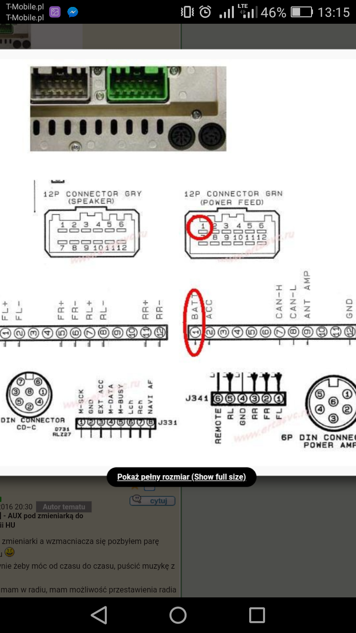

    Hello, the problem is as in the topic. I bought a ready 8pin din to 3.5mm jack cable, but the radio does not see that something has been connected and I can't play my own music. It does not read CDs, neither does cassettes. I tried to make aux for the cassette board but it doesn't work at all. Somewhere on this forum I read that you need to solder the 12v cable from the radio to pin number 8 (picture) to make it work. However, I am afraid to do it without a previous question on the forum because the purchase of a new radio is average for me.
    • Connecting 8-Pin DIN to 3.5mm Jack AUX Cable to Volvo HU-603 Radio: Troubleshooting Tips Screenshot_2018-04-20-13-15-26.png (419.37 KB) You must be logged in to download this attachment.

    Instead of combining it, I would invest in an FM transmitter.

    As long as it's a regular cable and not a mini emulator, it is not enough for you. You need an emulator for this radio.
    there is a chance that you bought something like this http://serwis.tv/?32,adapter-interkietas-do-volvo-wyjscie-aux-wersja-micro
    read
    https://www.elektroda.pl/rtvforum/topic3328498.html
    https://www.elektroda.pl/rtvforum/topic3063445.html#16696877
    you just need an Arduino and a batch to activate AUX you can skip the rest of the project
