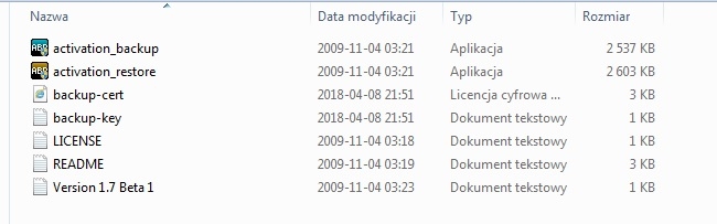

    A few days ago I changed the disk in my laptop to ssd, installed the system again.
    I downloaded the system from the Internet, but I installed the version to which I have the original key, due to the fact that the sticker on the laptop was wiped from the bottom, I pulled out the win product key but after calling the hotline they told me that this key was rather bad and how I pulled it out with this program it said that in windows 7 the key is not hidden anywhere.
    I still have an old disk on which the system is normally activated after relocation, but is it possible to obtain the correct key by removing it from the system?

    Try ABR: Activation Backup & Recovery

    You run "activation_backup" on the old disk, you get:
    Dell XPS 702 SSD Upgrade - Windows 7 Activation: Retrieve Original Key after Disk Change
    that is, as you wrote, "only" key in "txt" and activation information in "backup-cert" file in xrm-ms format.
    On a new disk and a fresh system you run "activation_restore" and hokus-pokus, an activated system with an OEM license.
    This is how "nothing else" looks briefly ...
    The bottom line is that it worked. Best regards!

    Unfortunately, such a file was not created by "backup-cert" but the txt key itself
