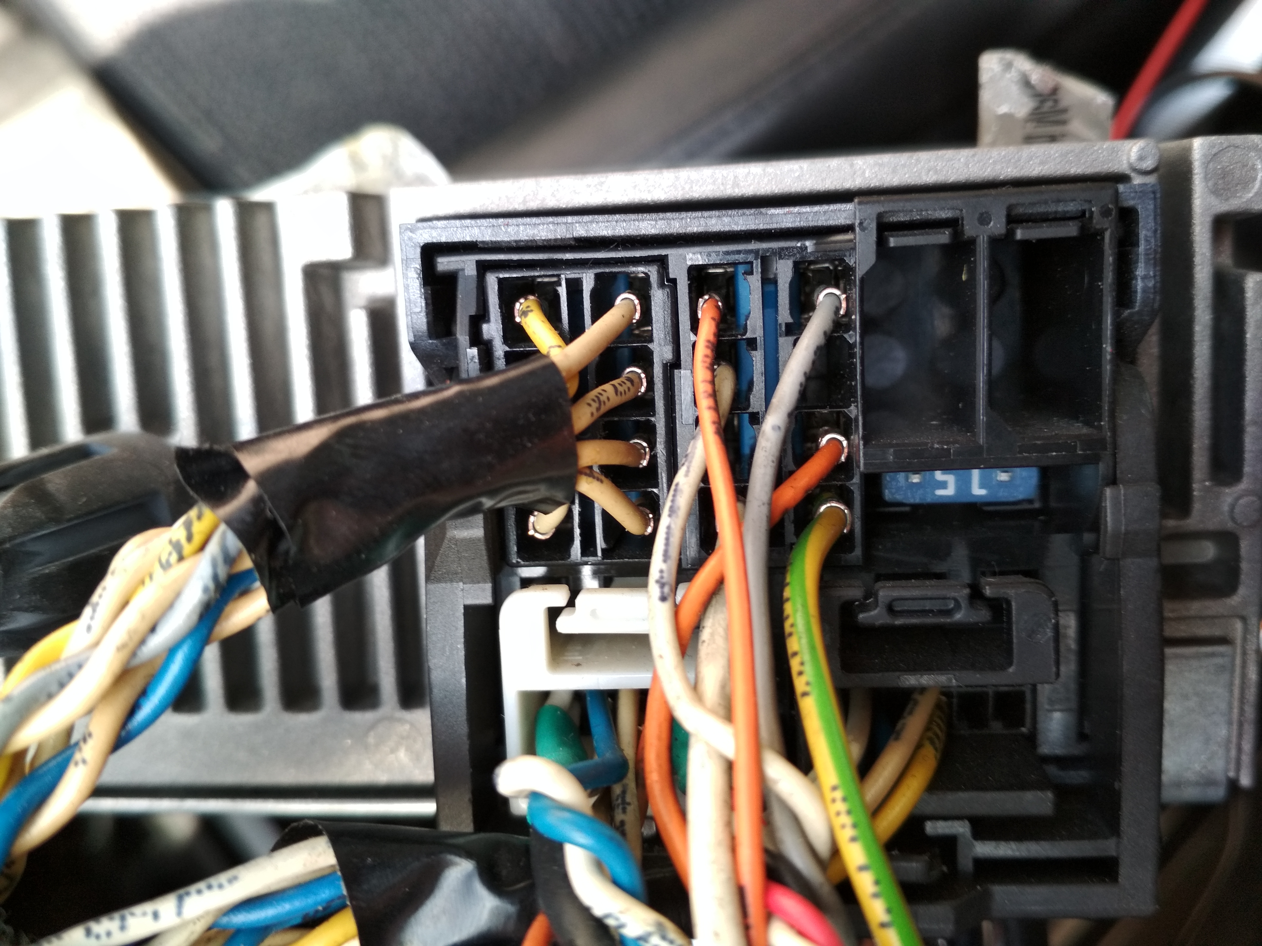

    Hello, the problem is that I connected the reversing camera everything is ok but I can not find a contact on the radio rt3 that after turning the reverse gear the image will be shown automatically. The second problem I noticed is that when I reverse slowly it is ok when I start driving a little faster this cam turns off.

    Write where you got the current for the camera and what kind of radio it is.

    I took the current from the wire that is connected to the reversing bulb, the radio is RT3 short red cable that I connected with the power supply at the back. woke up the video on the radio automatically after throwing back.

    For me, everything is ok, if I switch the radio manually to the video option, it is about what I read, you need to connect this red cable (the one next to cincz) to the radio in a place that will wake up the video after throwing it back, even when I listen to music or use the navigation .

    I don't know much about such schemes if the radio had numbered pins, maybe I would have invented something. I added pictures, so you can help which pin on this radio is responsible for automatically waking up the webcam

    This is a photo cube from RT4, not RT3.

    The radio sticker says RT3

    Not RT3 but RT3eV - this is the first RT4 projection.

    The 407 never had a rear view camera, just like RT3 and RT4 never had such a function. To connect the camera you have to go a little bit around. From the description, it appears that you have an RT4 system and the screen turns off after exceeding 5km / h. You must change this scripting protection first. It will be harder to turn on the camera after throwing back.

    However, this is RT3. I just don't understand why there is no optical fiber in the picture with the connector. RT3 also had a limiter turning off the video after exceeding 5km / h but here you can not turn it off with scripts. You could have the old version of PP200 or hardware. In the film you can see that the camera turns on automatically after throwing back, so I conclude that someone has already changed the installation and in this conversion should look for defects.
