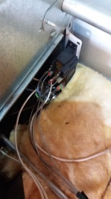

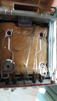

    The two spark igniters stopped giving a spark to the stove. I connected a working magneto to the same socket on the spark generator and it also gave no spark. I'm going to replace the entire generator.
    Sparks 2 and 3 do not produce a spark.
    AMICA Stove Spark Igniters: Troubleshooting and Replacing Spark Generator (Sparks 2 & 3)
    When changing connections 1 2 in the generator, the working magneto does not give a spark.
    I am green in electronics, is the replacement of this generator the only / the right solution ??
    Regards, Janek

    As you write yourself,
    smoleniuch wrote:
    I'm green in electronics
    So there is nothing to look for, and even more so, it is not a repairable part, because it cannot be dismantled. In addition, the cost of PLN 30-50 speaks for not looking for electronics, but to buy a new spark generator.

    I would, however, carefully check the wires and tips of the magneto. In my home stove, I had to clean them more than once from various raids that caused punctures and as a result, the gas did not ignite.

    jaga134 wrote:
    However, I would carefully check the wires and tips of the magneto.
    It is worth doing: move the cable from a functioning burner to the place of a non-working one. If a spark appears, the cause is in the generator, and if not, the tip that gives the spark can be checked (maybe cleaned). Same with the wires.
