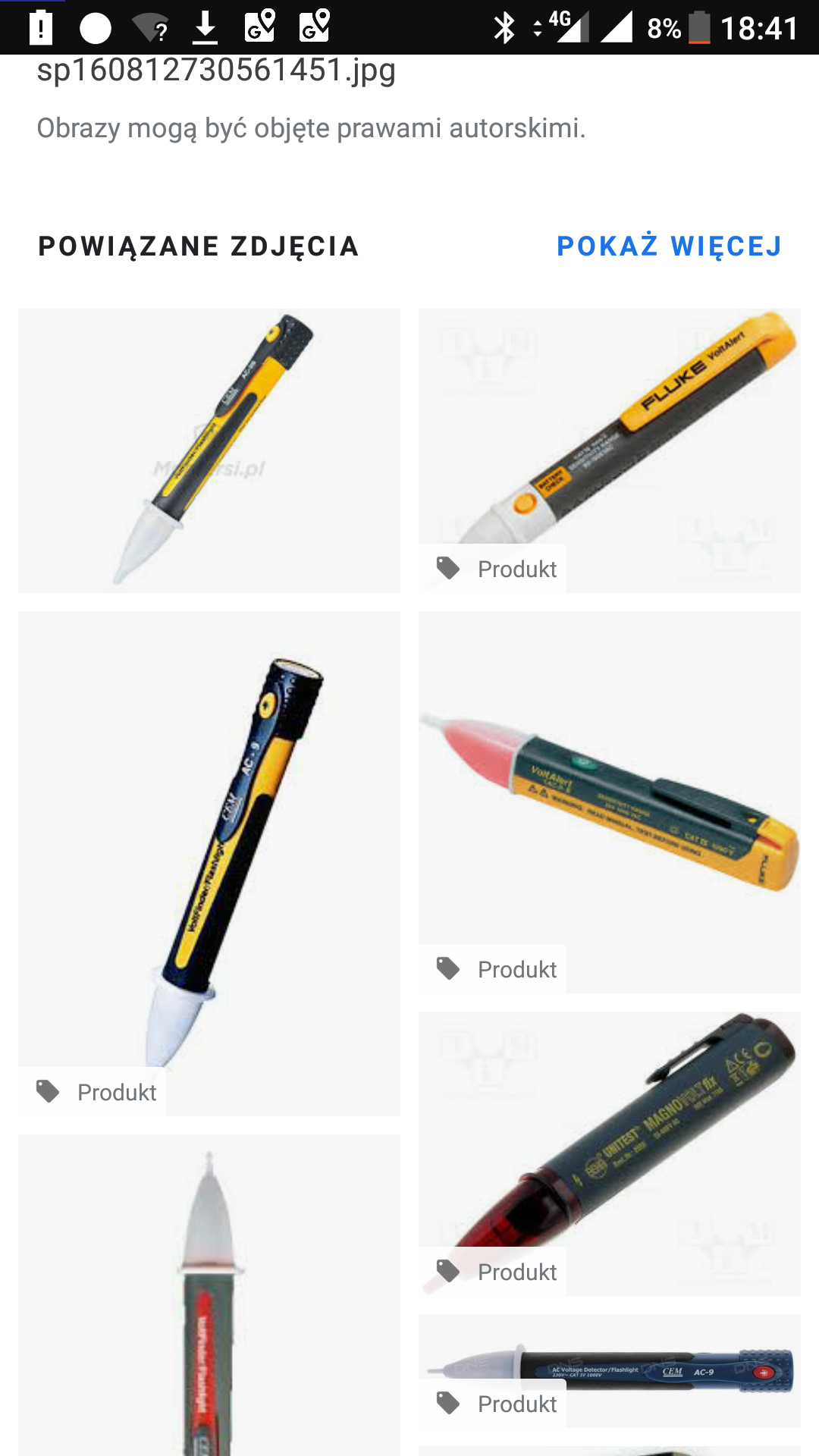

    I would like to check which wire is in phase. How to do it safely so that a short circuit does not occur without any specialized device?
    Of course, there will be no current flowing through the wire, so there will be no field either.

    The voltage indicator is not a specialized device and costs a few zlotys.

    It costs PLN 20-30, the same as the worst-class multimeter.

    Try to use a neon pointer.
    Its cost will not exceed PLN 3.

    The instrument must be there. Is cheap.
