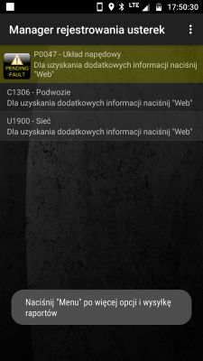

    Hello, I have errors in the Ford C-max 2.0,
    The car runs smoothly, after the errors are cleared, they reappear:
    P0047 and U1900 what is this caused?
  • U1900 CAN fault and P0047 vacuum leak causes

    U1900 - CAN error - often occurs when there are problems on the communication bus, or when reading errors
    any quality interface
    P0047 - turbocharger valve control circuit - there may be a leak in the vacuum bulb control lines, turbo bulb, control valve. This error can also be affected by a leak in the intake system.

    The cable at the plug was torn.
