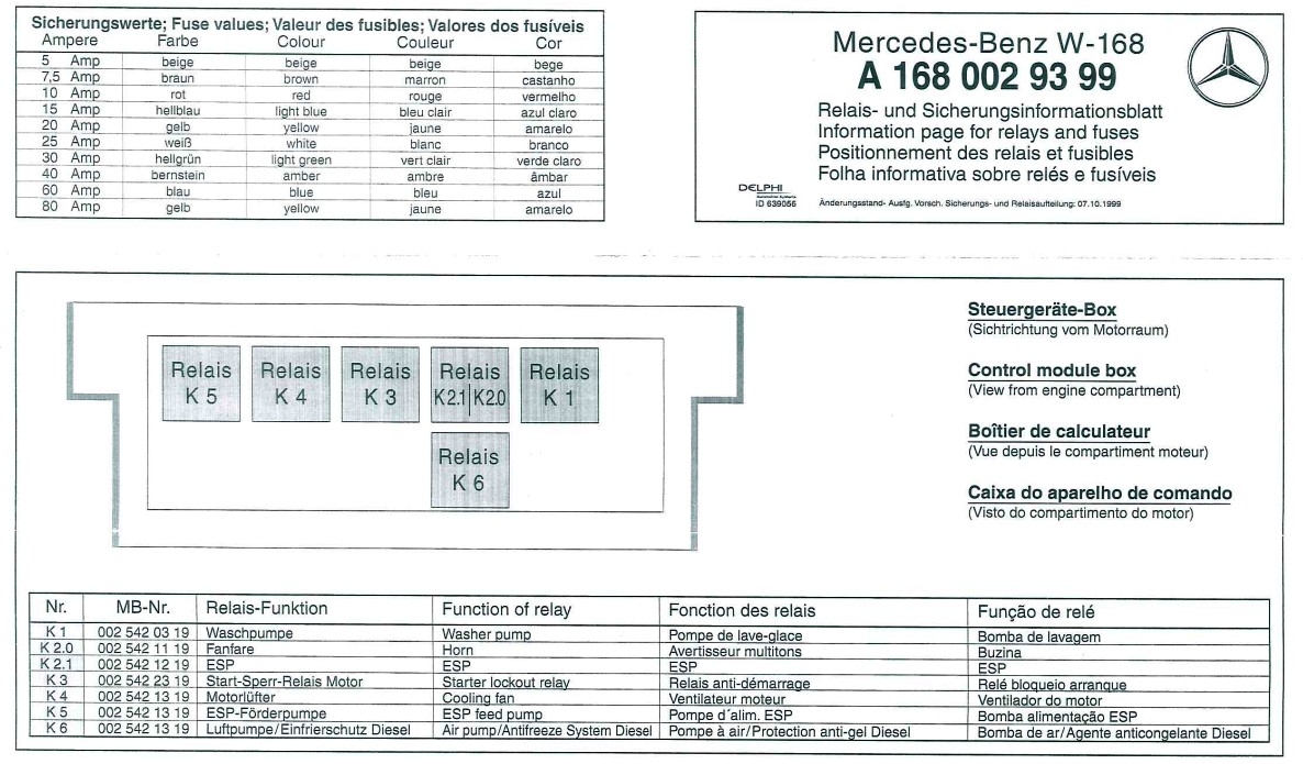

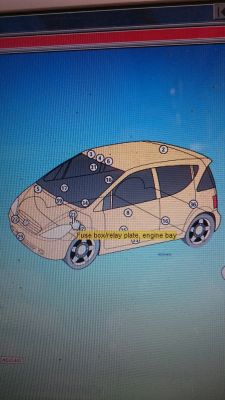

Where is the relay panel, including relay K3, located in a Mercedes A-Class W168 A190 gasoline car?
The relay panel is on the passenger side bulkhead/firewall, in a plastic housing behind the dashboard, not under the passenger’s feet. [#17235365] [#17236181] You can access it from the engine compartment by removing the cover/fixings (three or four Torx screws, depending on the version). [#17236527] In practice, the box with the “AIR CONDITIONING” sticker contains the relays, including K3, which is the starter relay; some relays may sit deeper under foam/sponges, and the exact relay count depends on the car’s equipment level. [#17236955] [#17237182] The numbers printed on the relays may not match the diagram labels, because the diagram numbers are spare-part references, not the markings shown on the relays themselves. [#17238723]

    How am I not mistaken under the floor upholstery on the bulkhead in the area of the passenger's legs.

    Hello. On the right, in the direction of travel, on the bulkhead wall in a plastic housing.
    @ piotrekwoj1 There are fuses and a battery.

    I wrote where else are the relays, especially K3.

    Not underfoot. Remove the mat and look behind the passenger side dashboard on the bulkhead wall.

    Access is available from the motor side by unscrewing 4 torx screws. The box is rather on the engine side, from the inside there is a sheet for M6 nuts under the lining.

    In the engine compartment

    Do you expect K3 to be written on it?

    It's hard, everyone has made efforts and showed you the place, and if you can't see it, we can't help it.
    Added after 14 [minutes]:
    This is not a can of air conditioning, but a sticker on it says about air conditioning. There are relays there, they don't have to be all manned, it depends on the version. There is this K3.

    moddom wrote:
    I also dismantled the air conditioning box housing
    These are the relays you are looking for. K3 is a starter relay and it is in this box.
    moddom wrote:
    panel with 5 relays as in the photo, because the diagram attached to the car's electrical system clearly suggests it.
    Clearly, the diagram suggests 7 relays, not 5, and it is in the full option that does not necessarily equal yours.

    moddom wrote:
    Unfortunately, there are no markings as in the diagram, i.e. 002 542 23 19,
    And it will not, because these are the numbers of spare parts, irrelevant to the user (from the manufacturer's point of view). There is only a drawing with the relays marked and a description of what, this description will not be on the relays.
