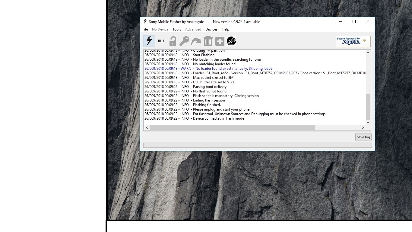

    Hello, I have updated the system to the latest version 8.0. While using the phone, I noticed problems with touch, problems with unlocking, writing etc. I would like to ask how to go back to the previous version?

    Upload the software version you are looking for with Flashtool.

    Ok, I managed to download, but after connecting the phone, it does not upload the software.

    Connect the phone in flashmode.

    I do as it is in the instructions.
    Added after 6 [minutes]:
    I run the program, click on the lightning bolt, select the flashmode, search for the software and when the information about connecting the phone appears, I turn off the phone and connect it to the USB holding the volume down button and I see what is shown in the picture above and only the green LED is on the phone.

    When you set everything up in the program and load the firmware, you click "flash" on the switched off phone, press the "Volume Down Button" and then connect the cable.

    So I do and the window appears just like in the picture.
    I will add that I select everything in the Wipe field

    Nobody's gonna help :-( because the system still not installed

    Then leave it to the service.
