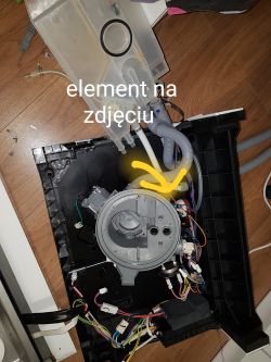

    Hello. I have a problem with the Amica 629e dishwasher pops up error 4 water overflow. The dishwasher washes and after some time she caught an error when she was pumping water. After the dishwasher was unscrewed and moved, the mistake disappears. You can attach a new program, sometimes washed to the end and sometimes again catch an error. After unscrewing the side case, no leaks are visible, the outflow is unobstructed.

    The activation of the aqua stop is usually caused by the appearance of water on the floor plate of the device. You do not need a lot to activate the system. Out of nowhere water will not take, you have to take off what you can from the sheets and look for what reason the water appears under the styrofoam aqua alloy. This movement of the device spills water over the base and the float switch disconnects.

    For posterity
    In the picture you can see a certain element which is held on 2 screws plus 1 hook in the middle.
    In my opinion, this is not refined because under the influence of vibration, the screws hold the upper part of the pump unless the latch just released and the gasket which there is a small amount of water
    I've put it on a small amount of silicon and it's been running for 3 months
