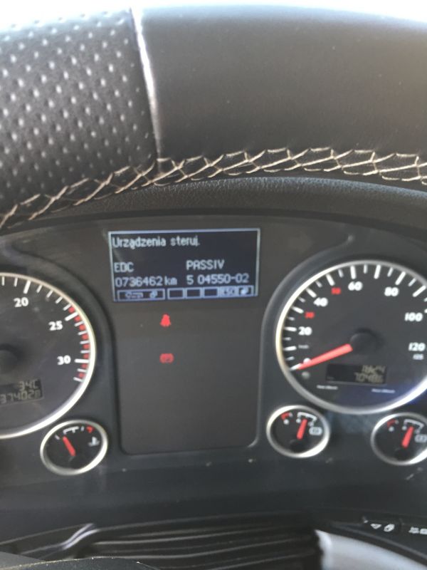

    Hello, I am asking for help in decoding the error code from the board in chapter EDC 5 04550.
    Autocom interface sees an error but no description.
    The car drives normally, does not go into emergency mode, but the engine check is lit.

    There is something wrong with this error, it applies to a few chips but not EDC. Maybe I have too little literature or you read it incorrectly.

    The error is correct. He clears it but keeps coming back. MAN TGX 480 Euro 6: Decoding EDC 5 04550 Error Code & Engine Check Light Issue

    EDC 4550 "Oil level too low", check oil level :)

    Thank you, I confirm the error. After adding and removing it, it does not come back.
