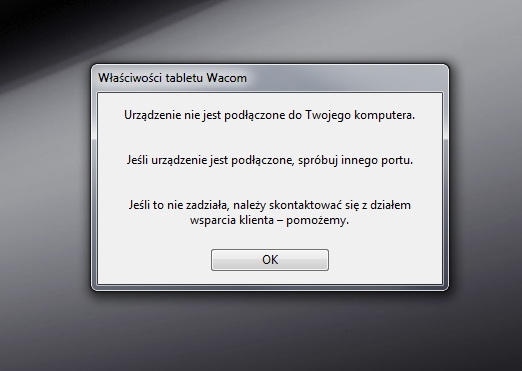

    Hello, I have a problem, I bought a Wacom graphics tablet exactly Intuos Pen S version 2018 and after installing the latest driver from their site and after restarting the computer the driver does not detect the device. Changing the connection of the usb port to another port did nothing, and even the installation of an older version of the driver. Without installed driver, it detects the device as unknown, and after installation displays a message that the device is not connected. I heard that wacom with drivers is not the best, but I want to find out your opinion and solve the problem, because I do not hide that I care about time. Thanks in advance :wink:

    Send the current drivers in the attachment.
    What windows operating system are you installing these drivers on?
    What USB socket do you connect a USB 2.0 or USB 3.0 tablet to?
    Sometimes, after installing drivers, restarting the computer is required.
    Another option is installing drivers without a digital signature .

    The driver version is 6.3.30-2 (the latest) for Windows 7, for USB 2.0 (from the front of the unit).
    I restarted the computer according to message that was displayed after installing the driver.
    Is it possible to install drivers without a digital signature on Win 7? I don't know exactly about this option.
    • The driver for the Wacom Intuos S 2018 graphics tablet does not want to work 222.jpg (722.96 KB) You must be logged in to download this attachment.

    The update had to be installed in the Windows update service, after which the previously installed driver after connecting the tablet normally started and registered the device.
